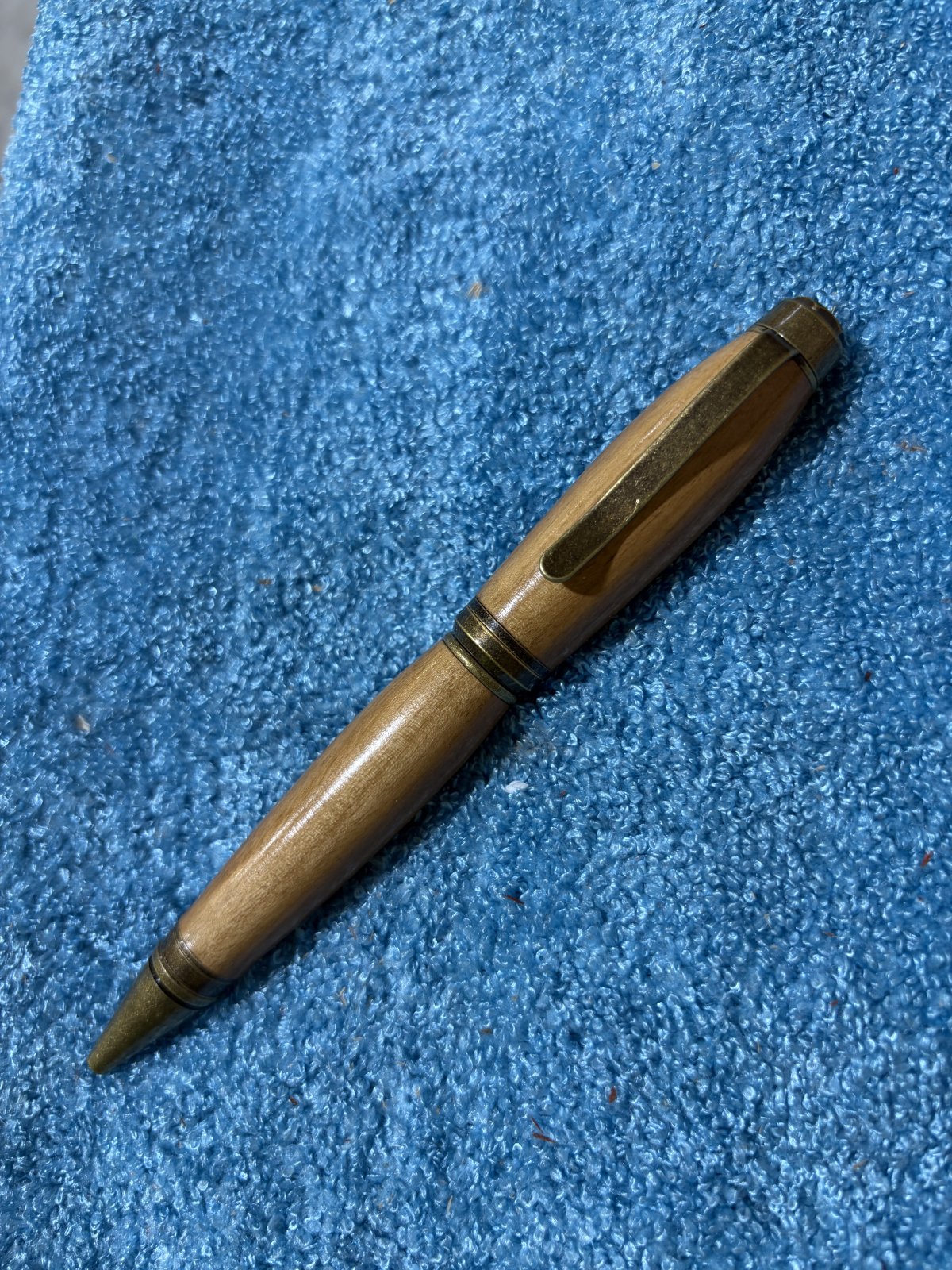

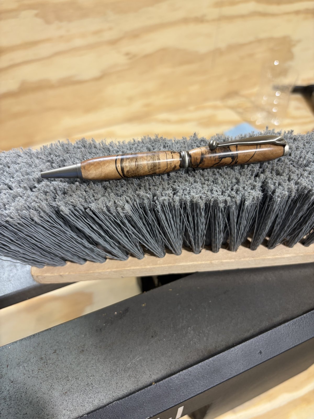

Like I said, we are just getting started. But here is our pens. I tried to take my time with the Hickory/click pen and CA. Everything you stated about grit sequences shows the scratches on my finish. The walnut and african blackwood are friction polish. This thread helps a ton.
First thing is to not apply CA too thickly. Light coats and let each coat dry completely. I apply at around 250 rpm (that is as slow as my lathe will go ) and I leave the lathe running while the CA is drying.
I tend to apply 6 to 7 coats of thin and then 3 to 4 coats of medium.

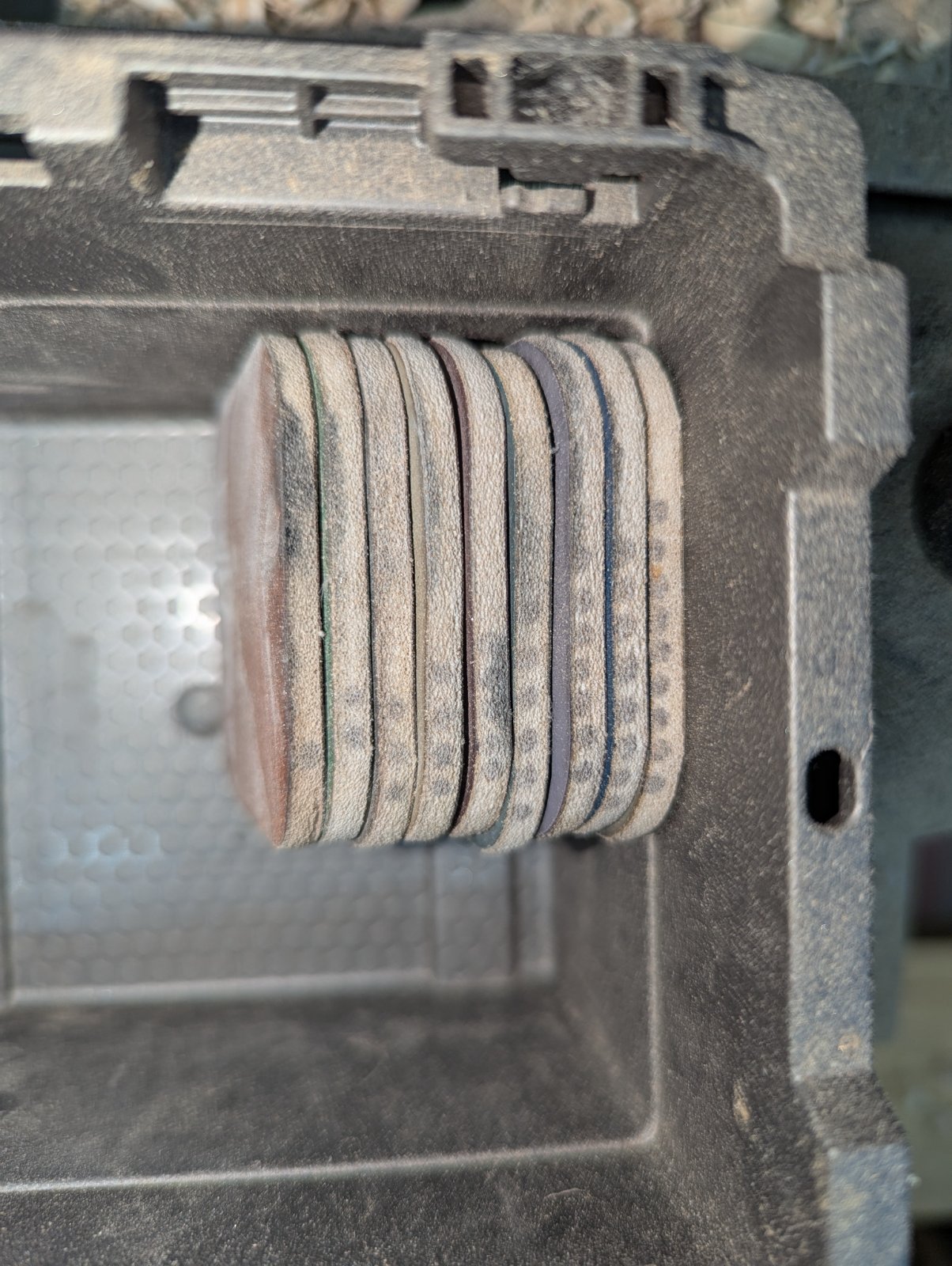

I use these micro mesh pads.
One other thing. If you sand the corners of the blank so they have a very slight radius/break to the edge it will improve the look of the finished pen and when someone picks the pen up and holds it they will not be able to easily discern the difference between the where the blank ends and hardware begins
One other thing, I have my micro mesh pads 'numbered' so I keep them in order. I have them in a smallish container and when I'm done each grit I return to the opposite side of the container and then I know which one is next and which one(s) I've used.
