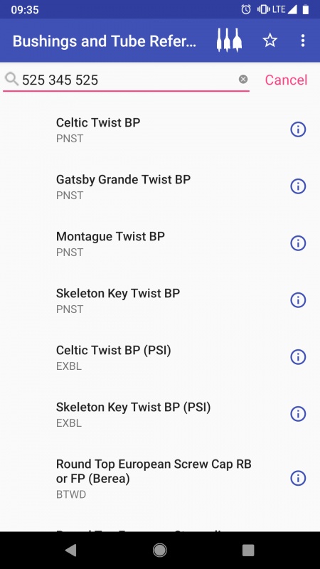

If you have the app there is a way but it isn't perfect. If you enter all the bushing diameters that are listed for a pen in the search function it will return a list of all the pens with those numbers listed.

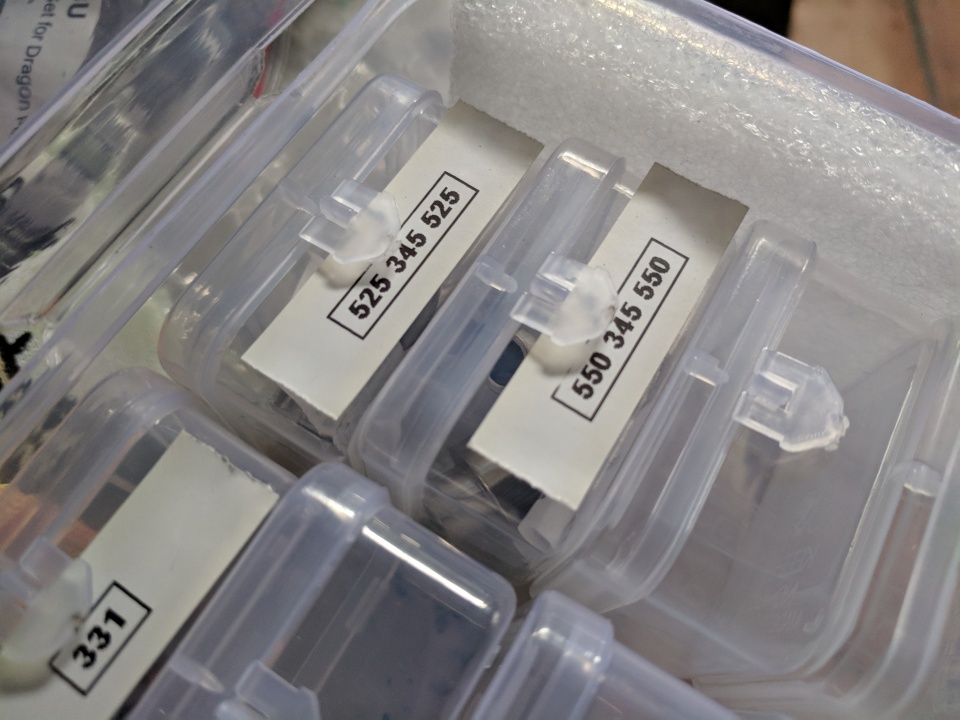

Because of this awesome property of the app JimB pointed out, I organize my bushings based on diameter (in the tiny Harbor Freight boxes). This way I can input the numbers and see exactly which kits take those bushings; no multiple names to keep track of. Additionally, since I measure my diameters with calipers at the end anyway, I can easily use bushings that are "close enough" without having to buy a new set sometimes. I TBC so bushings are mainly for supporting the pen tube and visual approximations. This way helps me a great deal with the cross-referencing problem. :)

Simpler yet, just tap on the bushing header text ("Upper/Cap Bushing" or "Lowe/Body Bushing")
The app will automatically flip you back to the search screen with those bushing diameters in the search field and a list of all kits that use that bushing.
