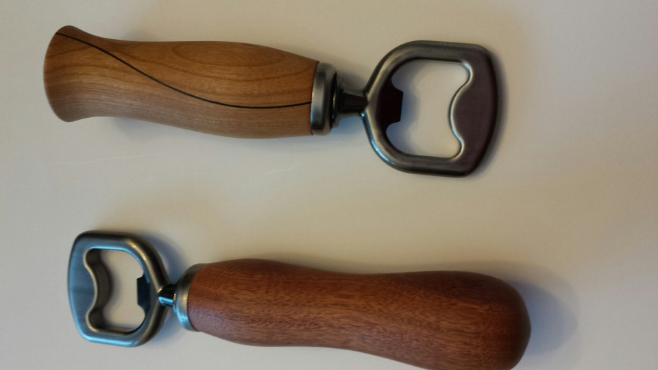

I buy my openers from Rockler. A little more expensive than some of the others but I like the look and feel of them. They are 1" in diameter at the opener end...
