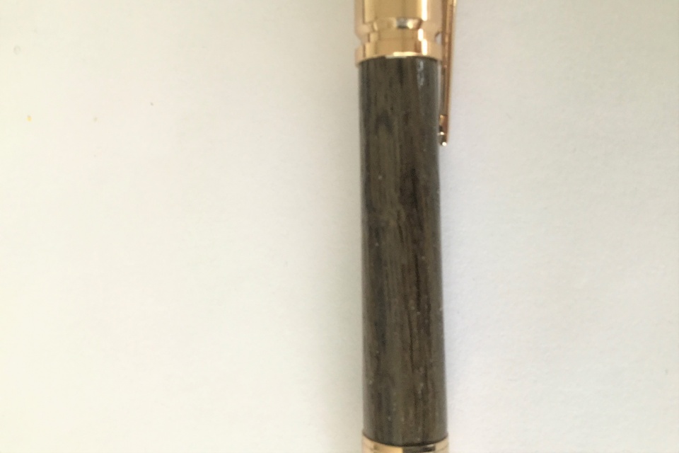

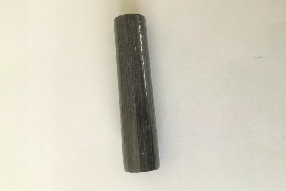

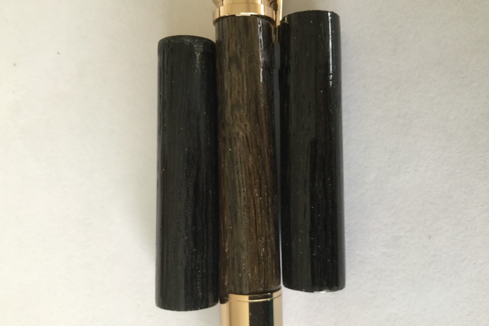

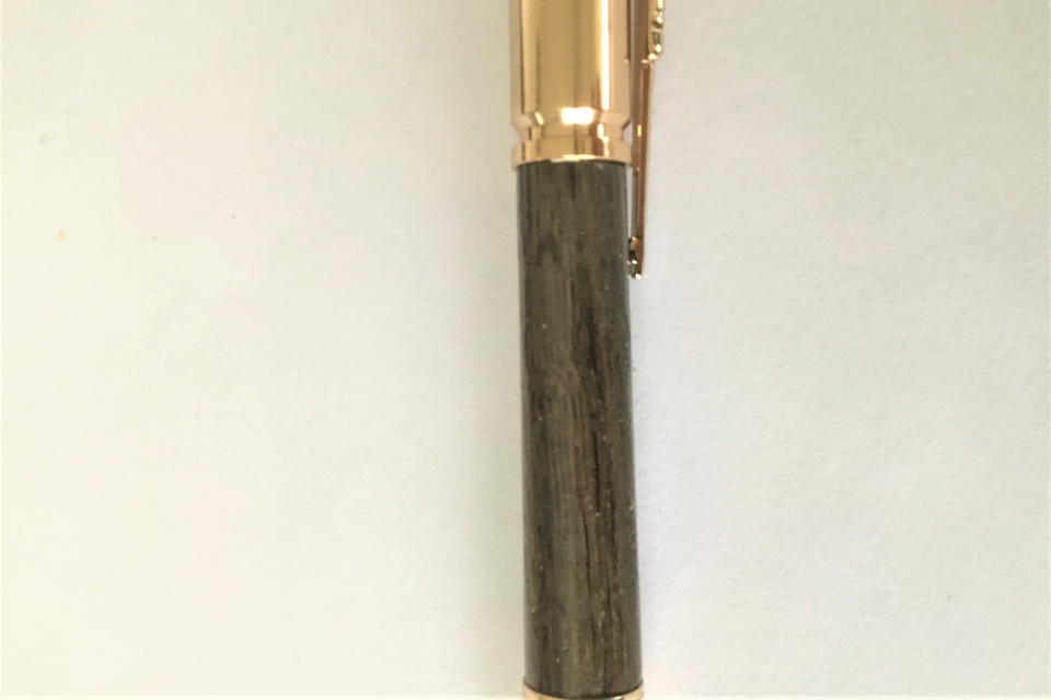

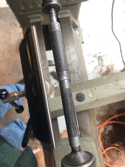

So I started turning my first Irish bog oak and I am seeing these white steaks in the dark sections. Has anyone else encountered this? IMG_2706.jpg
https://m.facebook.com/?_rdr#!/rvatyndall/
Looks like sanding dust to me, specifically CA sanding dust.
Blow it out with air; wipe it off with denatured alcohol, but that can produce its own problems.
The blank looks a little rough. Is that your applied CA as a finish? If so, there may be several recommendations for others and they may work for you. However, my recommendation is to build up the CA and then with a scraper, very sharp, (Or carbide insert tool) and with the lathe running 2000 - 3000 rpm, touch the scraper to the CA and smooth it out. This saves lots of sanding. Several do this with a skew.
I haven't had that in 10 years or more because it is as much fine tuned technique acquired from experience.
On heavy grained wood, the sealing is not done very well and as a result the grains have little holes/veins for sanding dust to gather in. You want to get rid of those by sealing them well. Medium or Thick CA will do that. Then CA the whole thing.
With that many coats you likely have CA dust under the CA or between layers. Makes it tough to get out.
From personal experience you may need to take it back down to the wood, clean it up, then check if there is any CA dust in the grain and still under CA. Either sand, clean and work it out or see if you can stain/color it this go around and do better next time.
I'm with Hank, but it isn't clear to me whether you have done any sanding of the blank prior to this point. If not, then I assume that it can't be CA sanding dust. Is it possible that it is small pieces of applicator? I have noticed that open grained woods have a tendency to "grab" my applicator (paper towel, or foam). I try to use a light touch with my applicator, and don't work too long. Paper towels really reduce working time compared to foam or plastic/wax paper.
Another possibility is rapid curing of CA. If small "pools" of CA cure too fast it will bubble and turn white. Based on the pics I don't think this is the issue, but figured I'd throw it out there. I have had this issue when filling voids, but not with finishing a smooth blank.
No matter what is causing the spots, I don't think it is a normal feature of bog oak.

I have the same problems with bog oak and agree that because of all the fissures then sanding dust is the problem. I don't use CA as a finish and clean with DNA after each sanding and still have the problem. I will try Danny's solution of blowing out with compressed air as well ( another purchase )
Thanks for the advice. Yes, this piece is from Twvaman. The lower piece of oak broke on the lathe and I had to glue it back together and only shaped it down by sanding it with 120 grit because the chisels were catching the groves in the wood and tearing the blank.

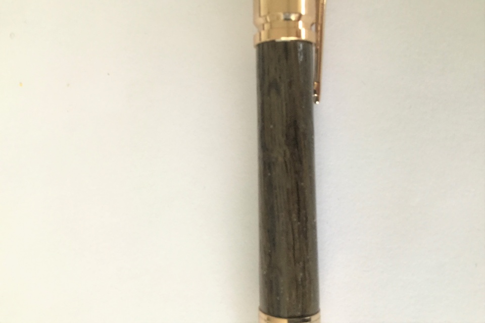

This photo was taken after sanding from 120 up through the grits to 600. I used my air compressor to blow off the blank at each step and then used DNA to wipe down the blank before moving up grits.
I then added 6 coats of thin CA and MM it down. I then added 3 more coats of CA. This is when the photo was taken.
I use a paper towel to apply the CA.

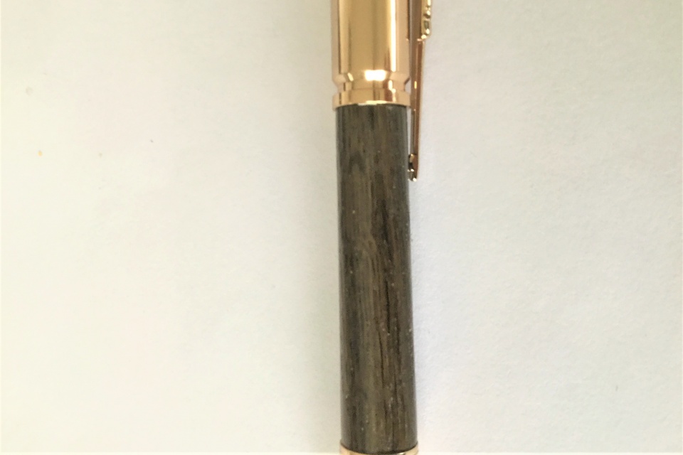

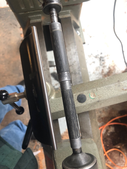

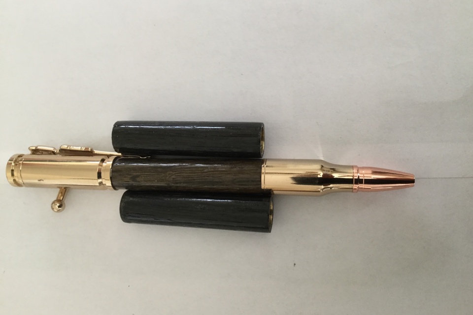

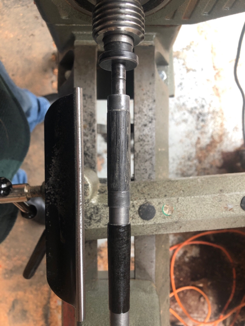

Took it down some with the skew. I think the white filler was a mix of the paper towel and CA dust. I did a number trying to finish this one.

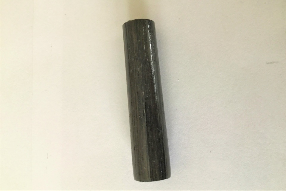

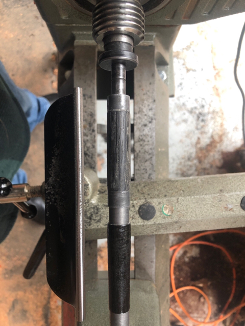

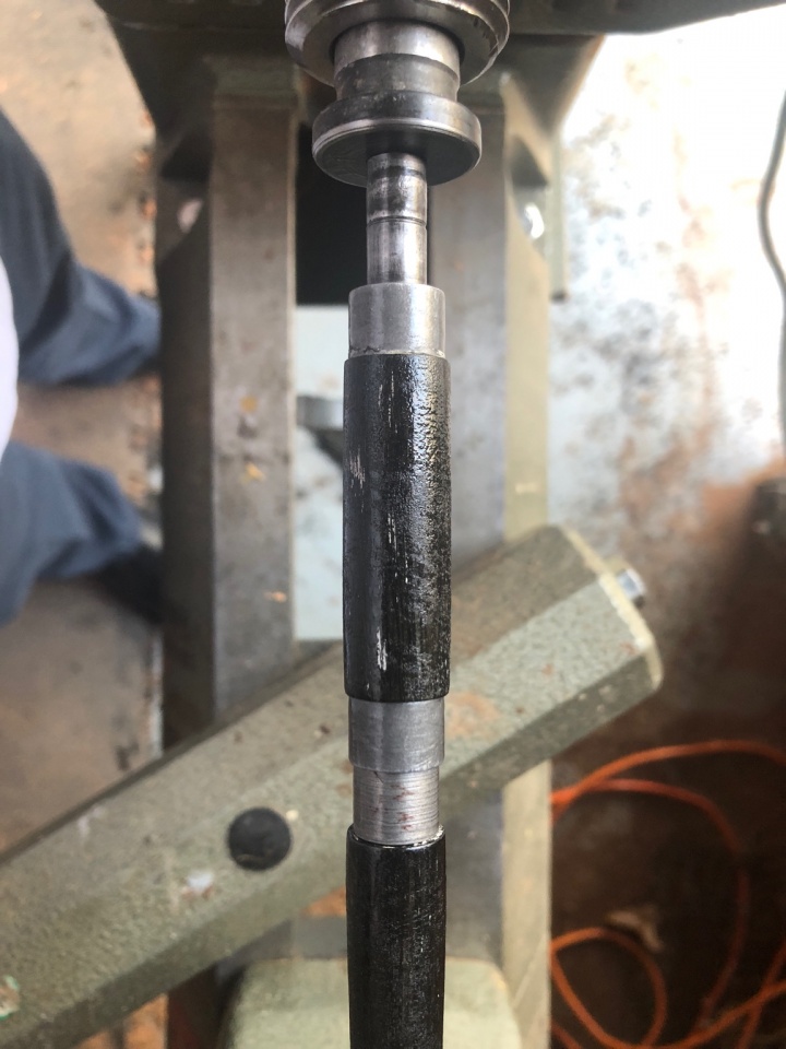

Here are some shots of me working it down.

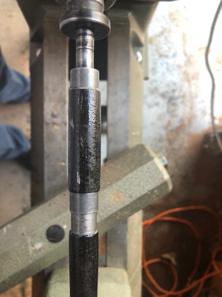

For the finish this time I am working with Abranet sandpaper from 180 - 600 sanding only with the grain. I wore plastic gloves too and applied DNA at each grit with my hands to remove dust and any fibers. I started using an old rag and the cotton was getting caught in the blank.
That looks much better and more like what I got at that stage. Yours might still have a little dust on it.
Try scratching it a little (not too much) with a toothbrush or, better still, a brush with brass bristles. . I do that on roughish surfaces to remove bits of dust that are stuck in crevices or pits. . It does mark the surface a little bit, but the surface already has crevices. . I have found that CA conceals any marks left by the brass-bristled brush.
This particular bog oak is not jet black ... just a little bit grayish, so some tendency to that coloration in places is normal.

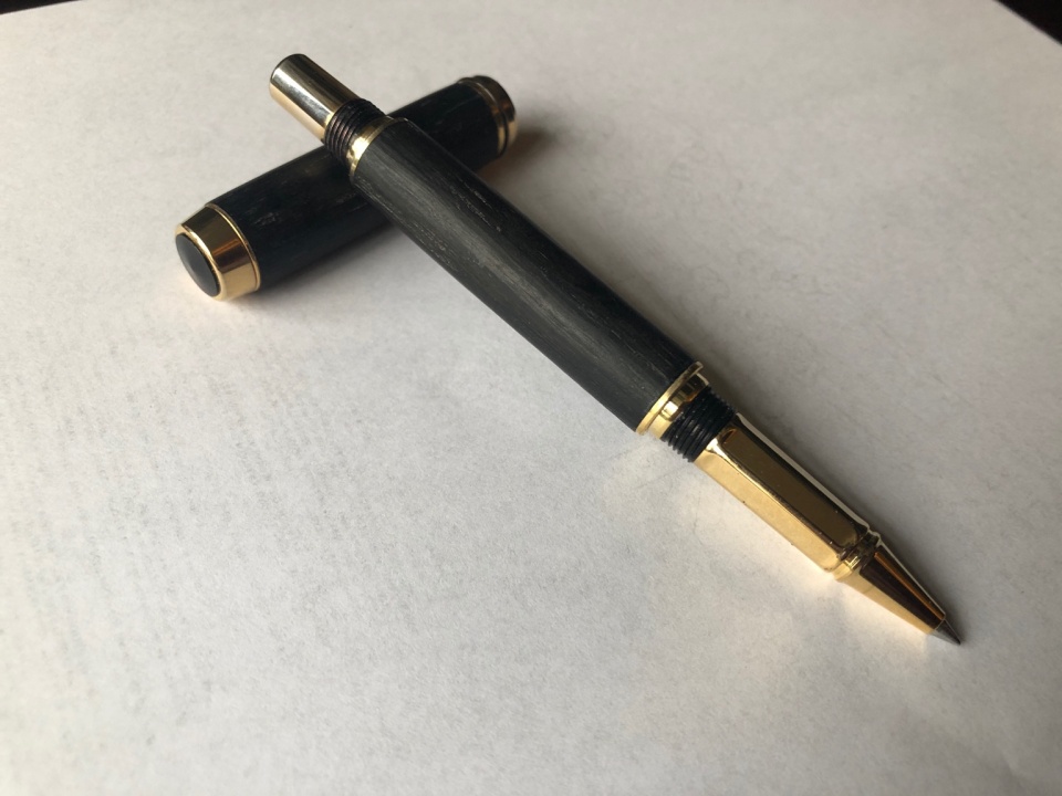

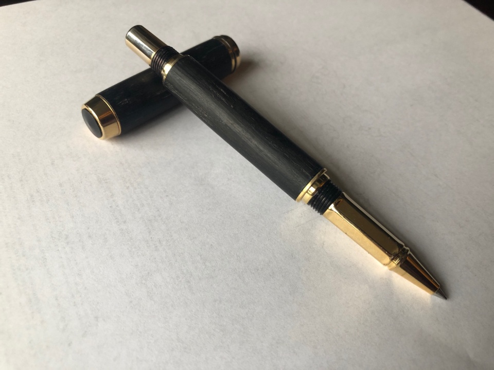

I would show my pen, but I can't find it !!
Thanks for the continuing information.

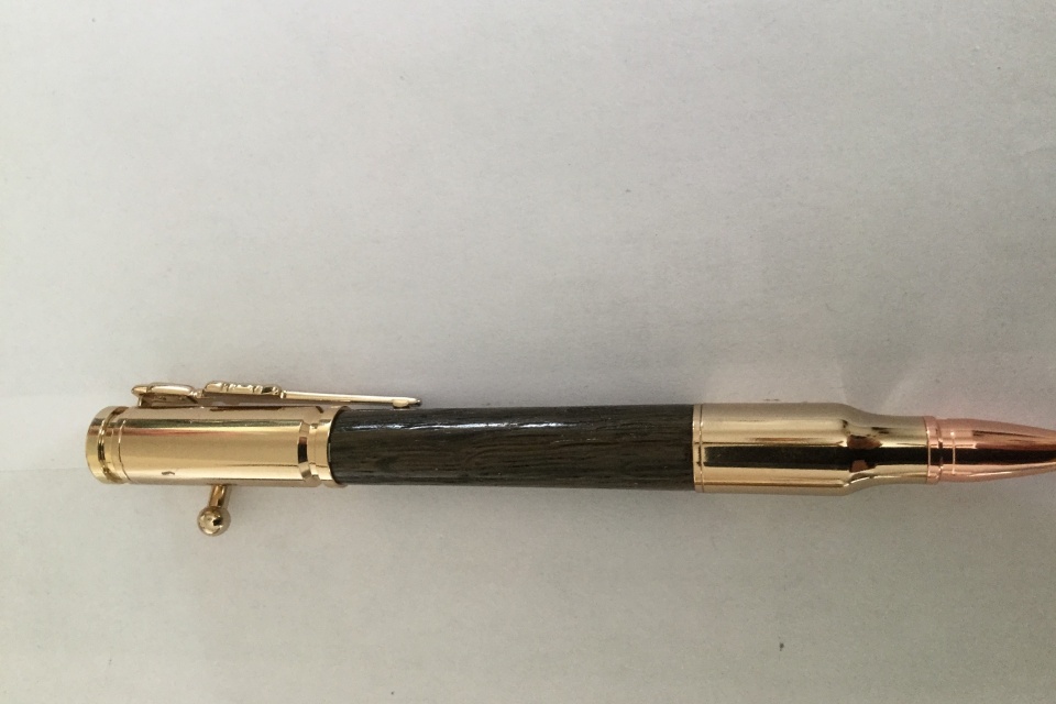

Good idea on the brush. I didn't think of that. I was so happy that my kit and blank were not ruined that I goofed up the finishing process...
I ended putting on 3 coats of CA and the put it under the buffer. I even forgot to polish it.
Good news is that I have another one in process where I can apply all of these learnings!

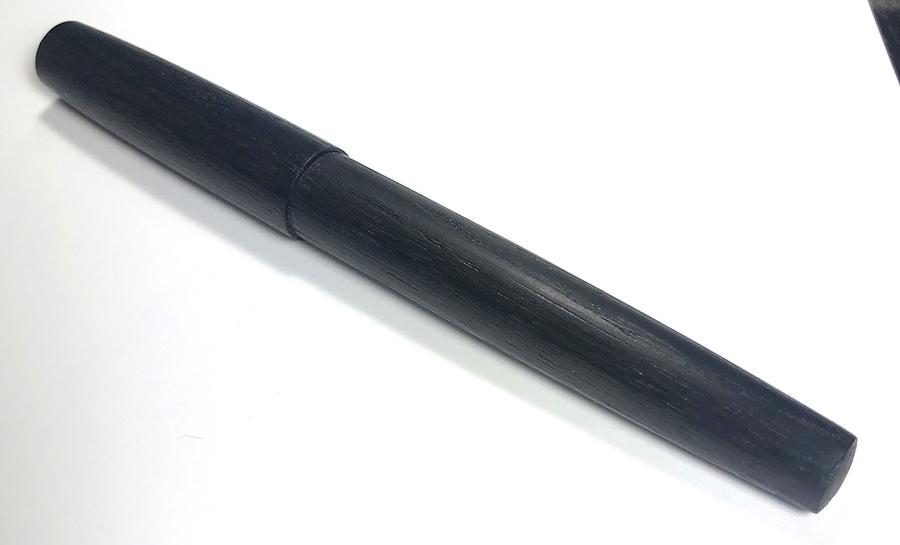

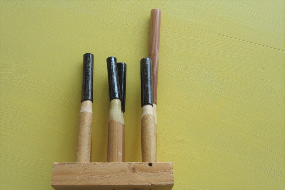

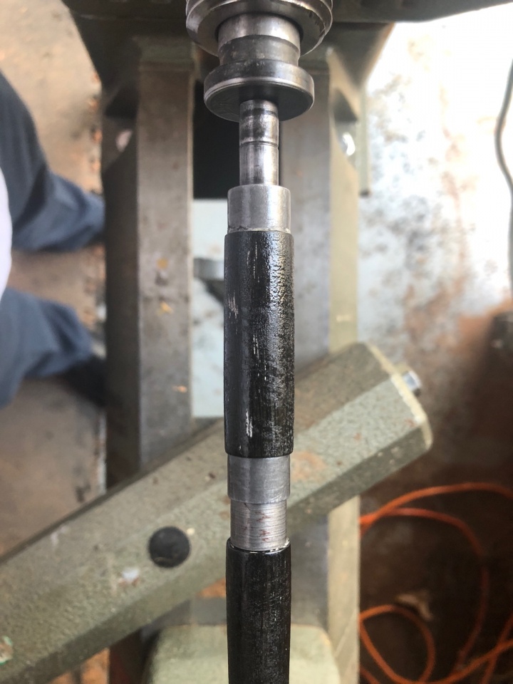

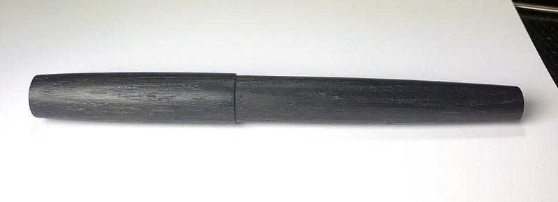

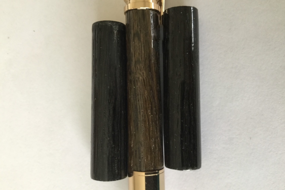

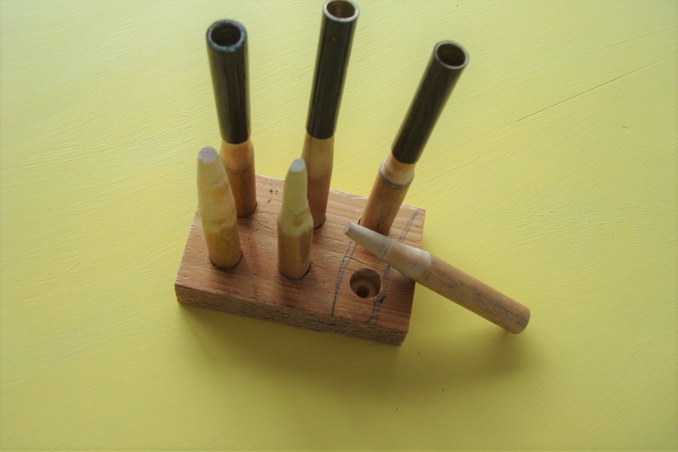

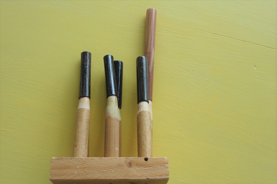

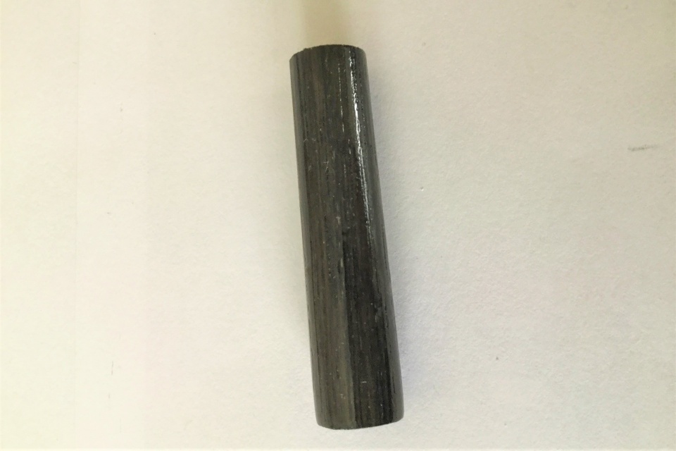

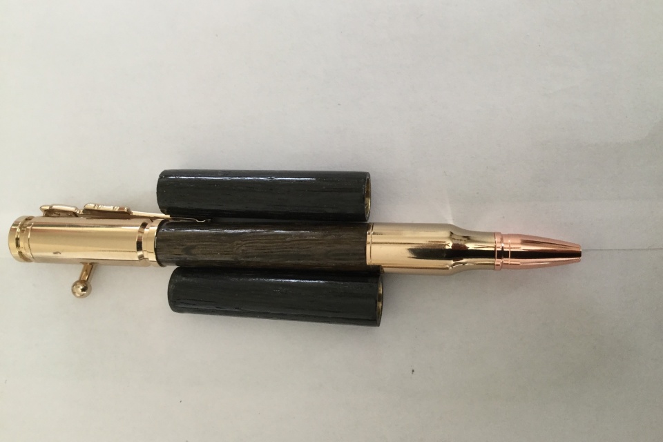

While I may not be able to help in this instance of finishing a bog oak pen, I can share what recently worked for me recently...
I knew if I finished bog oak like I normally do (with several coats of CA), I likely wouldn't get to see/feel what makes bog oak distinctive from just a straight black wood like ebony. So I did my research and found melamine lacquer with a cellulose sanding sealer underneath works amazingly. It dries super quick, leaves no brush/application marks, and is very durable. It's not too plastic-feeling and i can get a matte/satin finish with a few wipes of 0000 steel wool for a very raw wood look. Best of all for bog oak, the open grain does not collect finish and fill up like other finishes might. The texture is almost like bare wood. I just used canned air for dusting electronics to blow away most of any dust that accumulates and wipe down with alcohol between coats.
Hopefully these quick and dirty pictures can convey what I'm describing:
Best of luck to anyone giving it a shot! It's a wood with an awesome history that would be a shame to hide under thick coats of finish.

Using a paper towel to apply the CA can sometimes be a problem because the coarser (rougher) woods like bog oak tend to catch small fibres of the paper which then get embedded in the CA and don't look nice.
I have started using, instead of paper towel, thin craft foam from Michaels. . I cut the sheet into 1" x 3" pieces. . The foam from Hobby Lobby might be better but I don't have access to that store here in Canada. . The foam from Michaels is OK if you are quick, but after a few seconds it starts to react with the CA and makes white smoke. . It is not the perfect solution ... still searching for that !!! . Also, the CA soaks through it and sticks to my fingers on the other side. . Other people here on IAP recommended the craft foam in several threads some time ago. . Thanks, folks !
I have seen people use plastic bags for the CA application but that hasn't worked well for me.
There is a Hobby Lobby close to me so I can give that a try. I think using a needle to investigate the white spots is a good idea. [...]
An inexpensive source for craft foam is our local Walmart store. Walmart sells a 9x12 inch sheet for less than a dollar. It is available in various colors, but I chose white.
Craft foam saves on CA glue compared with paper towels, but I cannot say whether it gives better results. The CA went on more "wavy" when I used it, but I am not sure it was the foam. The issues could have been related to finishing when it was too cold. I'll try again in a couple weeks.
