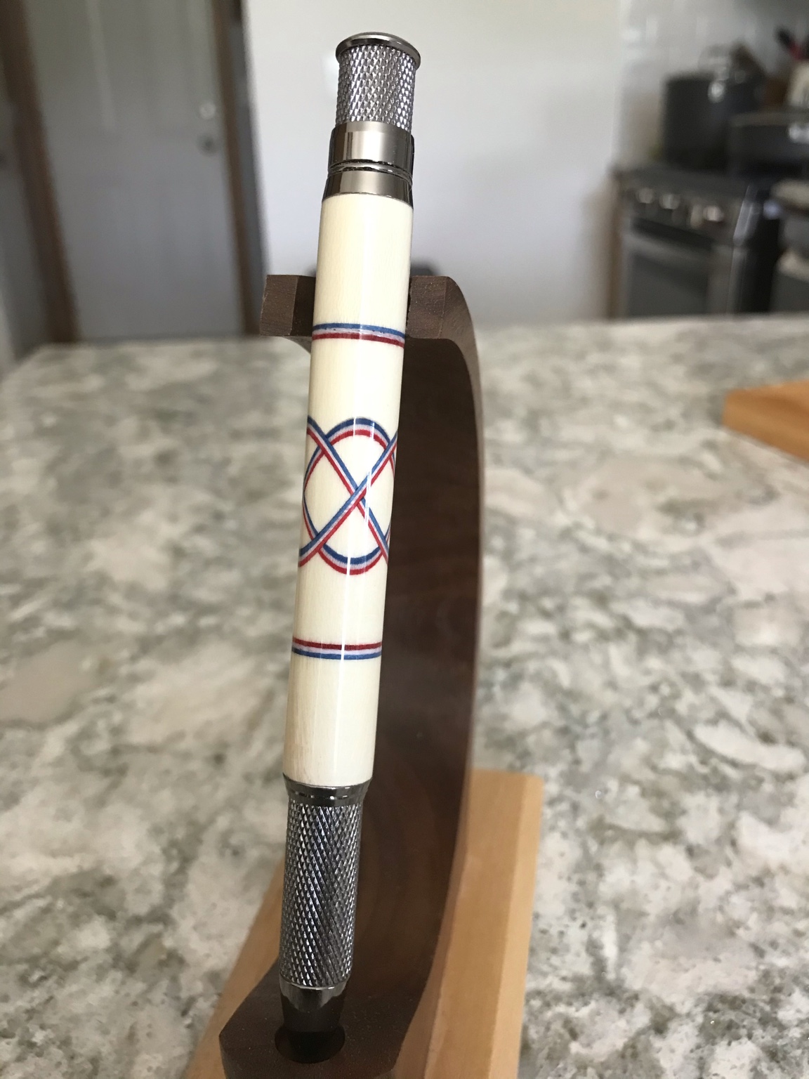

I thought I ought to actually make a pen. I don't see many bandsaw Celtic knots with multi colored infill. This is a patriotic Celtic knot on a gun metal GT Knurl. Wood is holly with red white and blue vaneer. For inquiring minds , the cuts were partial cuts and followed the 1,3,2,4 cutting sequence.
Beautiful work, Ken !!!
Stay in practice !!!
You don't ever want to forget how to make pens like that !!!!
Well done. I do not even want to do a bandsaw knot because i would have to make a jig for that too. Way too much else to do. I am trying so many different things right now. Need to get back to do a few segmented pens to show I still do them. Nice knot and looks exact as always.

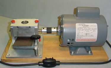

Thank you. I had assumed the veneer wasn't strong enough to be thickness sanded. I just gave it a try and went from .022 down to .016. Not a problem just go slowly. This is the thickness sander I bought and love it. Used my own motor and put a dust port on the top.
https://www.vanda-layindustries.com/html/the_hog_sander.html
