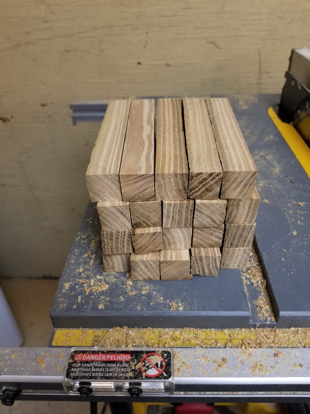

These are are the blanks I cut from the livestock pen board. Again 40 years in the weather but, I was able to go pick out the piece to use.

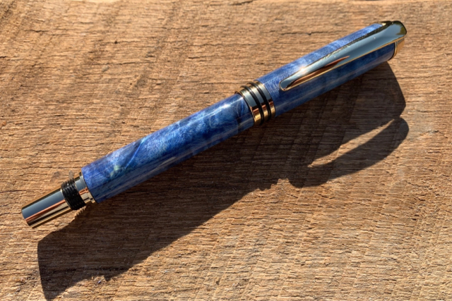

The wood behind the blue pen looks very much like red oak. Being nearly 90 years old, I am surprised it has not grayed out yet, even if inside the whole time. But having been in literally hundreds of barns, it is no telling what particular wood that is. The barns I have been in are - mostly white oak followed by other or any available in the local area. White oak is more resistant to rot than red oak or pine.

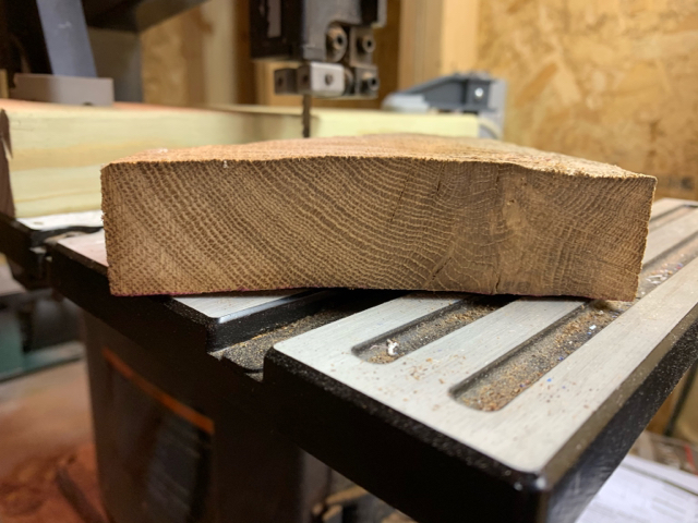

Could be. I do not know the history of the wood. I paid $2 for a slab and can probably get 8-10 blanks out of it.
We can give you a better idea if you can give us a couple more pictures . Cut a 1 inch strip across the width of the board . Sand both faces and the cut edge to at least 220 grit , preferably 400 . Then we have a chance of distinguishing between red and white oaks , or something entirely different . And you will have a cross cut blank which likely will look better than a straight cut one .

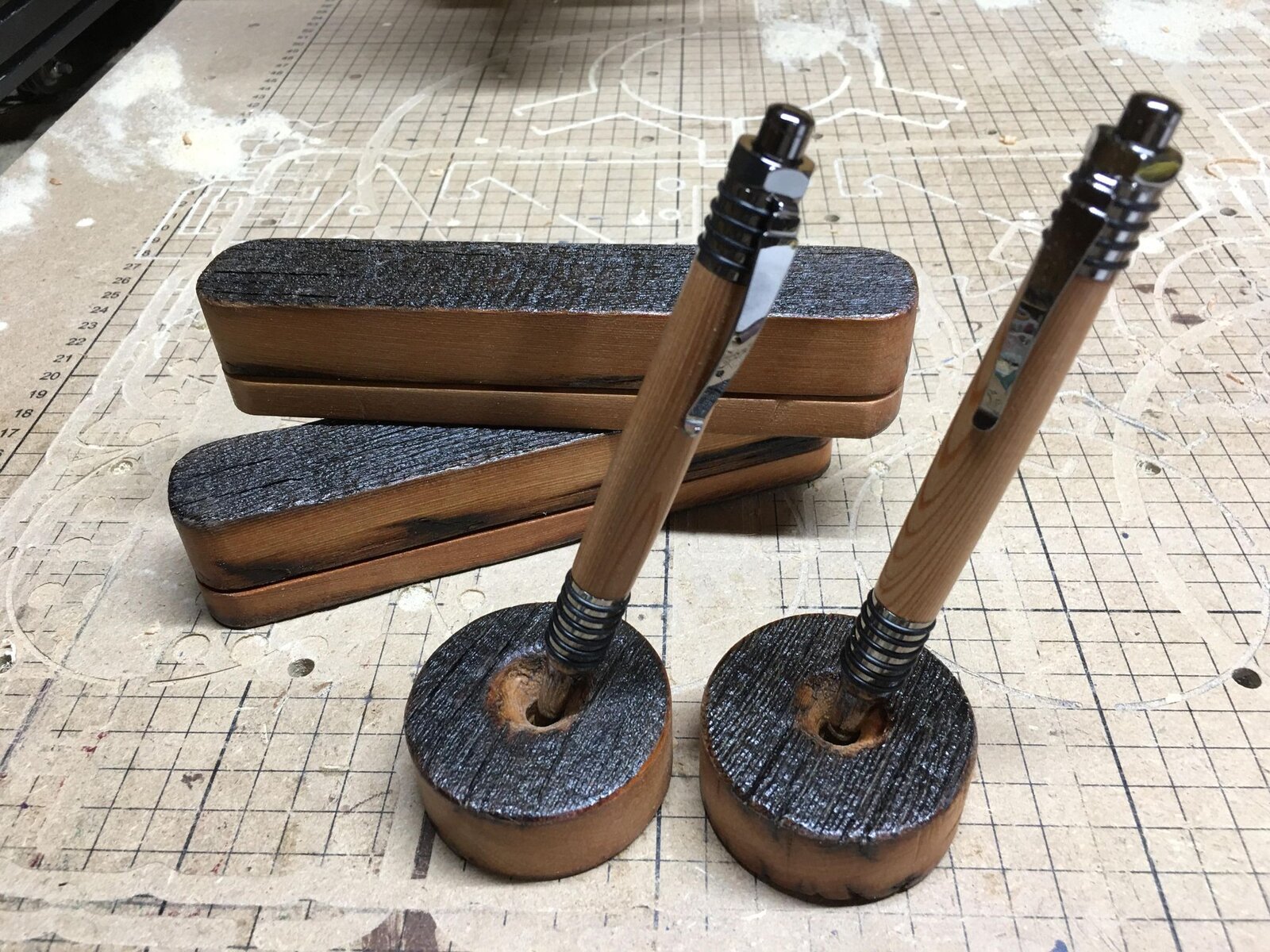

I just finished a couple Spartan pen kits for a co-worker. the blank was a piece of 15/16" barnwood with very weathered surfaces. The surfaces were crumbly with a lot of tear out occuring. but the thickness of the board lent to having enough material to complete the kit. I also had left over stock so I made some boxes and stands from the same wood on my X-carve. Co-worker was beyond happy with the result. And that's all i cared about. Finished pens with sanding and paste wax. the boxes and stands were finished with sanding and boiled linseed oil.
