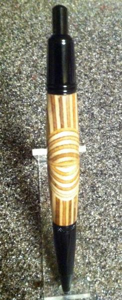

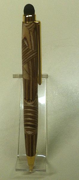

i made several out of baltic birch 3/4 plywood, just can t find pictures now..
(poor pictures)
(poor pictures)
very nice pens, great design. I ran the plywood past him as soon as he asked for Baltic birch and he wanted it solid and plain as the wood would be.
