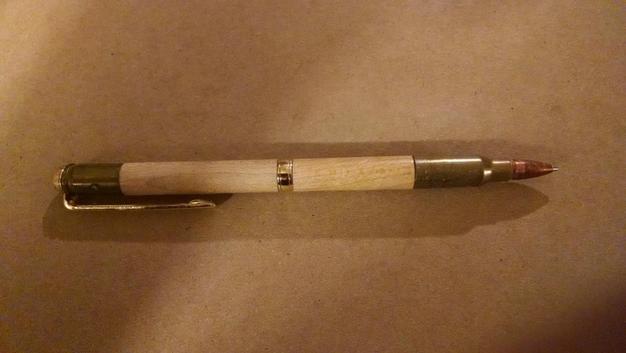

The shell casing is too short to look good, this is the way I make mine. This was made off a Slimline kit as an experiment to test the idea. The top and bottom wood blank was cut to length and tubes glued in. The shell casing was resized using reloading gear the bullet was inserted, then cut in half. The bullet was drilled for use as the nib. The blanks were turned to size and the ends cut smaller to insert and epoxy inside of the brass.
Are you saying the case was fully resized? That is a nice pen. I have access to a gun range with tons of empties on the ground. Rinse them off and put them in the polisher.
Basically I went through the steps to reload the brass without powder or primer. I then cut the brass in half, and I added epoxy to hold keep the bullet in place. Then I drilled out the bullet so it functioned as the nib. All was done using a collet chuck. I tried drilling the the bullet both ways, before insertion and after it was epoxied in place. Both methods are not perfect, there will be rejects from them getting marred or just being stubborn.
The primer end also has to be drilled so the tube will extend up so the finial can be pressed in with the clip. I made custom sized hardwood collets that fit in a 3/4" collet to hold the primer end. Actually I believe I drilled the primer end out before cutting in half, some will get screwed up.
An AR 10 casing (7.62/.308) is nearly perfect in size for a slimline. I copied this style from a pen I saw and love it.

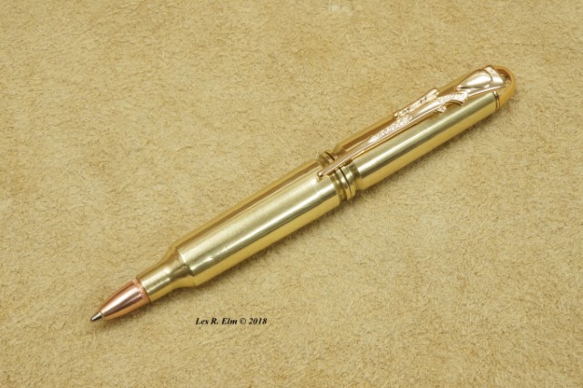

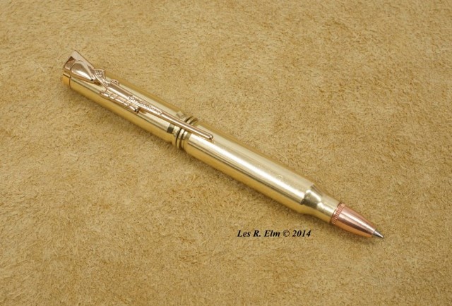

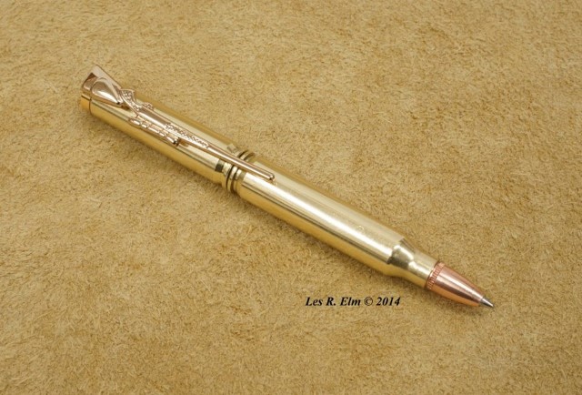

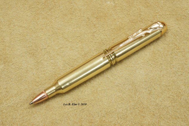

I make my .223 and 22-250 rifle cartridge twist action's using 2 casings and an actual bullet nib.
Using casings for the top section keeps it in proportion to the barrel section.
Les

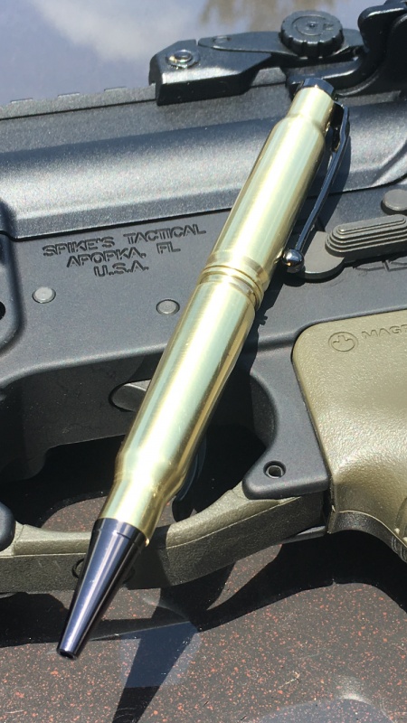

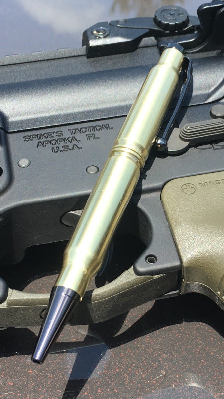

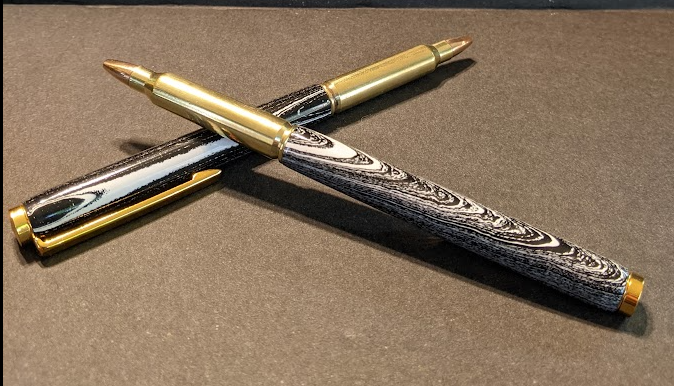

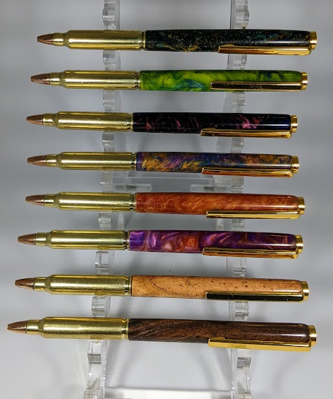

Here are a couple images of .223 pens I have done. The casings are resized, bullets drilled and pressed in and then a 7mm tube installed in the casing to accept the 7mm transmission. You have to get a little creative with the tube length in the upper half to compensate for the length of tube that has to stick out of the casing to ensure proper ink protrusion.
