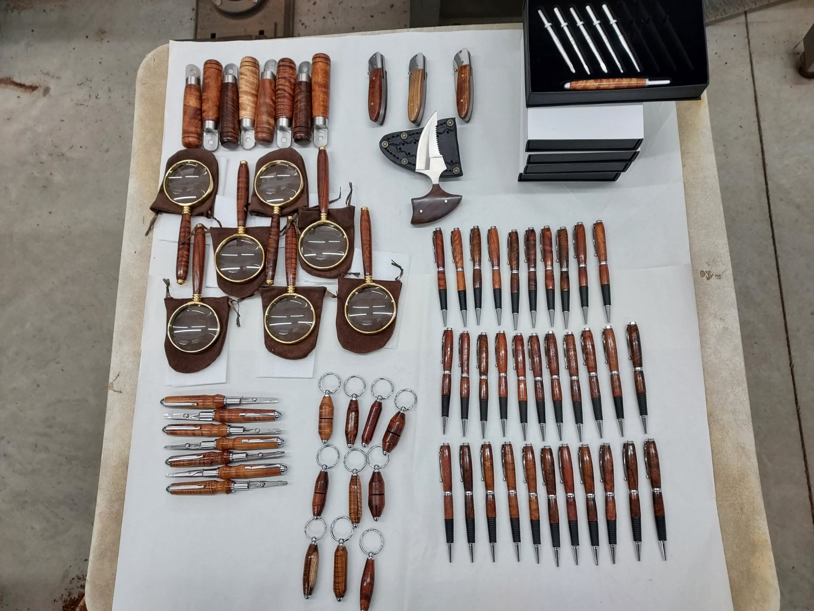

Why a friction polish? If you're looking for a great shine, and it does work, and durability why not try WOP (Wipe On Poly). I've been using it for years and it works great. 3 Coats put on at a high speed, let it sit for 24 hours between coats, and then apply another coat, 3 in total. It needs no buffing (99% of the time) and holds up well (almost 600 knife handles later with no complaints as an example). I've used Aussie Oil and it worked great but I ended up chucking it cause it wasn't consistent, WOP is. Give it a shot. As for CA, you can have it. Never tried it (allergies) but I've received pens from others who have and all I feel is a bumpy mess. Maybe sanding it might help but that's another step I don't want to do. That's my take. Marks does sound interesting though. Good luck in your quest.

No, I'm not spinning my knife handles on my lathe. It would be pretty cool but I'd probably not have any fingers left. I was addressing the durability of WOP. Here's an order I did that went to Hawaii. All done in Koa and finished with WOP.

Those all look wonderful. I really like the hand shape on your seam rippers. I keep saying I'm going to make a couple but I don't hardly have anyone in my lift any more who sews! One cousin may get one just so I can try it out. Is there a brand or manufacturer you really like?
As far as WOP, I kind of figured you weren't spinning on the lathe unless you were doing some form of handle for a hidden tang. I have done several skinning and fillet knives over the years and have used Tru Oil. I have a chef's knife I have to order the steel for and set a handle on for a close friend who just retired. I may have to experiment with a poly a little.
