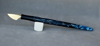

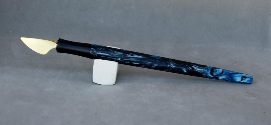

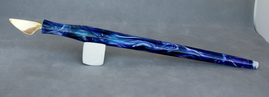

I turned one similar to this a few years ago for my Step Daughter, but got the components from somewhere else - the Golden Nib I think. It's an easy build - single tube, design possibilities are endless. The lower part was acrylic, finial was offset turned wood. Ended up being really nice. I'll see if I have a picture of it and post it.
Here are the pictures.
She's an art student, so she uses it for pen and ink sketches, and she says she really likes it. Her Art teacher thought it was neat as well.

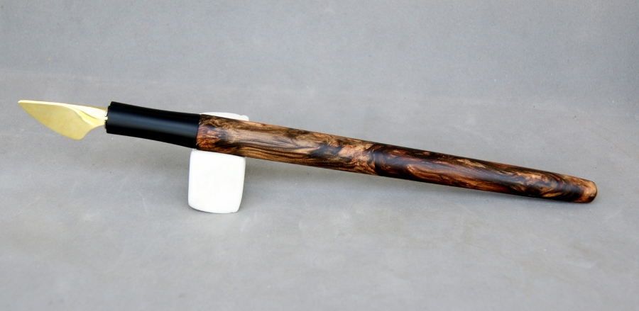

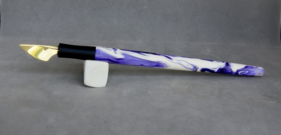

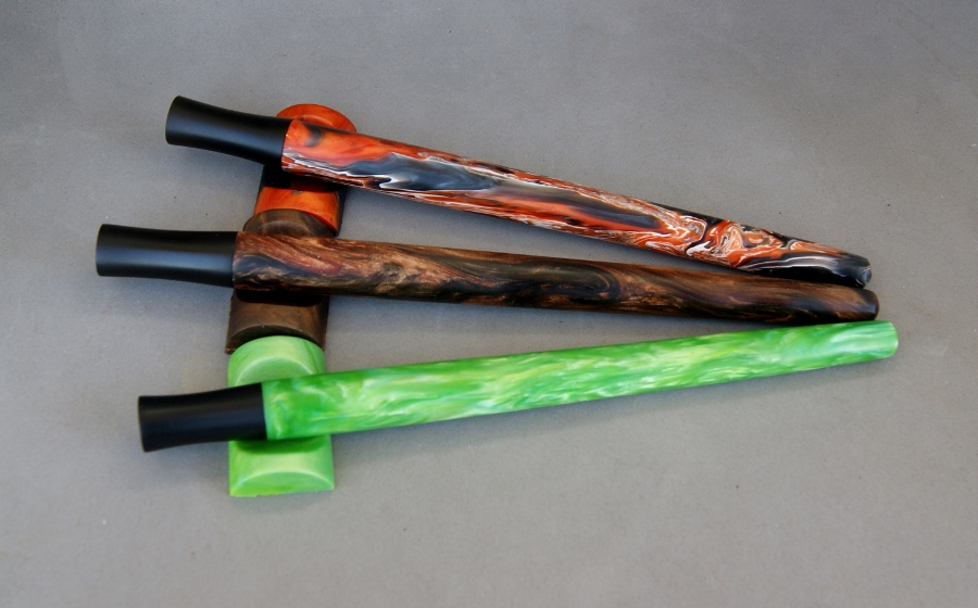

Easier Solution
While I can't comment on the PSI kit there is a much cheaper and simpler way to go about making a dip pen holder.
You can find all the supplies you need from several places:
John Neal Books
The Golden Nib
Paper Ink Arts
All you need is one of those inserts, a nib, and a 7mm tube (optional but recommended). All together it should cost half as much as the PSI kit.
One 7mm tube is long enough for two inserts so I cut my tubes in half. Using a tube helps make the inserts easier to remove bc they can get worn out as well.

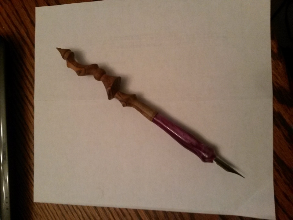

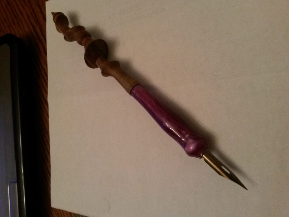

If the nib doesn't press in easy try rotating it to another position. Just tried it on a cocobolo dip pen I made and on one side it is extremely snug. I rotated it 90deg and it slipped in easy.
That being said I was using a Speedball C2 as opposed to a pointed nib which I have on another holder. I haven't measured but I think the pointed may be slightly thicker.
Skie...Swing by a Hobby Lobby, Michaels or another big box craft supply and pick up a starter dip pen set and some ink. They range from around $11 and up. The holders are cheap but functional and will allow you to play around and see how they function. There are a lot of videos out there as well.
I'll have to check it out at my local hobby lobby.
If nothing else, perhaps I can get some functional nibs there for these pens.
No ... changing positions for the nib doesn't work, the metal of the insert is crimped much too tightly. Inserting it by hand will be impossible without causing injury...
On the other hand, after I had inserted it into the insert, I can grasp the nib with a folded paper towel and pull the nib and insert out together easily.

I'm new here. Hope you don't mind me asking, what are the gold pieces inserted on the top of your dip pens on the pics? Thanks
