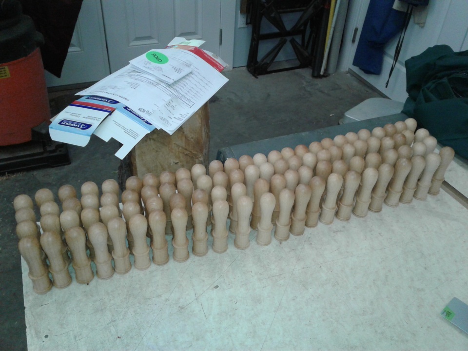

Well without one of his beading tools doing these handles would be a real chore.
3 beads on each one, and 200 a month.

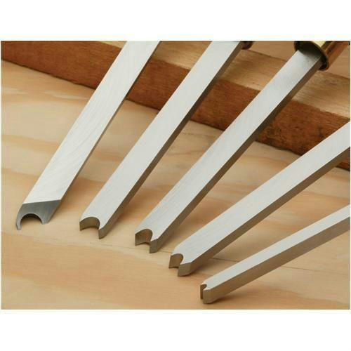

Ok, so these are what my bead tools look like. I can sharpen the outsides but it feels like the inside of the coves are not sharp. They will start to cut the bead but burn my wood more than it does cut when it gets to the cove. So sharpen these flat?
jttheclockman
Feb 22, 2005
19,135
NJ, USA.
Yes If you start sharpening inside the cove you run the risk of changing the profile shape of the cove The inside doesnt do the cutting it is the flat on the back side that cuts. This idea is applied to any scrapers and a beading tool is basically a scraper. Happy Turning. :)

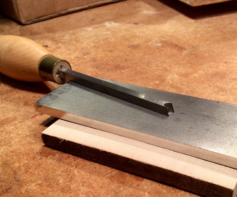

Here is a pic....as John said, you sharpen the top or back of the beading tool to create the sharp edge where it intersects with the curvature. Note the tool is upside down on the diamond hone to take material off the top.
Hope this helps.
