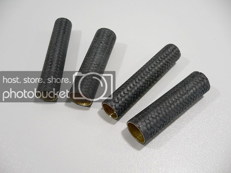

I had a similar problem at the start but the fix was quite easy. CA is the way to go. Apply your CF sleeve to the blank and absolutely flood it with Thin CA. Let it cure fully and then wet sand it to remove any loose and stray fibres and then give it a really good wash to remove the dust from the recesses. It will look quite rough and white but as said that will vanish when you cast it. I don't have a pressure pot but since doing this I haven't had a single problem with bubbles.

If you mean the the CF when the CA has cured, just a 600 wet and dry.it's only to remove stray fibres and high spots. Here is a pic of some tubes done and ready for some watch parts.

OK, Thanks. The edges of yours are nice and clean too. I've just been trimming them with hobby scissors.

Yes, That's what I was asking. You're tube ends are cleaner than mine too. I just cut the CF withdetail scissors. Sorry my last post didn't come up when I opened my browser. Didn't mean to report.
