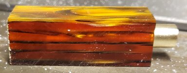

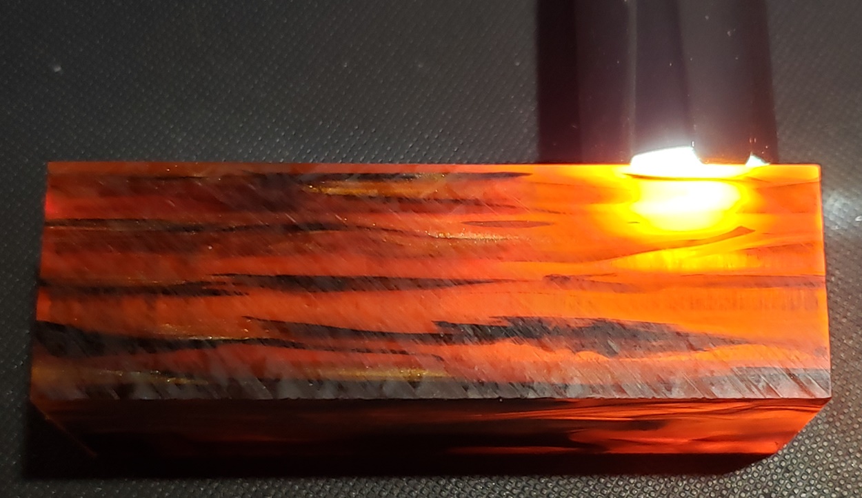

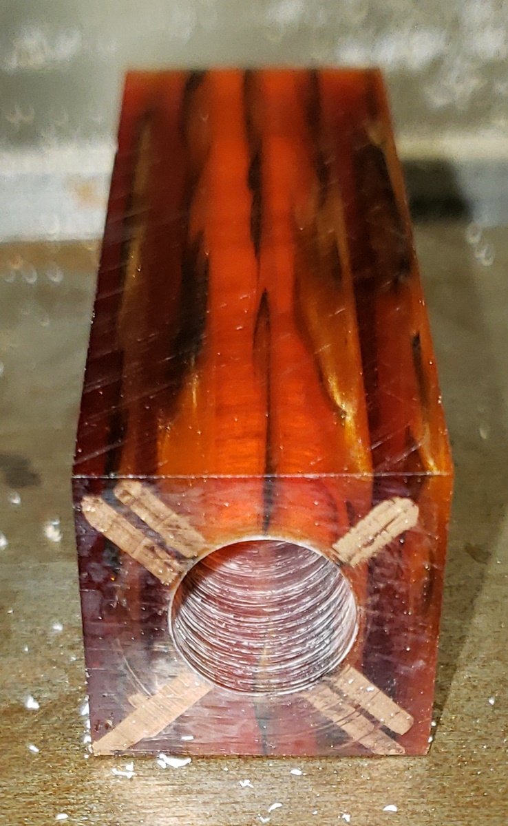

I ordered this blank not realizing just how translucent it is. I will be painting the tube, coloring the epoxy, and back painting the blank. But what color? Black? Gold? Copper?

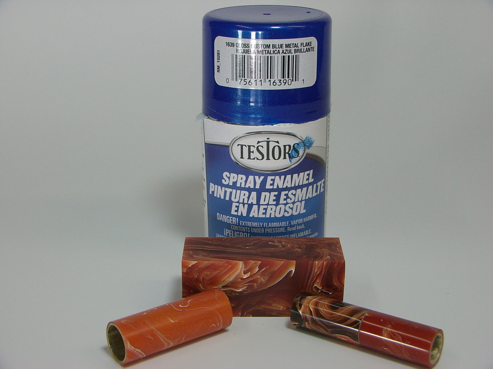

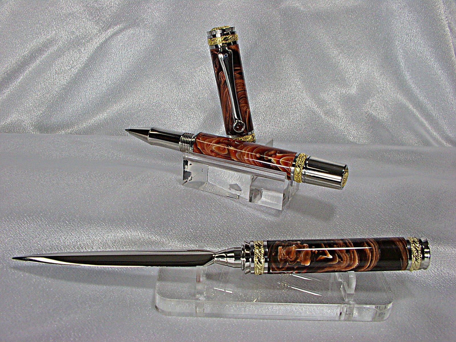

I would experiment. May want to try metallic blue. Here is an example. I had shown this when I made this pen set. I tried white and it washed it out(left) I tried a brown/red mix and it muddied the blank (bottom right side of blank) and settled on metallic blue which brought out the orange and highlighted the black (top right) I should have mentioned I tried black also but made the blank too dark and washed out the whites. Also mention I only back painted the blank and no need to paint tubes. I never do that. I will at time add some color to epoxy but not always. I did not in this case. All the Sierra pens I just shown were back painted with a color close to the blank color but that was because there were no veins running through them.

I would use copper-red on that one.

I would experiment. May want to try metallic blue. Here is an example. I had shown this when I made this pen set. I tried white and it washed it out(left) I tried a brown/red mix and it muddied the blank (bottom right side of blank) and settled on metallic blue which brought out the orange and highlighted the black (top right) I should have mentioned I tried black also but made the blank too dark and washed out the whites. Also mention I only back painted the blank and no need to paint tubes. I never do that. I will at time add some color to epoxy but not always. I did not in this case. All the Sierra pens I just shown were back painted with a color close to the blank color but that was because there were no veins running through them. View attachment 235663View attachment 235664
Ooooo! I like that look.

Wow! I would never have thought to paint metallic blue. the pen and letter opener are fantastic.
That is the thing you never know what colors will do for a blank I wish I had taken a photo of the black sample I did and shown that compared to blue. Huge difference. But I threw it out.
I would love to see how it looks when you are done. I have reverse painted and painted tubes, but for something that see-thru, I can always see the drill marks (I even sanded them how and didn't like the way it came out) . Good luck and let us see it please. Thank you.
I haven't decided what to do yet. This blank isn't just translucent, it's almost clear in places. Whatever color I use will definitely show through. I think black would be too dark. I'm leaning towards something metallic, but I just don't know.

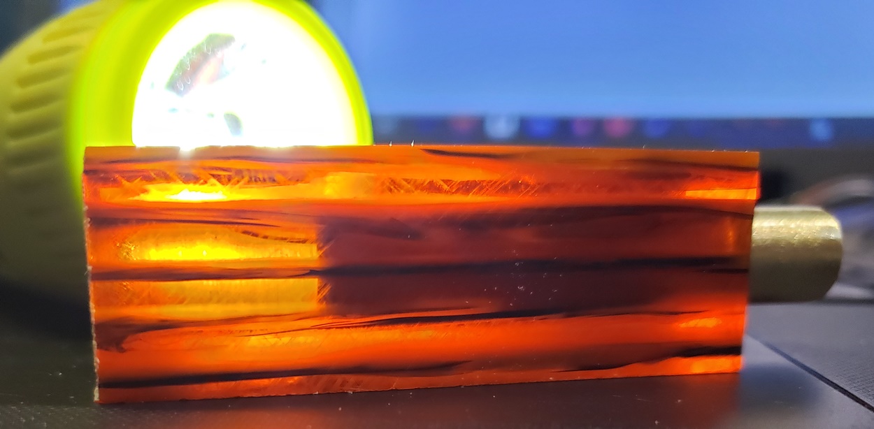

I've mentioned it before but it bears repeating. Polish the end of the blank and then cut a thin slice off. Now you can put it on any colour you want to see the effect. Coloured paper, spray bomb lids, fabrics, nail polish bottles, anything. Once you find the colour you like you can get some of it in your favourite paint and use it. Also good for seeing what colours can do to enhance a blank or kill it.
Like Magpens suggested a nice coppery red would pop! I want add something tho. Since the blank is so transparent. If after drilling the hole isrough or looks too dull or cloudy run some rolled up sandpaper through it and then polish a bit. You'll be surprised the difference it will make.

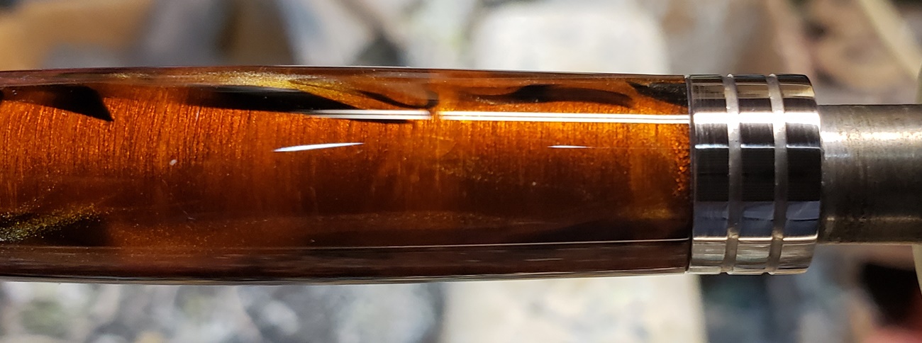

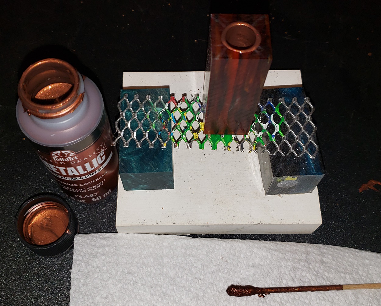

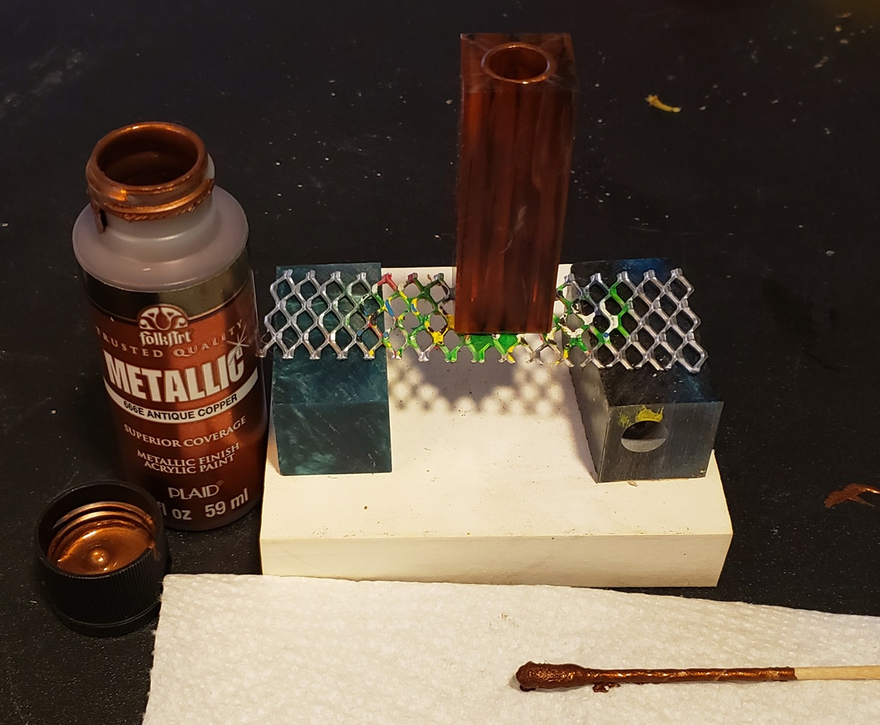

I bought this today.

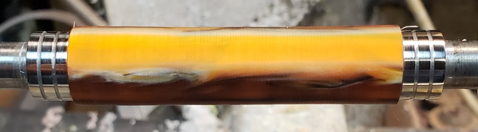

Even without sanding the inside of the hole, you can clearly see the brass tube through it.

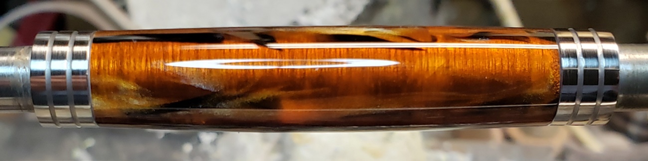

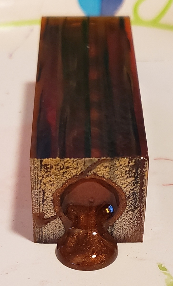

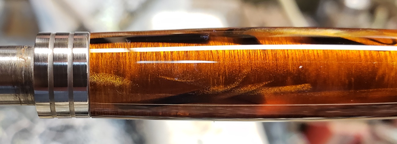

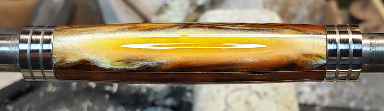

Hard to say until I finish shaping and polishing it.

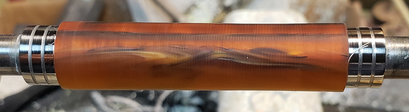

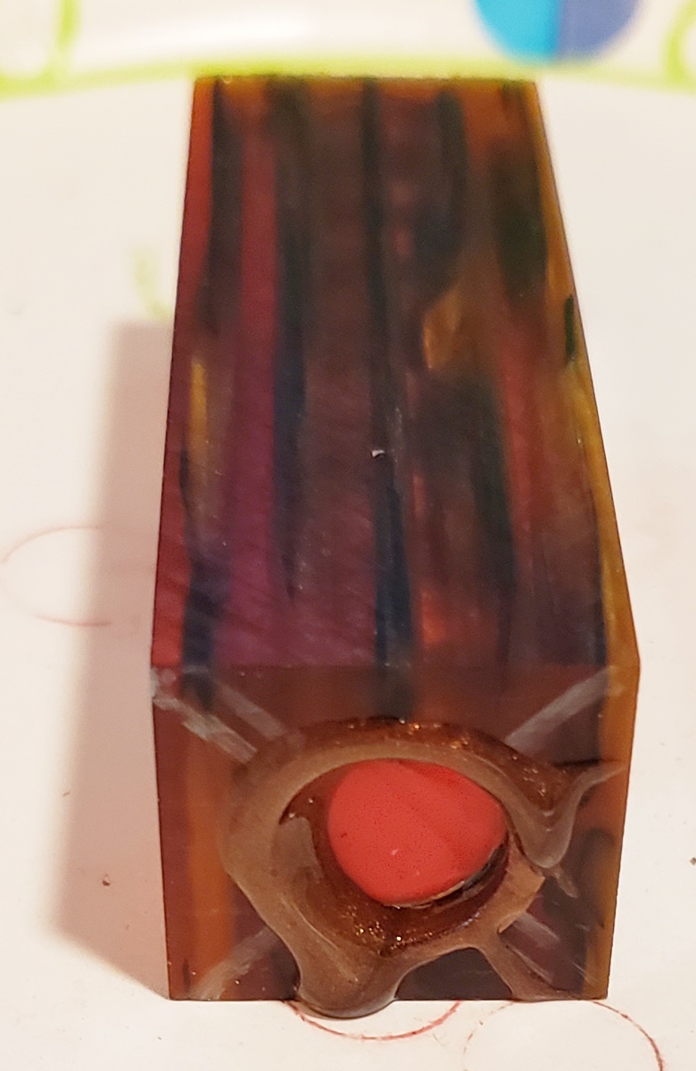

I don't like it. I'm guessing the radial scratches are drill marks. I thought the paint would hide them. I should have used the sandpaper-on-a-stick like Mick suggested. I do have enough of the blank left to try again.

A blank that transparent definitely needs to have the inside sanded and polished. As I always say take a blank and break it down to layers. When all said and done. Top coat, blank material, inside blank material, adhesive, and then tube. Looks like the color will work for you though.
I've been thinking about it, and even if I polished the inside, it still wouldn't look good. If I back paint it, the paint would show. If I paint the brass tube and/or color the epoxy, it would show. I can't imagine the blank looking good no matter what I do.
How do you figure that. Those type blanks are used alot. The key to a good paint job is to spray it and not brush it. Spray in from both ends and let drip free. Do it all the time. Just need to make sure the hole is large enough that you do not scrape it when putting tube in. You can do it. Do not give up.

I suppose to the uninitiated they might look like part of the design. But I still think they're ugly.
Nice finish though. As I wrote, I bought special mandrel to sand the inside...it was smoother, but still not to my liking.

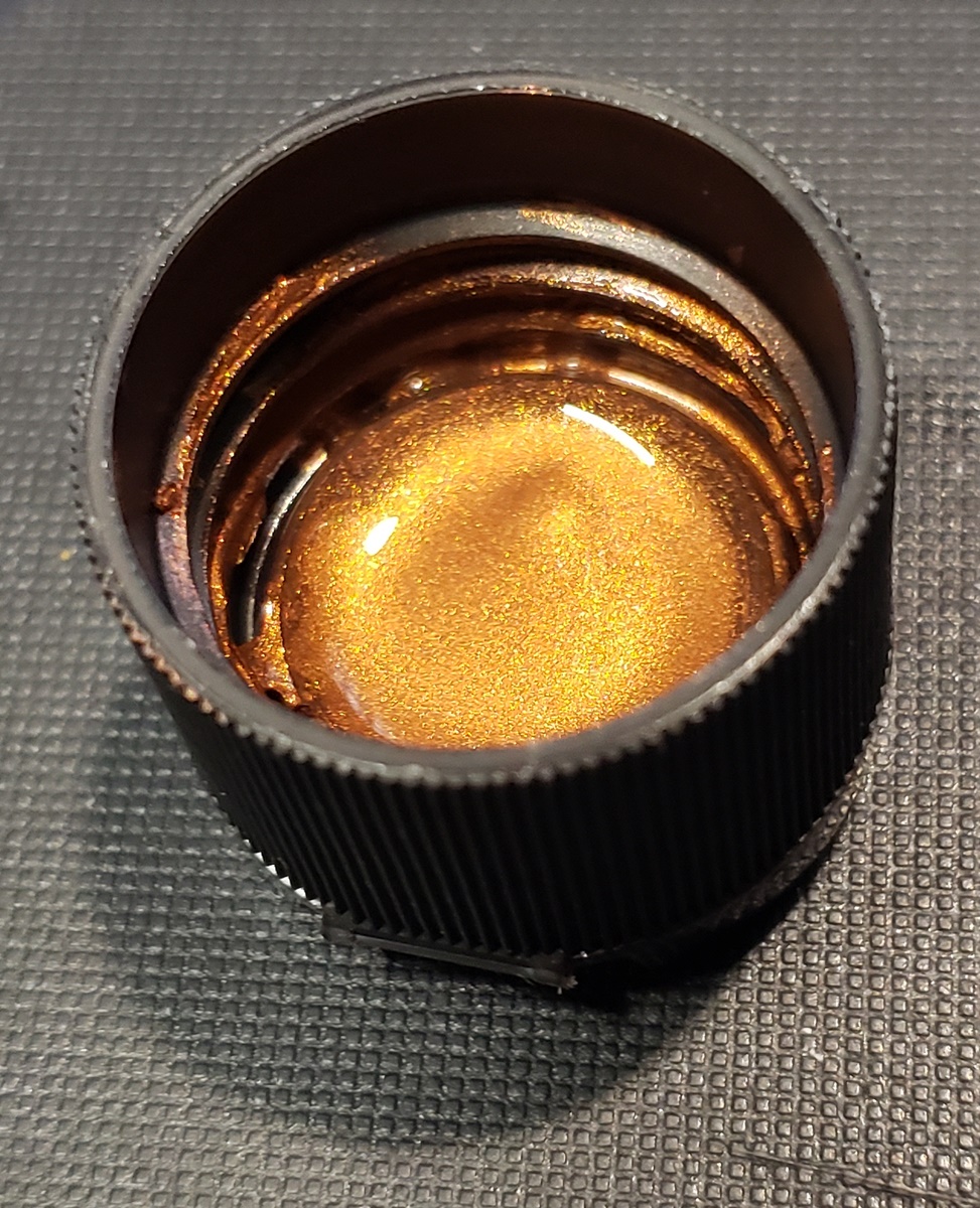

I think the problem is, parts of this blank aren't just translucent, they're downright clear. Normally, with translucent blanks, I back paint, paint the tube, and color the epoxy to prevent seeing the "glow" (for lack of a better term) from the brass tube showing through. Especially at the ends, where the material is the thinnest. But with this blank, everything you do is going to show through.

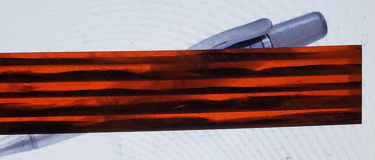

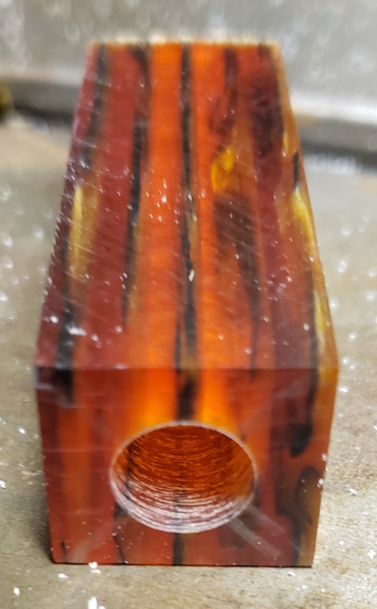

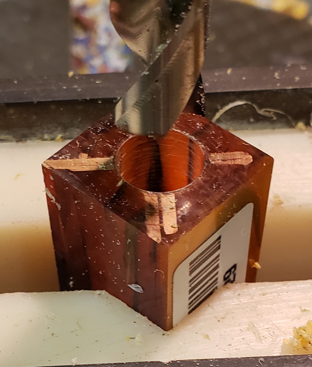

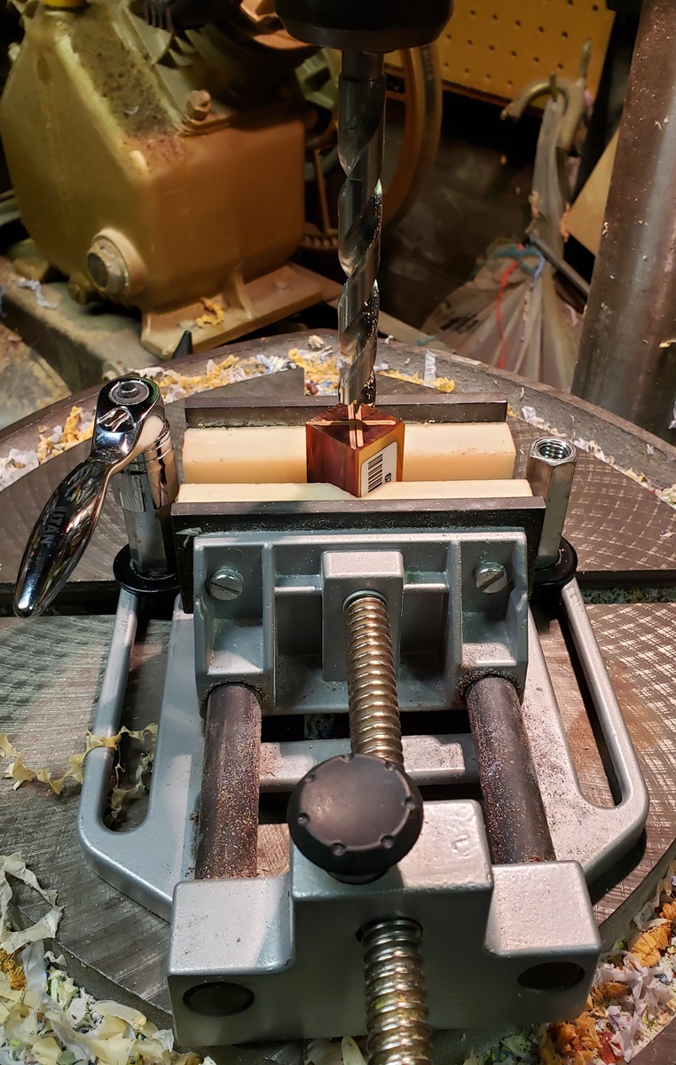

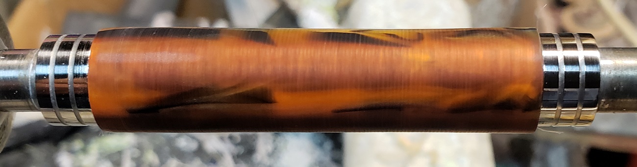

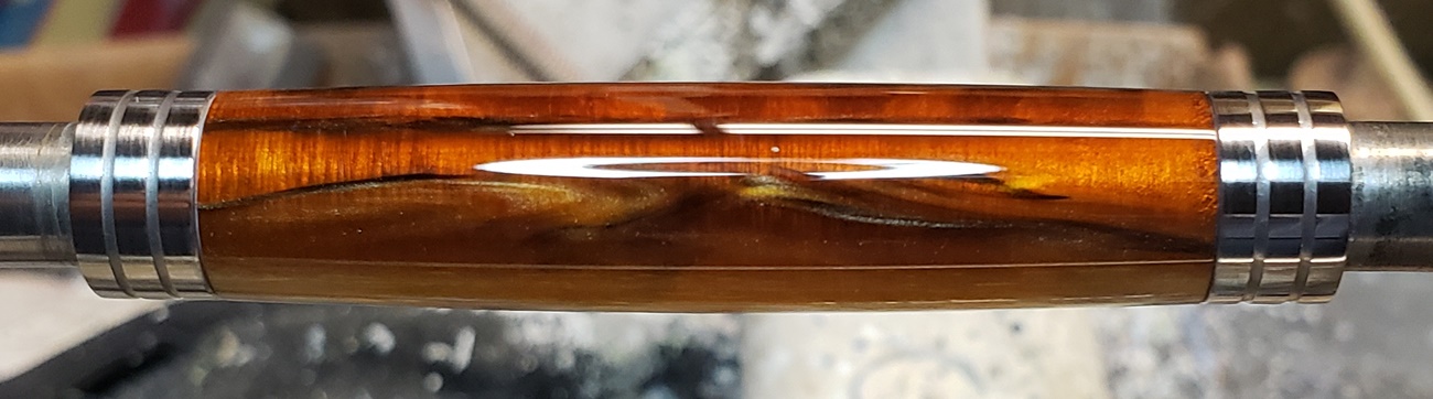

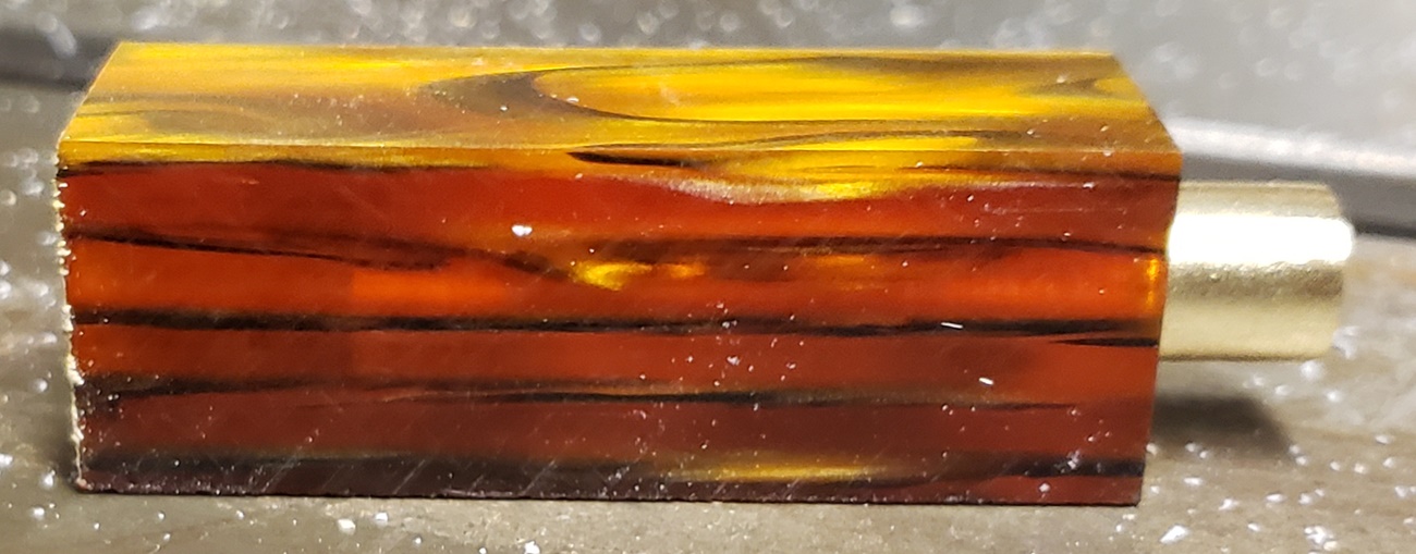

I decided to experiment with the other half of the blank. I'll sand the inside and see how it looks.

Does any one have an issue with seeing the drill marks when painting the inside of the barrel?
Have you tried chemical polishing with DCM? My drill bit left spiral gouges in a dear - but rather transparent - blank. I used an extra induction hotplate instead of the hairdryer and a small bottle of Goof-Off for the chemical itself, but everything else was basically the same set-up (including the adequate ventilation!). Downsides were 1) still having to manually sand the worst of it, and 2) the inside being so smooth resulted in decreased paint adhesion to the inside of the tube. Still think it was worth it.
Maybe it'll help. :)
Thank you. I will read. I did try acetone, but not the above, Thx.
