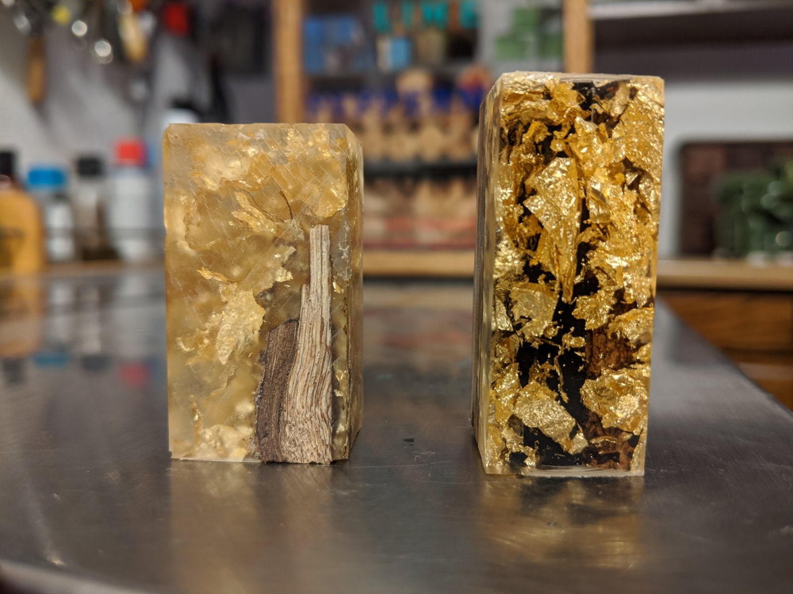

Do you have any photos of your blank, especially before and after?
Not of the drilled hole since I didn't take a picture, but I can get you close. The blank on the left shows a similar "haze" to the one I was working with: just imagine it in the center surrounding a hole. Right was chemically polished, backpainted black, and the tube pushed in VERY carefully (again, paint adhesion problem when it's that smooth) with multi-stage CA flooding. I'm pleased with how it turned out, though perhaps I'll try John's suggestion of scuffing the inside next time.

That blank is lovely, the brass isn't... So omit the tube. I've seen and never made pens that were transparent so the mechanism showed thru mostly on fountain pens.

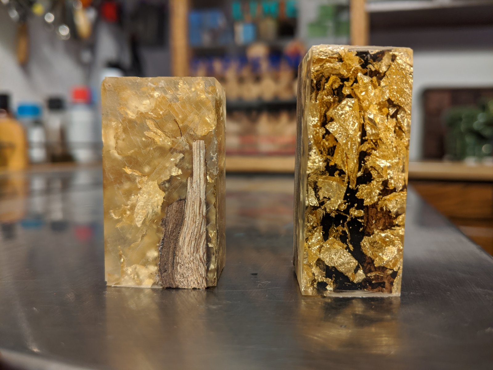

Is that gold leaf? Dear Lord, how much do you charge for those pens?:oops:
I suppose to the uninitiated they might look like part of the design. But I still think they're ugly.
I've not done many pens using a clear blank, but enough that I mentioned the inside sanding. It's been my experiencethat, like you said, nothing I did looked good. I've since begun thinking of transparent blanks as only good for kitless fountain pens that use no tube and polished the same inside and out.
