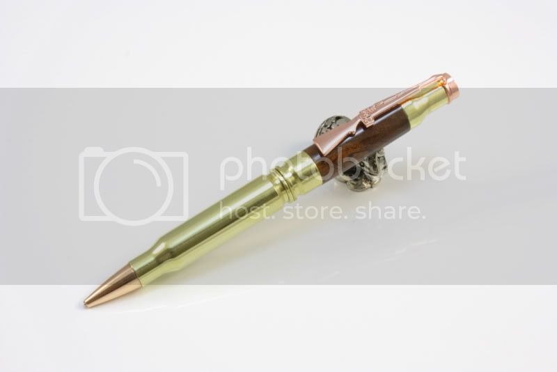

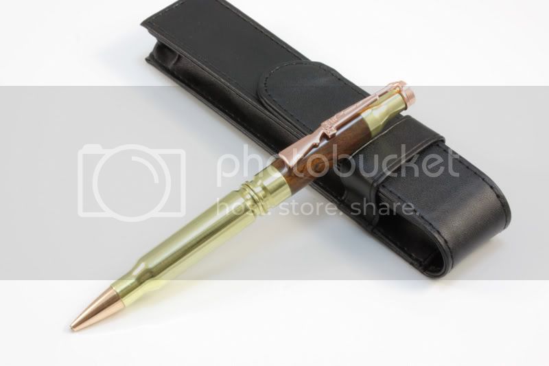

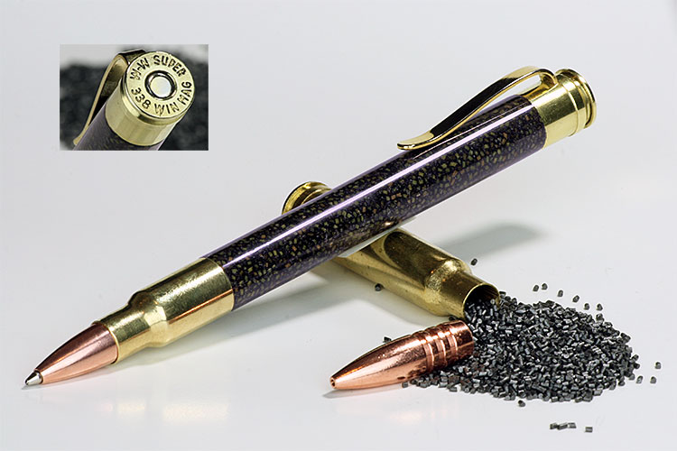

It's made from a 338 WinMag shellcase, 338 caliber solid copper bullet, a fired (but undimpled primer), and real gunpowder. The parker-style refill extends with a twist of the bullet, which also unscrews for replacement. The belted case-head is one piece -- the clip extends through a slot cut in the brass.
I hope you like it,
Eric
Eric

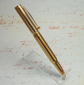

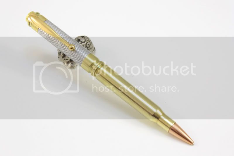

Thought I'd better participate as well.
Recently bought a jaw type knurling tool and am having a lot of fun playing with it.
This is a .30-06 bottom part, with 2 .308 primer ends and some knurled aluminium which has been turned down slightly to only leave the diagonal line pattern.

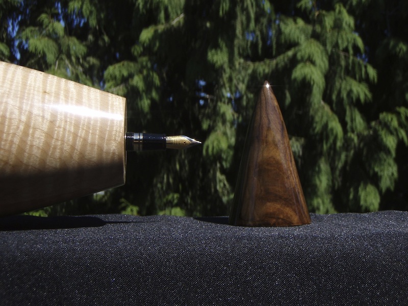

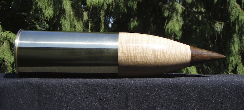

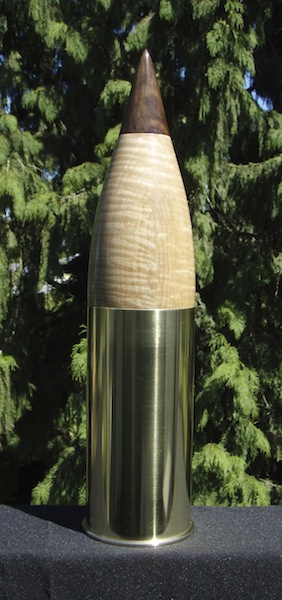

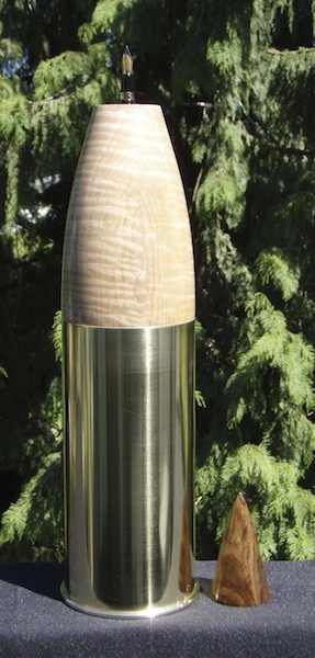

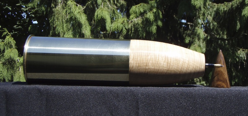

This is my Fountain Pen made with El Toro parts, Curly Western Maple, Crotch Black Walnut for the cap, and a 105 MM Howitzer Casing. Finish is about a half dozen coats of General Finishes Enduro-Var, Water Based Urethane, sanded to 600 and buffed with all 3 stages of the Beall set.
It measures 19 1/4 " long when capped. The casing was cut down when I got it or it would be longer. :smile:
Go big or go home! :eek:

Some amazing pens guys. How much does that Howitzer weigh?? You'd look like Arnold after writing all day with that thing:smile:
That is an awesome pen although somehow I have a sneaky suspicion it would not make it through airport security
Anyone big enough to carry the pen in their shirt pocket will not be hassled by anyone, anywhere, at any time. :rolleyes:
WHAT....no clip? :biggrin::biggrin::biggrin:
Laws here do not allow high capacity clips, and I thought a little 10 shot clip would look silly. :tongue:
It weighs 2860 grams (6.3 pounds). Admittedly not the pen normally selected to write a novel with, unless they happen to be a loader in an artillery battery. :wink:

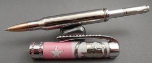

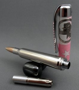

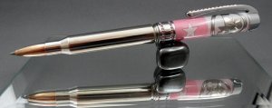

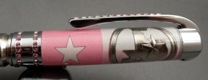

Princess Tru-Shell Pink Texas Flag
I was a little unsure of my submission pen for this year's contest for lack of new ideas until this one came to mind! This pen signifies a few things for me:
First, our Rifle shell pens always seem to cater to the men on here, so I thought it was time to offer up something to the ladies! Several things do that, starting with the upper barrel of the Princess pen kit and its sexy bling that it has to offer. However, I stretched this barrel a little longer to accommodate the flag and quarter design and to balance the pen better.
Second, I'm all about breast cancer awareness and thought the Pink Texas Flag could represent that along with the Swarovski crystals that adorne the centerband and clip. In my mind, I envision the 280 rifle shell representing strength and power and the flag/quarter to signify unity among all who have been directly affected by it.
I soldered the lower barrel of the Princess pen kit in to the rifle shell once drilling was complete. Pressed in the center coupler and made the necessary adjustments for the retraction of the ink refill.
I truly hope this can be an inspiration to all.
That is awesome Seamus! It looked good in my sneak peak, but man it's SO much better that I'd originally thought! Glad you were able to get it finished before the deadline, mine's not looking too hot at the moment.
hey, dont be discouraged, you still have plenty of time. You should have seen the way I had to make the modifications to the upper barrel of this thing. At one point I thought it wouldnt work, but I took a deep breath and crossed my fingers:biggrin:
Excuse me!!:mad: I believe I asked someone to SHUT THE FRONT DOOR! Now, Seamus has posted a pen that I could never match up with.:redface: Very nicely engineered Seamus! I appreciate the cause as well. :wink:
Easy now, Easy, I wouldnt go that far with it:rolleyes:, but thanks for the compliments. :biggrin: Thats a cause that means a lot to me personally.
