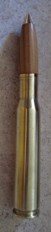

50 Cal Entry

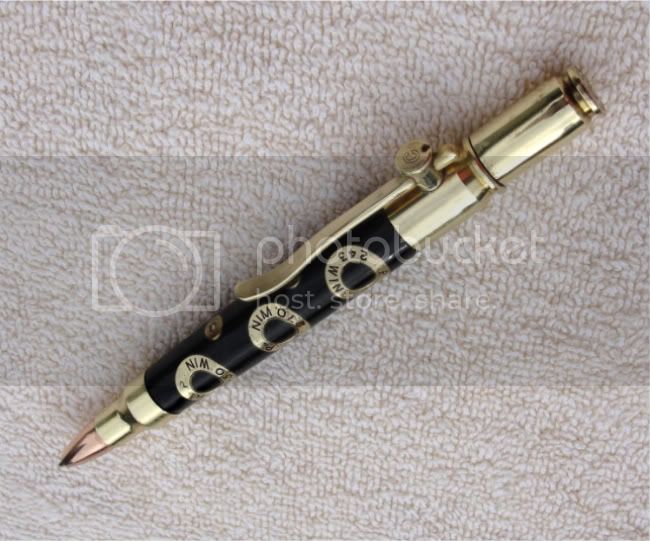

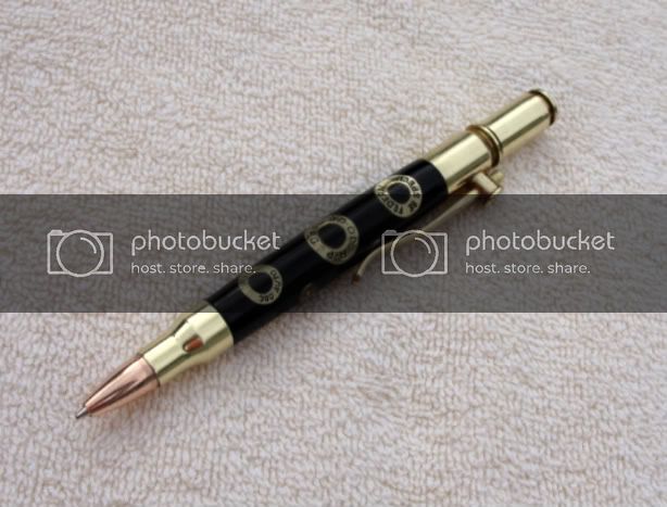

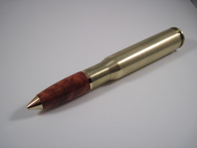

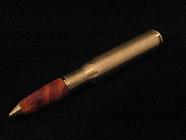

Well, it's not as fancy as the others but what the heck, here's my entry. 50 cal with Amboyna Burl.

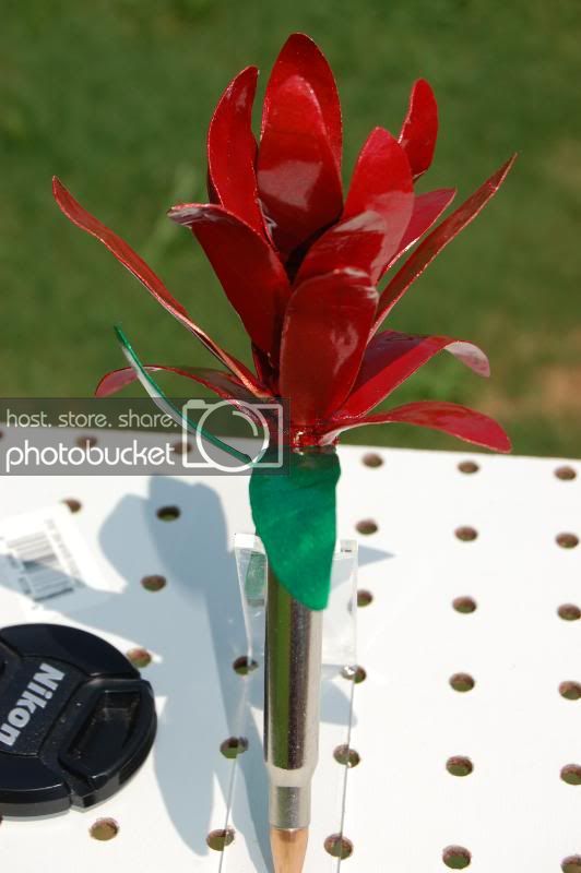

Guns and Roses
started a new post but figured it should be in this one also.

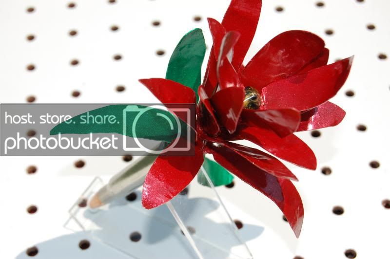

This is my first casing pen thanks to the generosity of Sylvanite on here. The casing entry was about using a shell casing well I used about 15 to get to this point. Some of those are now destroyed needless to say. The leaves and petals are 270 and 308 casings and the finial is a piece of acrylic turned for what I hope looks like a bees behind sticking up out of the flower. Comments and critques are welcome and encouraged as I have never attempted anything like this before. Thanks for looking.

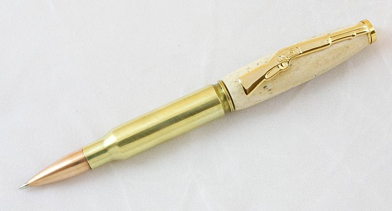

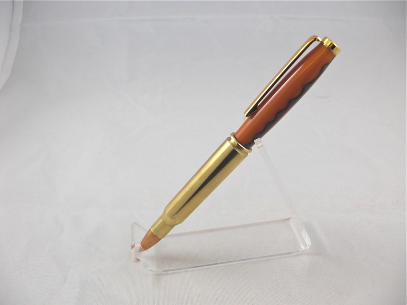

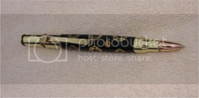

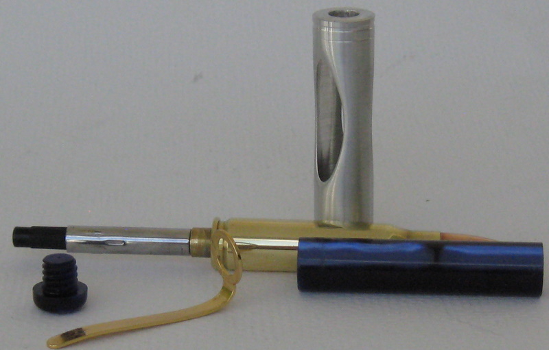

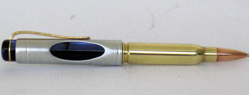

My son has really been wanting a bullet pen and with this challenge a great offer was given.
Eric from Little River Crafts donated the components in a 30-06 and Cathy Sue donated a few blanks to get me started as a new turner. Together I came up with this. Nothing fancy just a good first try. Next time I think I'll turn it a little bigger since it looks to small on the 30-06. The blank looks a little like fire and air turbulence so I called it that.
Thanks for looking

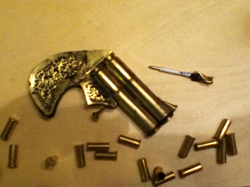

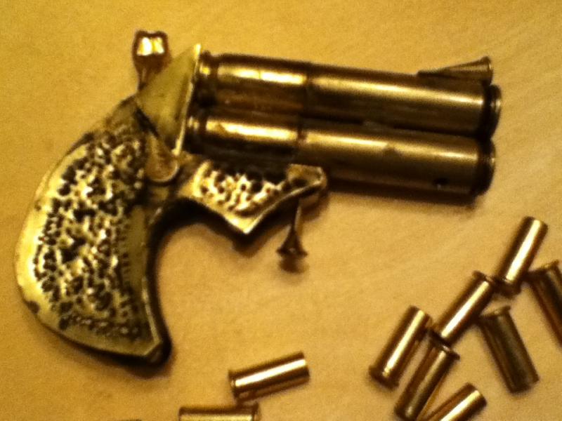

My humble entry
This pen was made to look like a derringer pistol. I used
* 2 .308 shells
* 2 .45 shells
* 4 .22 shells
* 1 brass sheet
* 1 1/4" thick piece of wood
It takes a shortened ink cartidge, if you pull out the "hammer" it is the ink cartidge. it has some black paint on the ink cartridge to make it blend in on the handle. I antiqued the entire pen to make it look old. The pen is close to the size of an actual derringer. this is my second completly kitless pen.
I will be taking some better photos later this week these were off of a cell phone as I could not get to the photo equipment.

That's definetly thinking outside the box!! I hope to see some more pics of this. Great job Ryan

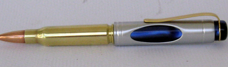

Gunpowder Pen
Don't try to take this pen through airport security.

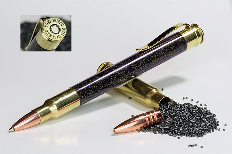

It's made from a 338 WinMag shellcase, 338 caliber solid copper bullet, a fired (but undimpled primer), and real gunpowder. The parker-style refill extends with a twist of the bullet, which also unscrews for replacement. The belted case-head is one piece -- the clip extends through a slot cut in the brass.
I hope you like it,
Eric

Thats fantastic! Is that nitrocellulose cast in clear resin? I'm assuming very little catalyst so you didnt get a heat problem:confused: which I would imagine would have made for a really exciting casting experience :eek:
Still looks really damn nice!!
WOW! Nice pen, but a little scary in the making of it.
Way back, when I was around 15, way way back....around 1966 .I got a casting kit for Christmas from Castolite Co. They use to advertise in the Popular Science catalog. Man, I started casting everything! I cast a .22 bullet. Later, I got to thinking, man that stuff gets hot when curing! Fortunately, nothing happened. But still, if someone dropped it and fell just right.....
Ummm, you turned gun powder!?! :eek:
Yep!
I used Vihtavuori N160 (a slow-burning powder used for several calibers including 338 WinMag) which is a single-base powder composed primarily of nitrocellulose. I didn't cast it. I glued the powder to a brass tube, turned it smooth, and then built up a thick CA finish over the top. The glue did get hot while curing, but not hot enough to ignite.
I'm glad you liked it,
Eric

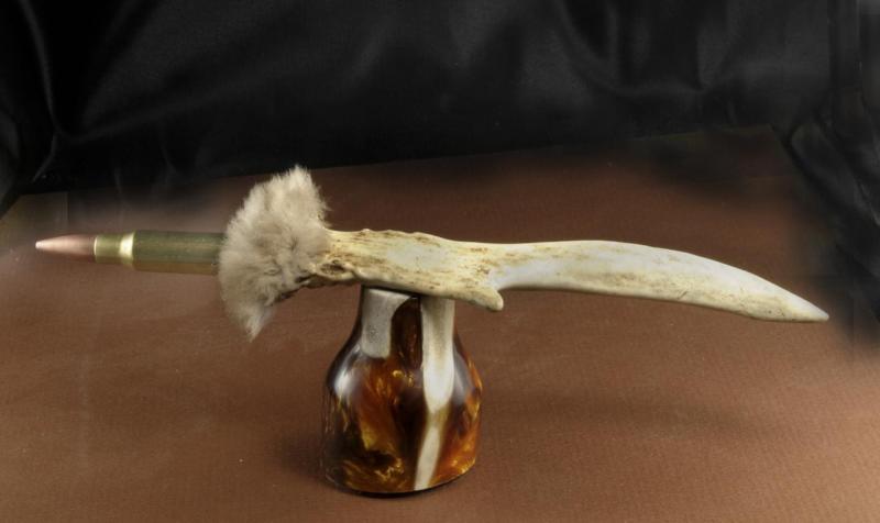

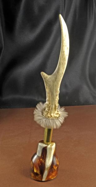

Ernie: We haven't know each other very long and I don't know if you hunt? I don't know if you've ever shot a .308 , but I was pretty da@?&$D sure I could get your attention with Beaver! The base of this desk pen is cast antler with Gold and Bronze, the cartridge is once fired .308 Win, and the top end, obviously, is deer antler from about a one or two year old!!! AND Oh, YES! The furry band around the middle is Beaver fur!

Looks good Joe. Of course I hunt Bambi, i'm from KY remember:biggrin:. I take 2 weeks vacation every year so I can stock up on summer sausage, deer jerky, deer meat to last the year.
