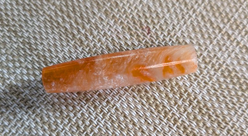

1st time casting, criticism welcomed
TN_Eric
Aug 6, 2024
49
East Tennessee
Equipment:
California Air Tools pressure pot, 2-1/5 gal
Alumilite Clear Slow, 2 lb kit
Temp prior to colors, 105 after mixing
Temp after colors, 104 after mixing
pot time, 5-1/2 hrs at 50psi
HDPE Block Mold with Stoner mold release applied, mold rack with top cover to deflect air. Bottom plate in pot and pot leveled out.

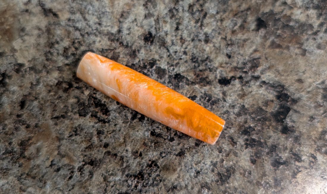

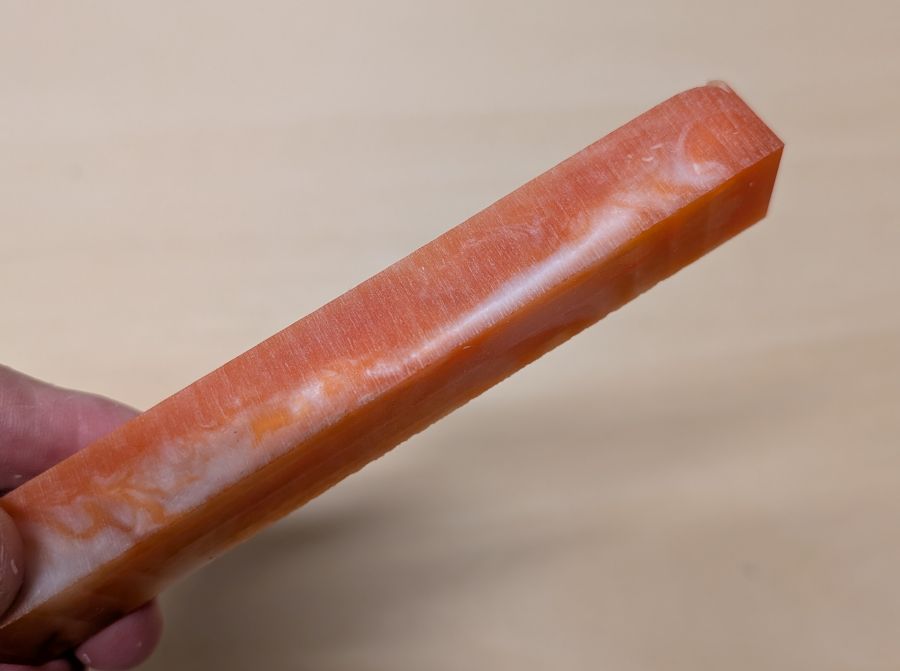

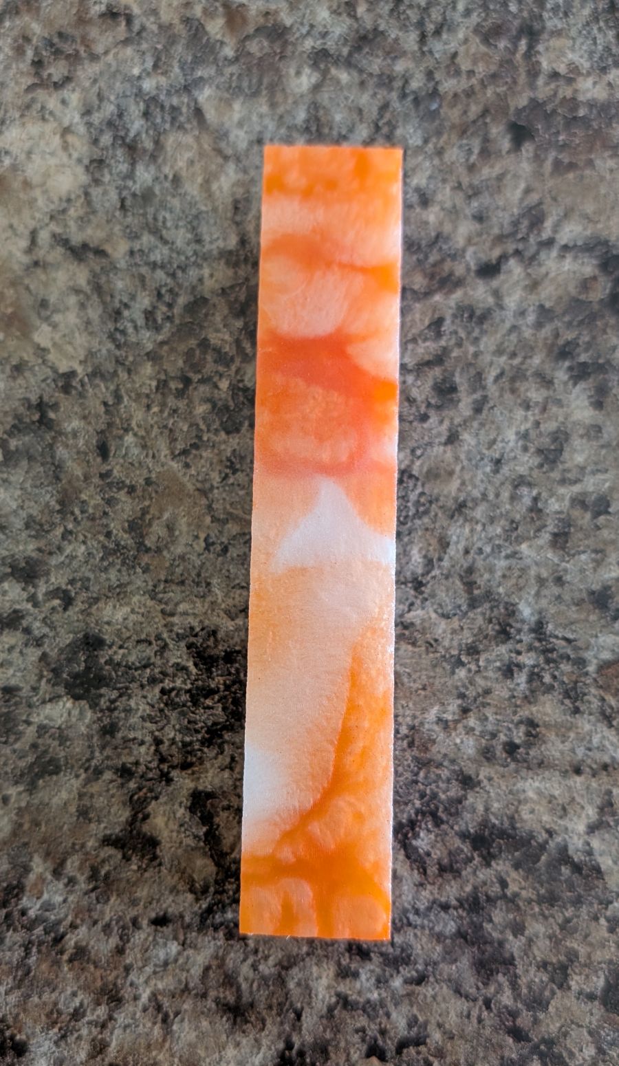

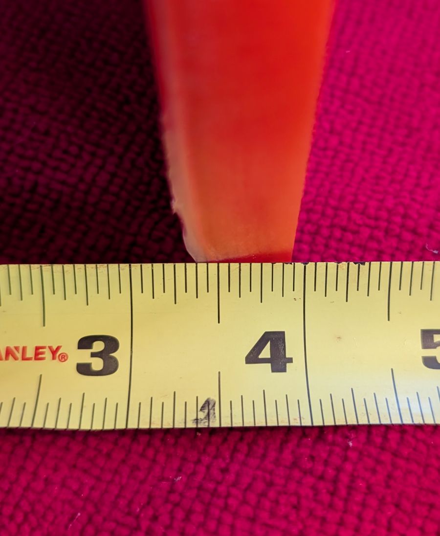

Finished cast sat over night before cutting. The block wasn't at 3/4 inch thick as I had wanted because my mix cups weren't large enough. After I cut 2 sticks off and trimmed the ends to 5 inches they were good enough for a slimline blank. I cut 2 out of the blank for slimline pen tubes, drilled, and one tube I painted white (still setting up), the other was just the brass.
Turned the brass one to profile, cut really smooth and finished good with CA. 400, then 600 grit dry sand, 0000 steel wool, then wet sanded with micro mesh.
Gluboost CA orange, then blue bottle each 5 coats, and wet sanded again, then polish.

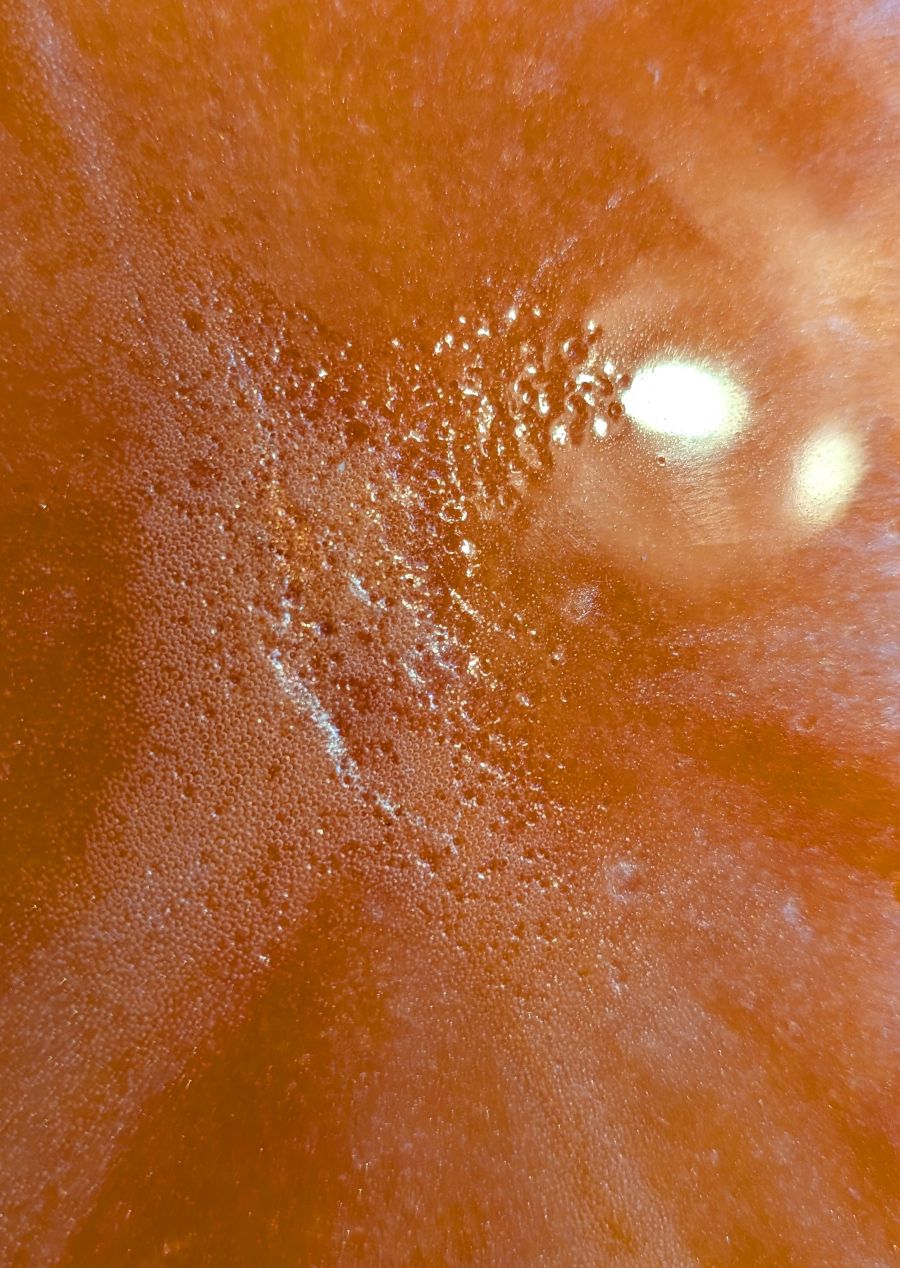

When I saw the "bubbles"? on top in the center I was worried but there were no bubbles I could see in any of the blanks. I have a half bottle left of the alumilite
and will do another cast just clear and see if it happens again.
I did forget to use a pop stick to draw lines thought the cast before going in the pot but will make a checklist next time.
Don't think you need much criticism. that's a nice blank, esp for a first.
Only a couple "observations".
First, my experience (very limited) says to wait a couple days before trying to turn a fresh blank. Even though "cured", they still seem rather soft.
Second, when I get around to turning after a couple days extra time, I've never needed any CA finish. The stuff polishes up nicely.
Anyhow, well done and thanks for sharing!

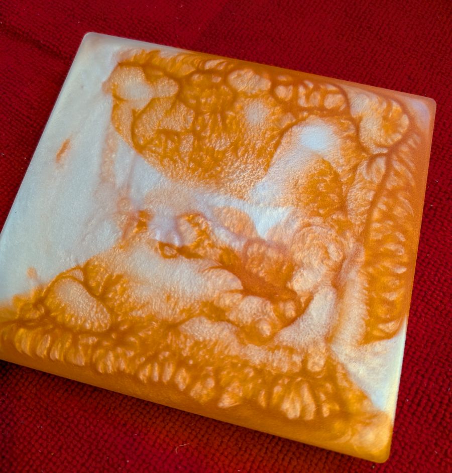

No criticism other than the lack of Royal Blue in the blank and too much white, those creamsicle UT fans should eat those colors up. Go Gators!! Also it might help to maintain color separation (if that's what you're attempting) if you preheat your mold prior to pouring. Great first pour, here's to many future ones!! Good luck!!
You did good! I dont see anything wrong either. You have some options… pouring while alternating colors (like you did), dividing a cup with a piece of cardboard and pouring the colors in on each side of the divider to pour both colors at one time, letting the resin temp reach 110-115 before pouring will govern more color separation but you will need to pour and chamber in pot quicker, placing a couple sticks over the mold and pouring over them with your alternating colors to give more character, and you can change the character based on your color ratios and how high or low you pour it from along with heavy or light streams. Also, don't get hung up on stiring with a stick after pouring. It's not always necessary and sometimes just blends your colors if the resin isn't hot enough yet. You'd be surprised at how much character you add with gravity by pouring over resin in the mold. If I stir, I use a wire and remind myself not to over stir. Also,,, I always apply CA (Gluboost) over resin pens. The CA is harder than the resin and will hold up to wear and usage much longer, along with brightening your colors.

Coming from you John was great, thanks. I've watched several of your videos on casting, along with a few others. I may attempt to do the Alumilite White, and just add my color of choice. I'll watch that video again prior.
Thanks again for the comment!

Alumilite white doesn't give you much time. I use Alimilite clear slow and I can get 10 minutes of time from mix to pressurize. As you pour more, you will learn that temp is an indirect measure of viscosity which determines how much the resin has set. The hotter it gets, the more viscous it get. I pour 8.75 x 0.75 round vertical molds. Vertical blankx are much less waste.
Great job on your blanks. I have as much fun pouring blanks as I do making pens
