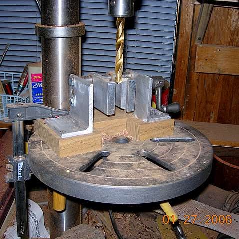

Actually I have a simple mount. Screwed it to a piece of 9"x9" plywood via 1" wood screws and clamped to the table. Haven't quite figured out exactly how to set it so that it drills in exact center on different size blanks yet but I am sure it will come to me at some point.

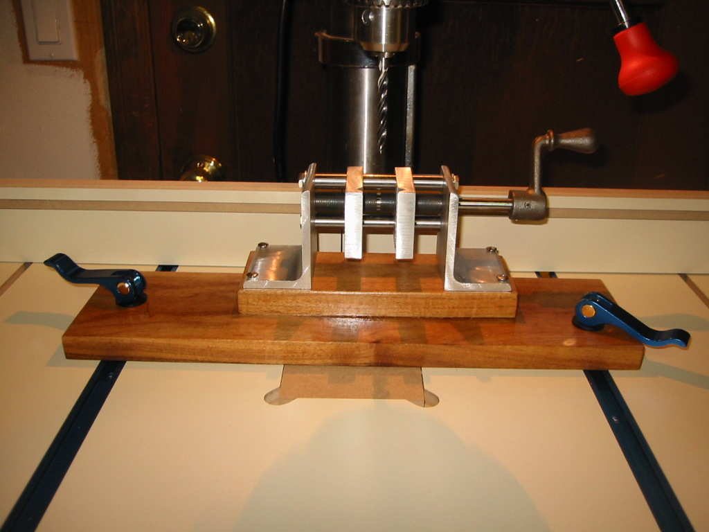

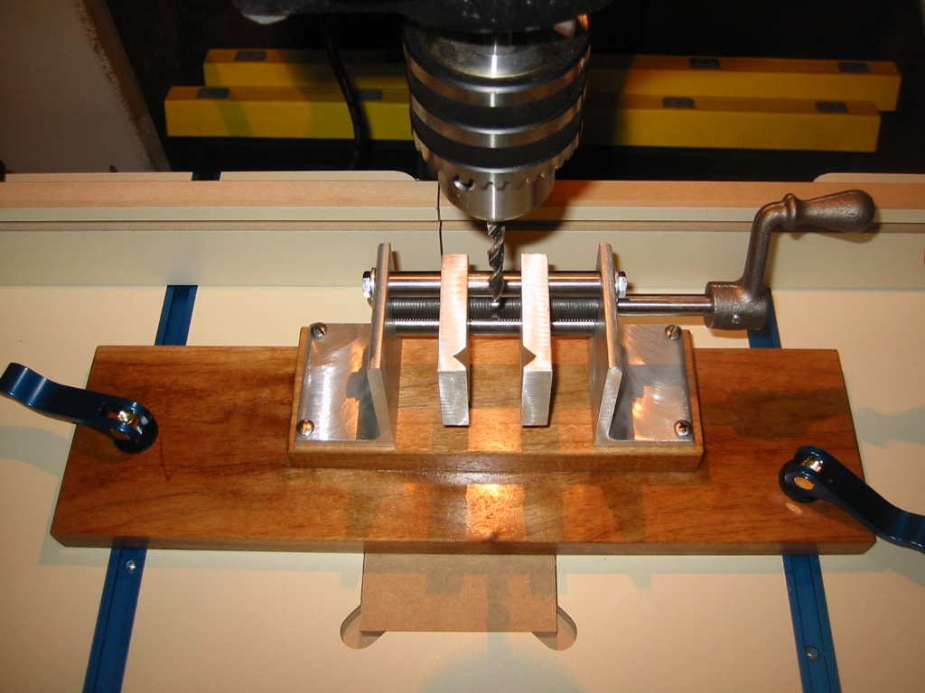

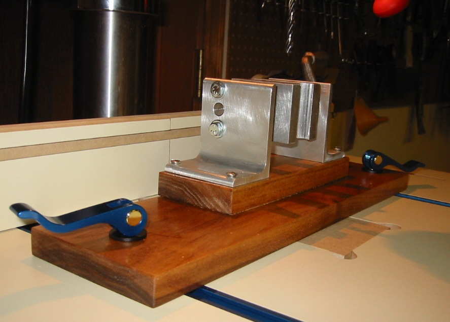

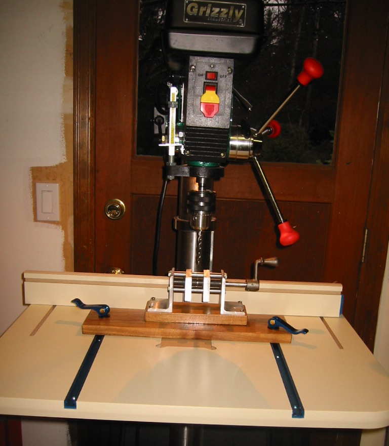

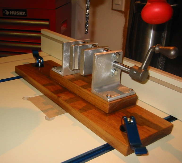

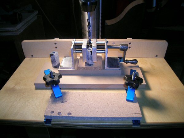

Here's what I have set up. I told you guys I was a mess.
I took some 1-1/8" sapele scrap and cut out a place for the long blanks to poke through and through which I can remove the drilled blank. I can also put in a back-up board, so that blanks don't get blown out. I won't win any awards for neatness, but it does the trick. I love this vise. Paul does awesome work.
<br />

Ron,
I'm glad you got your vise. The vise drills in the center either way, because of the way it is set up. I have drilled stopper blanks in it and they are still on center. If you draw a line between opposing corners, where they go into the vise walls, that is your center line. No matter how big the square is (as long as it fits), your center doesn't move.
