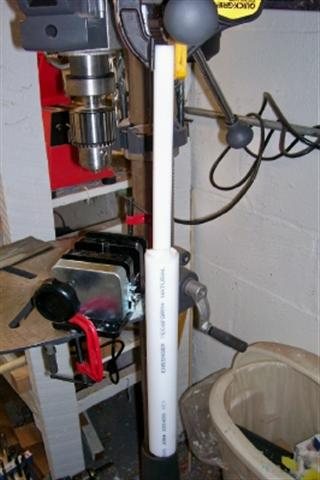

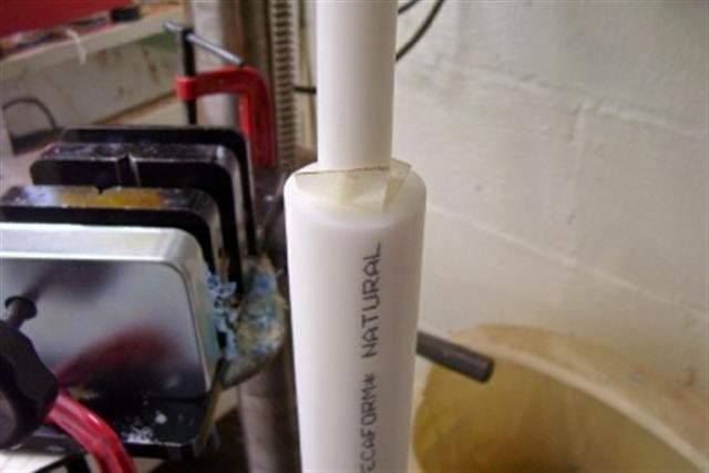

I agree, when it comes to glue, there is nothing that is going to work, but Here are two pieces of delrin held together with a small piece of heavy duty double sided carpet tape, these pieces have been hanging for over an hour, the bottom piece is 1 1/2" OD x and the top piece is 5/8" OD, both are 12" long. I am not sure how much the 1 1/2" weighs, maybe close to a pound, but if it can hold that much weight for over an hour, I bet it can hold a little piece of delrin to the bottom of your ram. I use this stuff for everything. [:D]
Hope this helps.
<br />
