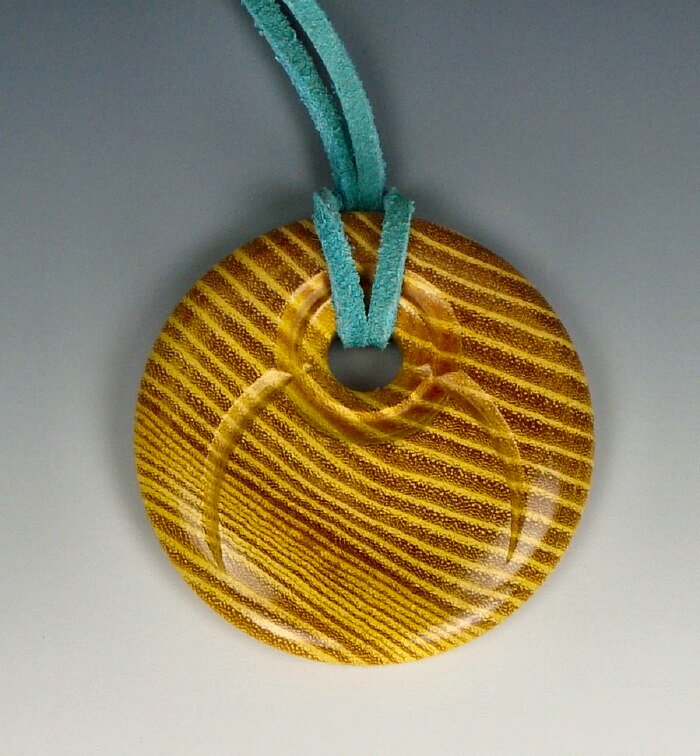

OK, I'm in - SHMBO demands pendants. Here's number three - osage orange with a little offset embellishment, using the Joyner backer plate:

Nice pendant -- I really like OO...
I posted in the help forum a question about what tool to use making grooves.
I understand the indexer.. I assume the first posted pendant was using the indexer?
What tool ? presented how (angle etc.)
mine looks like jumpy train tracks. can't keep it in the same groove.
using sharp very pointe small bowl gouge on corian.
paul
YoYoSpin
Feb 6, 2004
1,334
Colorado Springs, Colorado, USA
Paul,
For the pendant shown in the photo below, first turn in round and sand completely. Then offset using a new backer plate 3/8" x 16tpi hole and drill/finish the necklace hole. After that's done, re-index the secondary metal plate 180 degrees. Finally, using a skew, gently plunge the point into the piece where you want the "horns" embellishment to be.

Thanks -- I like the embellishments better than the plain disk..
I will give it another try -- maybe another and another until it look decent :)
