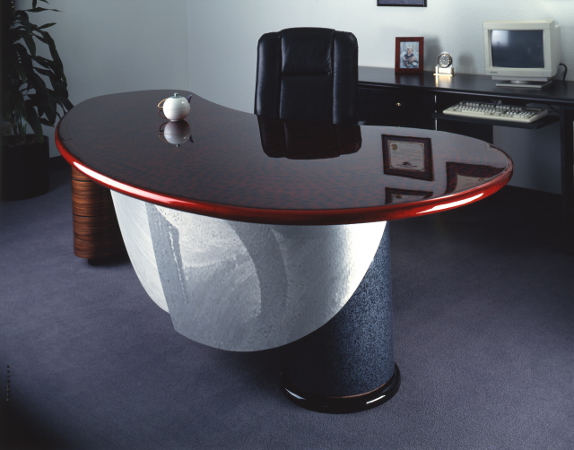

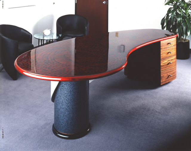

This is a cool desk that I built in 1991 and then again for a few more customers in 2003 and 2004. The top has a tourtise shell pattern carved in it, then it was gold leafed, antiqued, sprayed with candy apple red lacquer and poured with epoxy. Modesty panel is 1/4" aluminum and is the structural element that keeps the top from sagging. I used an angle grinder to carve a beautiful "hammered" finish in it.The overall length of the desk is 9' and the large end is 48" in diameter. The drawer cabinet is all bent, laminated 1/8" plywood with rosewood veneer.

Well I don't have a closeup photo to post, but in short, by holding the grinder at an angle, you can quickly grind small dimples into the surface. With practice you can get them uniform in shape and size and make a controled pattern. I have already told you guys 98% more than i would have revealed about the process 20 years ago. Back then, if told you this much, I would have had to shoot you.

That's just unbelievably awesome. I love the blend of textures and colors. Definitely something to build a whole room around rather than the other way around.

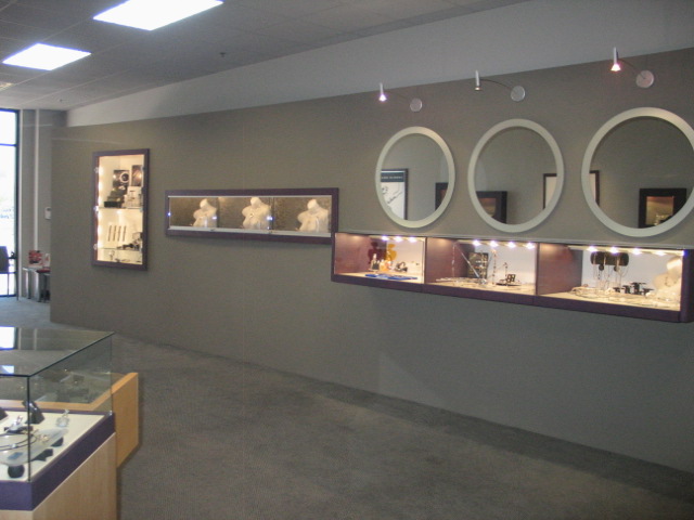

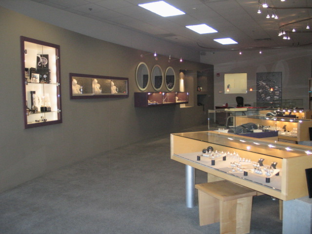

Actually, an entire retail jewelry store was built around one of them and I designed and built all that as well.

As an ex-cabinet maker, I know what is involved with such a piece and with all due respect to everyone, the hands that produced just a magnificent and modern piece, will be able to make the most difficult pen there is but, and I'm sorry folks, there are not many great pen makers that have the capability to produce such a piece, there is the best craftsmanship, creativity and attention to detail, one can achieve...!
Well done mate...!
For a piece made 20 years ago, that was a type of sophistication that was well within a hight society elite...!

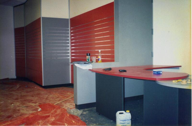

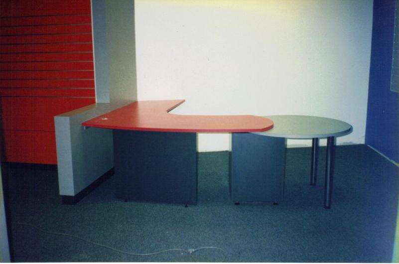

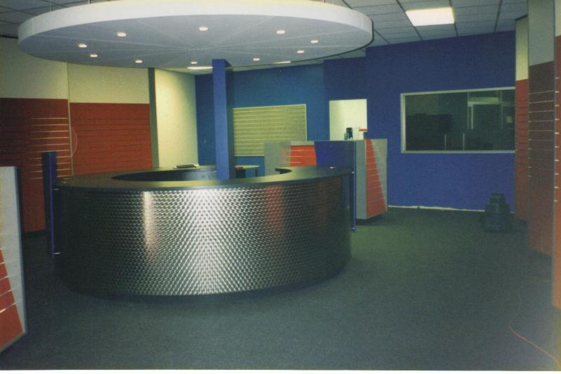

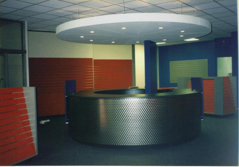

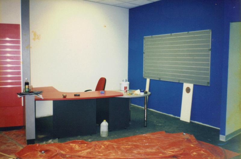

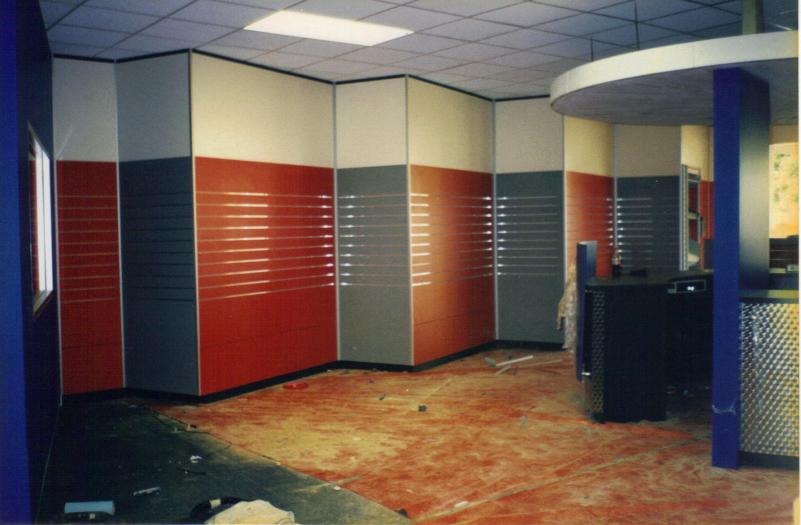

I found them...!:wink:
The old pics are starting to get all yellow(ish) so I may have to scan them into the computer, as I already done with hundreds of other old pics...!:frown:
I didn't know that the desk was part of a shop fit-up but, seeing the other pics you just posted, it all makes sense and certainly, within the high society level of things as these shops normally are...!
My pics are not here to compare anything nor to take credits from anyone, the desk from the OP, was what brought this old shot fit-up I done many years ago, nothing more...!
Materials and colours where a shop owner specification, execution and fitting was mine...!

Very cool, George. I can see there was a lot of detail in that job.
