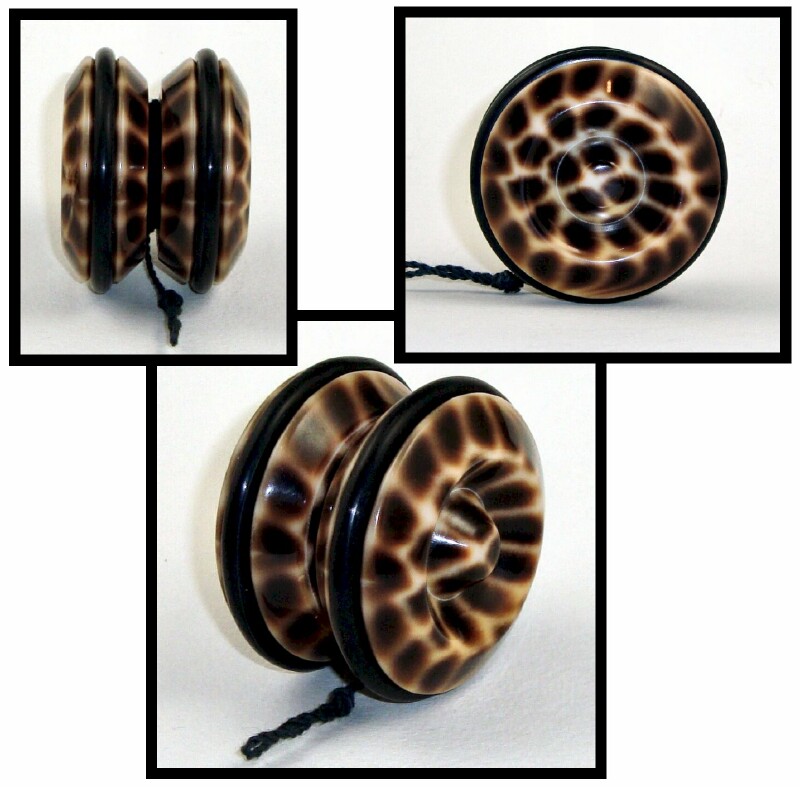

Here's a couple of new one-piece (no glue holding the sides and axle together) old school yo-yos, made from new school materials - Ed Brown's (the other Ed) imported resin rod.
Tiger Cat...
Leopard Cat...

ED, I think these are great also, but my favorite is the zebra. I got to ask thou. What material do you use on the outter edge that is solid black and how do you attach it? I am wondering cus I have been thinking of trying some spinning tops which would be made the same way.

Keith, I think they are o-rings around the edges. Stops the yo-yo from smashing when you 'walk-the-dog' and other tricks. Heck, that brings back memories !!!!:eek: Do you guys remember when the Coke and Fanta guys went around promoting yo-yo's ?

Yes, those are o-rings, size "-132", measuring 1-3/4" ID x 1-15/16 OD x 3/32" wide. Normally, common plumbing "Buna-N' o-rings (cheap) will work fine, but in dry climates, the rubber will crack and eventually fall apart. It averages around 20% humidity here in Colorado Springs, so I use a better grade o-ring called "EPDM". They can be purchased here: http://allorings.com.
You can also get a variety-pack of really cheap o-rings at Harbor Freight.
