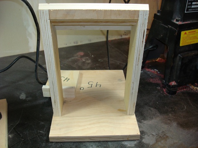

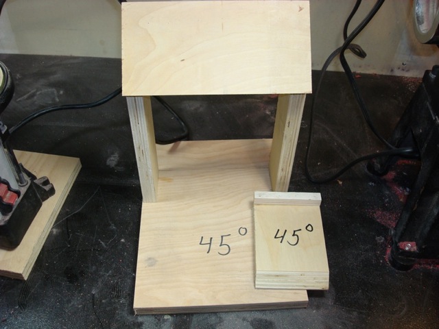

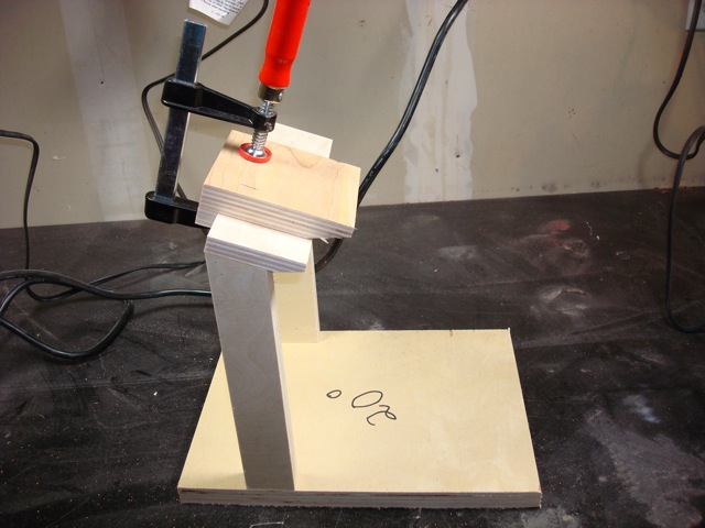

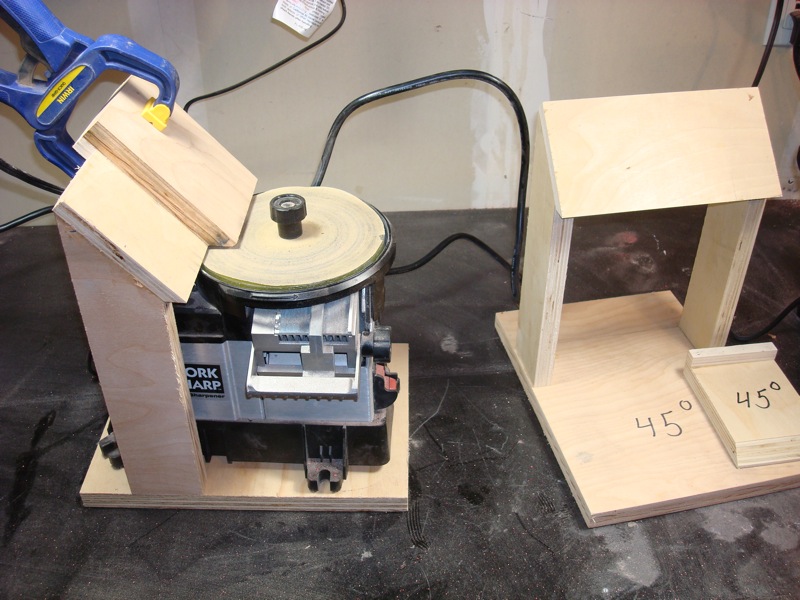

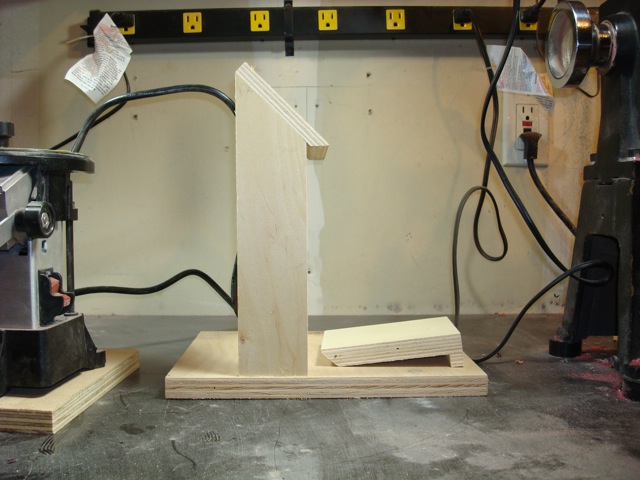

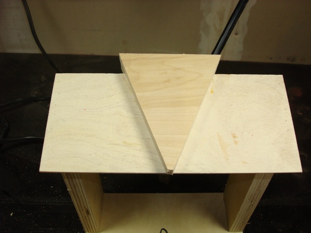

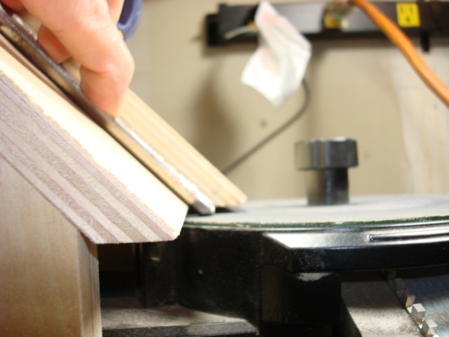

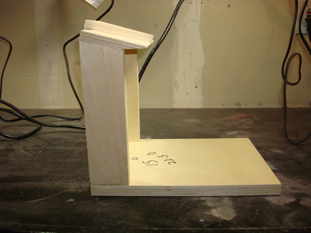

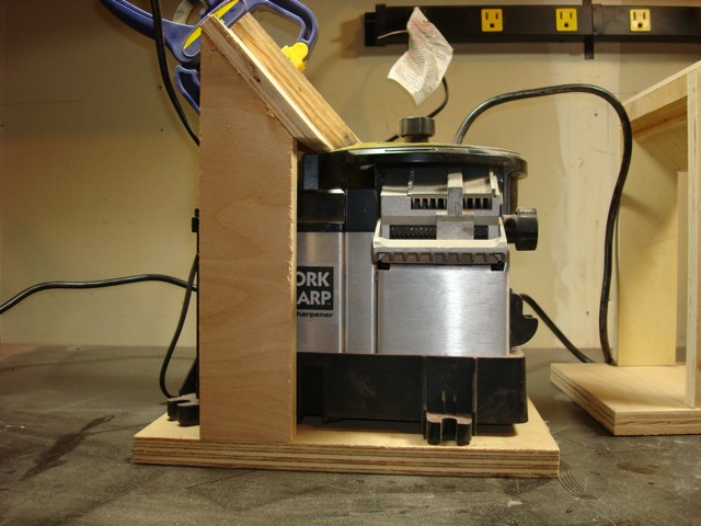

Here are some pictures of the jigs that I have made to sharpen turning chisels. The WS isn't fastened down so it can be moved around to use all the sandpaper. I use loctite spray adhesive #100 and buy my sandpaper at the local hardware store. The bases are just large enough for the sharpener. It is important to build in some kind of brace so the jig doesn't rock when sharpening. The gouge does catch a little when you start to turn into it, not sure what the best way to solve that is and I just live with it. If possible I would make the tops a little longer on the short ones so you have more space for the clamp to hold the guide down. I used 3/4" plywood because I had it on hand. I think thicker wood the better to help with stability. If you have any questions or ways to make these better please say so. Thank you.

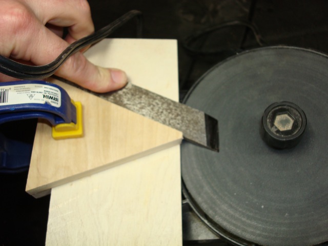

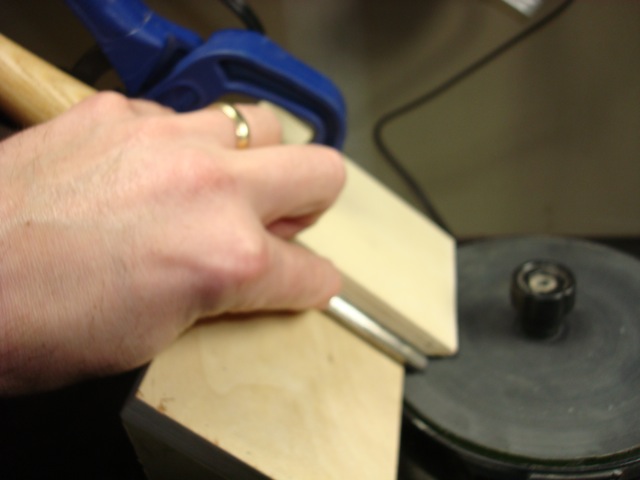

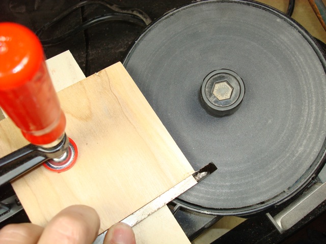

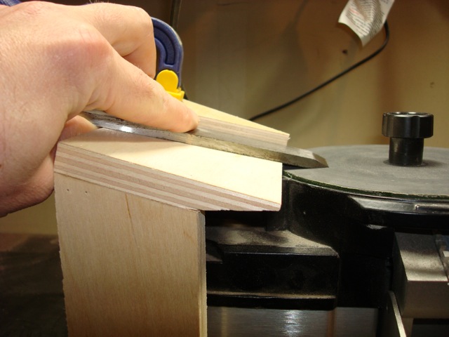

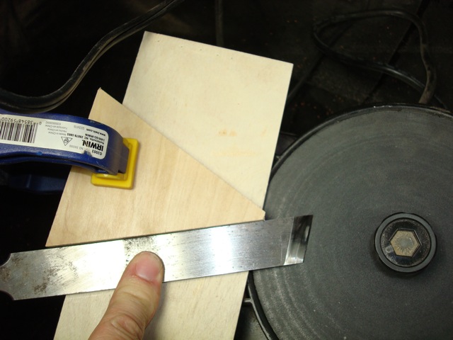

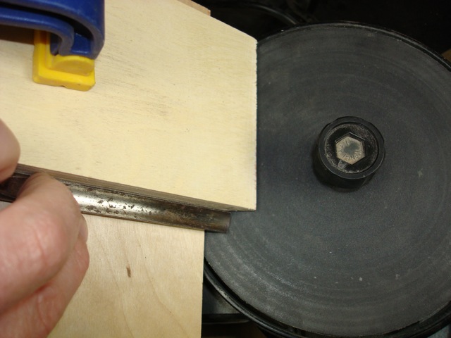

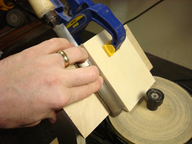

These are some pictures of the tools on the jigs. The height of the table above the wheel doesn't matter it just moves the tool further out on the wheel.

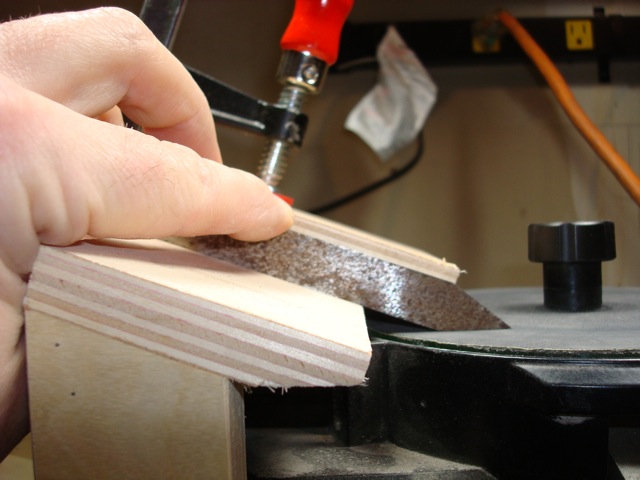

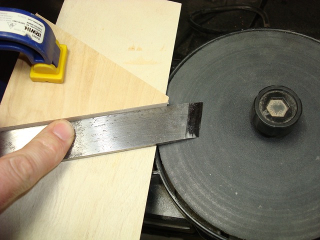

And the skew. You have to flip the skew over and use the other side of the guide to sharpen the other side.

I use mostly 320 or 400 grit. The first time through you may need to use coarser paper. If you have a lot to grind the tip of the tool can get hot. For the most part I just use regular sand paper. And now I formally give all of you permission to copy and improve on these designs. :biggrin:
