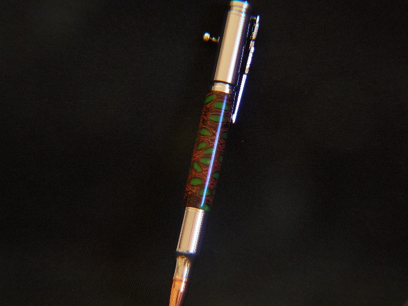

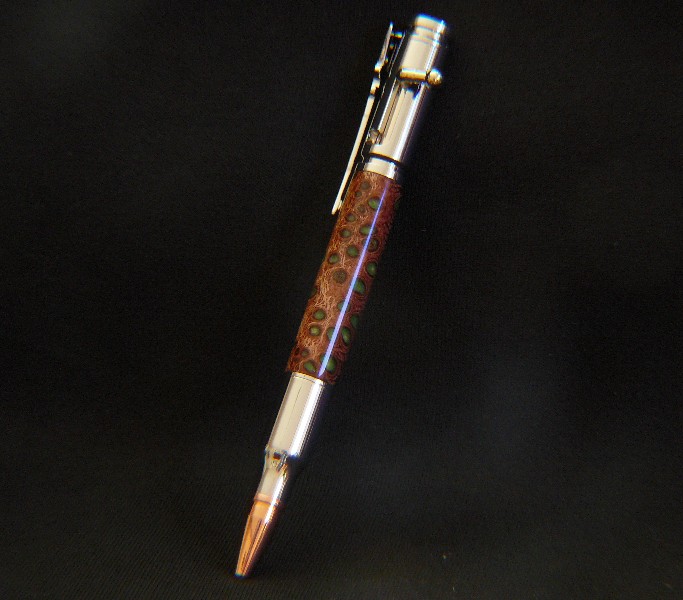

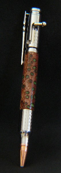

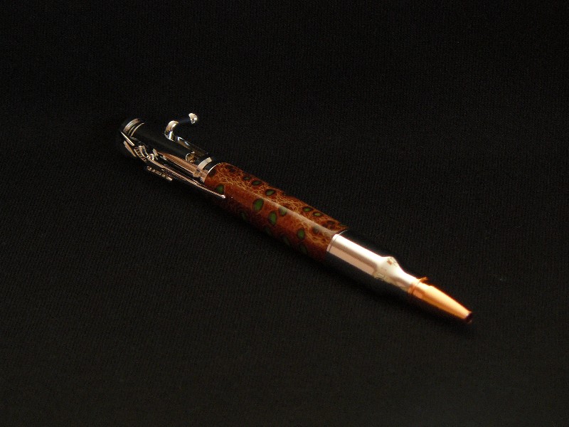

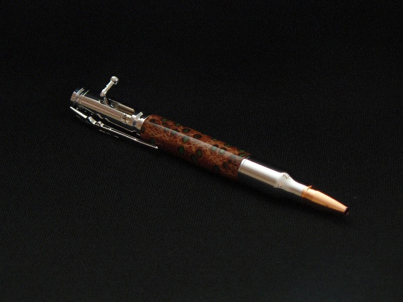

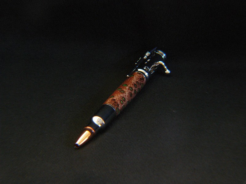

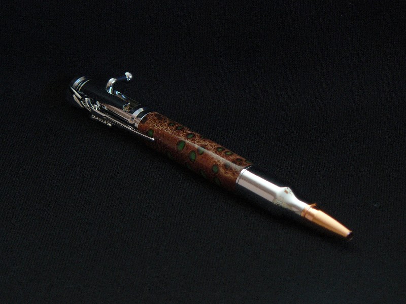

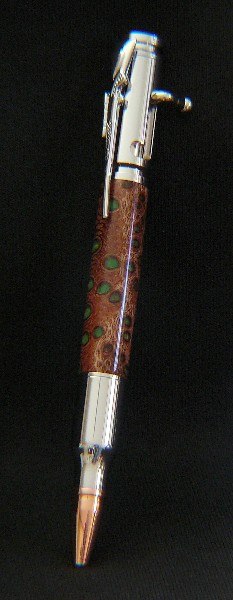

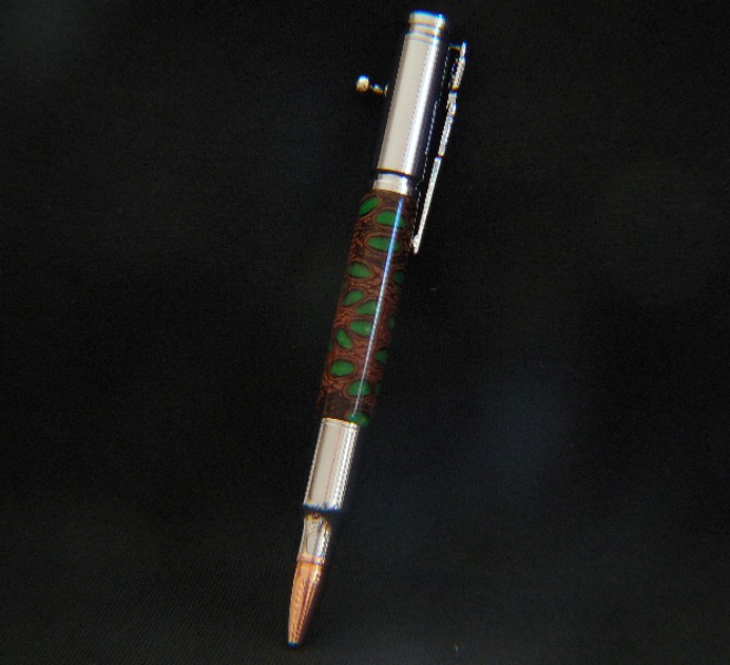

This is a banksia pod from George's last batch. These things are FANTASMICAL!!! SUPERCALIFRAGILISTICEXPIALIDOSIOUS GOOD!!!
Took me a long time to do. I took it very slow as the stories of messing up these beautiful blanks abound. I tried to use the flap disc as George suggested, but I didn't feel comfortable using it. I didn't feel I had the control that I wanted for such an awesome piece. I used a homemade carbide tool that I normally turn with. I stopped every couple of millimeters and applied super thin CA as suggested. You could actually feel the difference in the blank (by touching) when it was time to add more CA. The pod area would feel raised above the resin area and then I soaked again with CA. When I thought I had it turned down to size, I added CA again then turned it down to size again. Did that several times. Then I added 20 coats of medium CA, dry sanded both directions with 240 to 600 Abranet and 1800 to 12000 micro-mesh. Then wet sanded with 1800 to 12000 micro-mesh, a good coating of #2 Novis fine scratch remover and finished with the Rennisance wax. ME BE VERY HAPPY!!! I do think the blank was too good for the kit. I will have to find a better kit to fit the status of the blank on the next one I do.
Thank you George for the beautiful blanks. I am not a very experianced turner but I studied your directions and took my time and was GREATLY rewarded!!!:biggrin::biggrin::biggrin:

Hi Randy
Hahahahah mate, I only saw the pics after I read what you said, and I though that you were talking about the Banksia Hairy pods, as you described perfectly what that blank handling is about and confirmed by many that had a go at it however, when I looked at the pics, I didn't see what I was expecting, not that I was disappointed or anything, but these Dwarf Banksia pod Resifills I made recently, are fragile but not comparable to the Hairy Banksia one.
In fact, if you haven't tried the Hairy Banksia Resifills yet, you seemed to me more than ready to have a go at them, follow the same principles and a few other requirements that are specific to the Hairy Banksia pods, and you will be good, very good, indeed...!
I think you done a terrific job with those blanks, you attention to detail was most rewarding, no doubt...!
Keep up the good work...!
Cheers
George

That turned out really nice. I think kit/blank is beautifully matched. Your patience paid off. Don't know if my nose can stand the fumes from 20 CA coats. But well done.
Actually, the multiple coatings of the super thin CA while turning was tougher to handle. Have to have really good ventilation doing these.
Awesome work, Randy!
