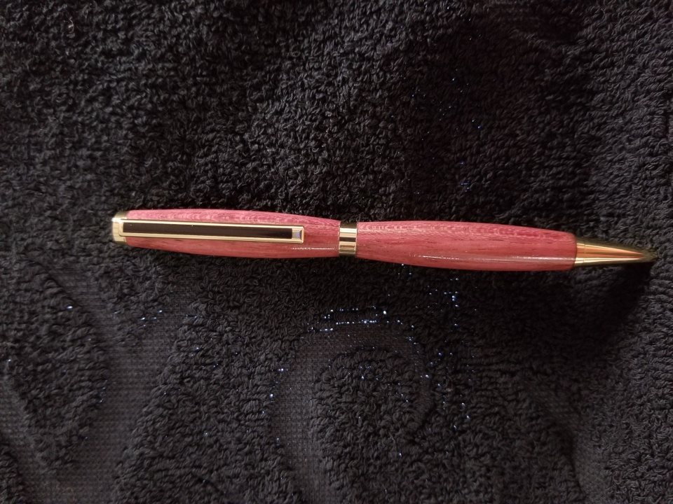

Thats all I was needing to know y'all. Appreciate the feedback. The shellac actually has a nice shine to it. Of course, I put 7 thin coats on it. Lol I have some wipeon poly that I use for my other turnings. I was actually thinking of trying it on my next pen. Btw, I think the CA finishes look great, but I tend to like the natural wood look myself. I may try a ca finish one day just to see if I can do one without messing it up. Lol

I think you will really like Mylands Friction Please in leiu of the shellac.
I actually have some WTF coming in. I read here that its good also. The shellac actually looks good to me. Its not an overbearing shine and still keeps a nice looking wood finish. I did this with purpleheart wood.

Shellac will darken from the moisture and oils left behind on the pen from handling and using. Most friction polishes are shellac based. Nice shine at the start but not so much later. Shellac or friction polishes are good for items that are not handled often. Just my thoughts...and others.
