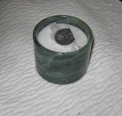

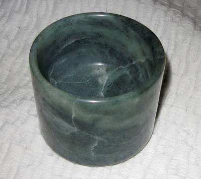

Missed my lathe while I was sipping wine at the ocean so I got busy this morning and started on my shaving set. This is what I have done so far on the soap holder. This is Soapstone. I have to make a jam chuck now so I can work on the bottom. I have the Knot to make the brush and the razor blank. I'm a little concerned how well the Knot will stay epoxied in the brush handle. I don't know if epoxy and soapstone work well together.
Not a fancy turn, but I'm new at this stone stuff so I'm going simple.

Put some thin CA in your soap stone, let it soak in a dry where you will be epoxing the knot. That will help fill some of the porousness of the stone, so it does not pull the moisture out of your epoxy too fast.
PaulDoug
Mar 2, 2008
3,488
Benton City, WA.
Paul,
Great looking soap cup.
Thanks for the input, I'll do that.

One thing I've found about working with soapstone. It is very difficult to get a real good shinny finish on it. I micro meshed this cup through 12k and still had a, not dull but I'd say saten finish. Went through it twice. To make it shine I used mineral oil. It even say on the internet to use mineral oil on soapstone. I want to try micro meshing it using mineral oil instead of water, but I don't want to ruin my MM.
Craftdiggity
Mar 10, 2010
1,373
Egg Harbor Township, NJ
Paul,
You won't get soapstone to gloss up the way marble or granite does. It just isn't hard enough. You've probably got it as good as it's going to get as far as a gloss goes unless to decide to put some kind of a finish on it.
