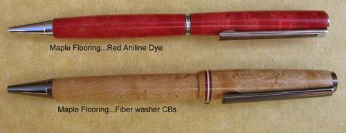

Here are some pictures of the last few pens I've made this week. Why is turning a pen more fun than doing the taxes? Take a look.

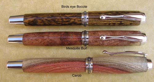

Don, I really like the Texas Ebony, Mesquite Burl and Carob pens, NICE wood. Of course, the others are pretty sweet too! How do you like the aniline dye?

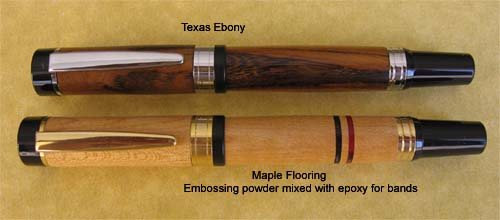

The pen mics at .556 on top of the bands and I stopped turning at at .635. Could have gone a little closer, I guess. Mixed the epoxy and mixed in the embossing powder. Packed it into the groove and left it proud of the pen surface. Finished turning.
The maple is not that nice, but the maple pens are for a local basketball coach and his son. The floor is from his gym that got a new floor last year. The red and black are school colors and the bands are where the customer wanted them.
The red one is from the gym where I teach. Our gym was destroyed in a storm last year. I found some nice BE and curly maple in our floor and salvaged about 500 ft before it went to the dump...70,000 feet of 1" maple to the dump. The aniline dye is nice and easy to use. I have other colors but have only used the red. Turn to finish, sand through 12000 MM, apply the dye with a Q-tip, hand buff(and dry) with t-shirt fabric and apply the CA finish as I usually do.
The bocote and carob are freebies from BB that came with my last order. The Tex. ebony was purchased on a recent trip to south Tex where it grows.

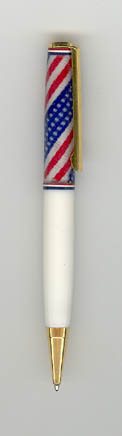

Here is the pen I turned last year to commerate the end of tax time.

I wasn't sure how many had seen the flag pen...april 04 was not long after we started IAP...
The flag is ribbon from Hobby Lobby, glued to the tube and cast in PR. I got it a little smaller (the top) thanm I wanted. And the pen is shorter than normal and I had to grind off the refill so the pen would function properly, but it is in my own collection. The ones I've made to sell have looked better, proportionally anyway. I always keep the first "custom" pen for my own collection. Have a great weekend.
