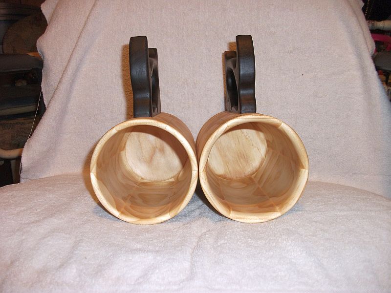

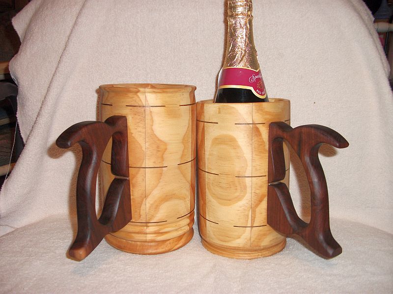

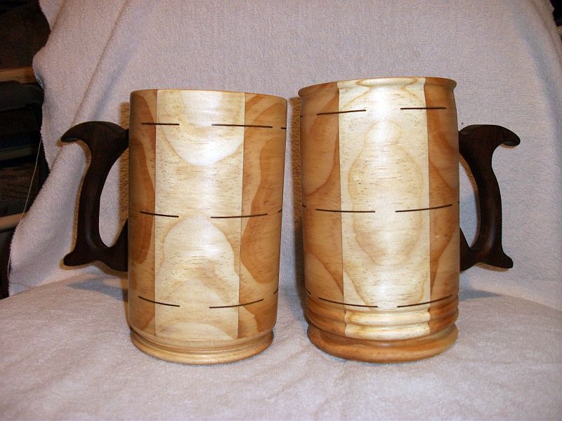

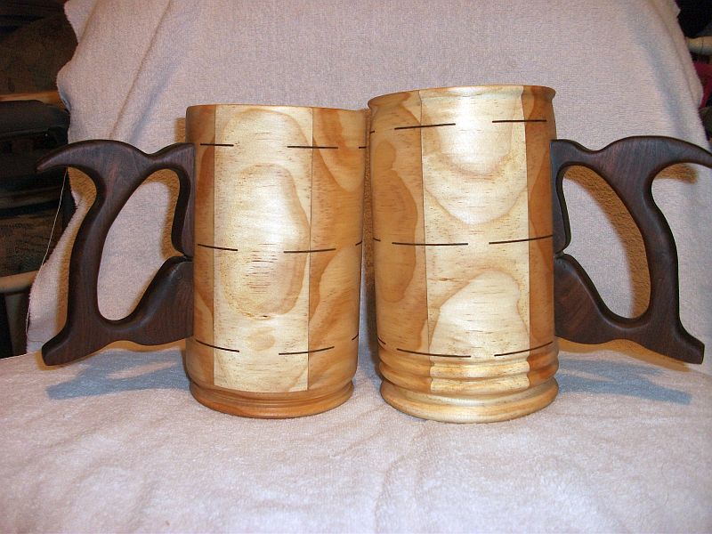

Hey fellas, I made a couple mugs out of pine and walnut. the mug is end glued and splined with shedua with a one peice bottom.the handle is walnut , I profiled it off an old disston handsaw.One of my coworkers asked me if I could make a cup to drink mead from that he's brewing.I said sure I'll give it a try, how big do you want it?

Hank, one started off with a coat of BLO, other than that the same routine was used on both.
sanded to 220 on the handle,320 on the mug.Applied a heavy coat of antique maple gel stain,worked it in good.3 generous coats of mineral oil till dry on the inside. then 2 coats of butcher block cond. leaving till dry all over. I took the pics too soon because I'll also apply 2 coats of soft wax on the outside.

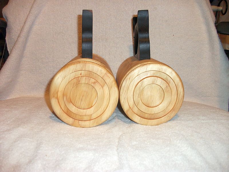

Welp,looks like I posted my work before I should have.Failed the water test(frowney face).Looks like the bottom soaked it right in,sweelld outward enough to split a joint.The other faired better and only split the bottom,staves still tight(still,frowney face) though.Gonna try and epoxy coat the inside,see if one of them is savable.Dunno at this point.
Hmm, I wonder why the bottom sucked up so much moisture? There's no end grain there, to soak up more than the sides. But I suppose that it shouldn't surprise me all that much, it is made out of pine after all. Some type of resin will do the trick, just make sure, that you remove any wax you used. I do hope that you try to save them both, let them dry for a couple of weeks. Then have at'er. They do need to be well dried, to use any resins for the fix. Or, you could end up just wasting your time and the resins or epoxies.

Thanks for the tip, I'll keep that in mind for the future.I have been in the process of refinishing them with envirotex lite pour-on epoxy.I just did the water test on one of them and it passed.I will post pictures of them again when I get both done plus a smaller walnut one.Took about a week to get two coats on due to cure time between coats.
