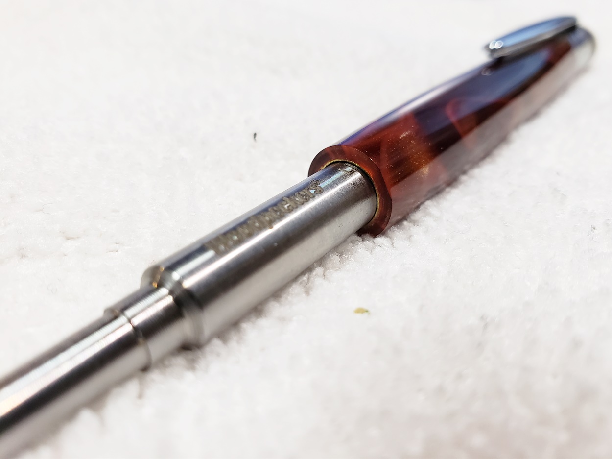

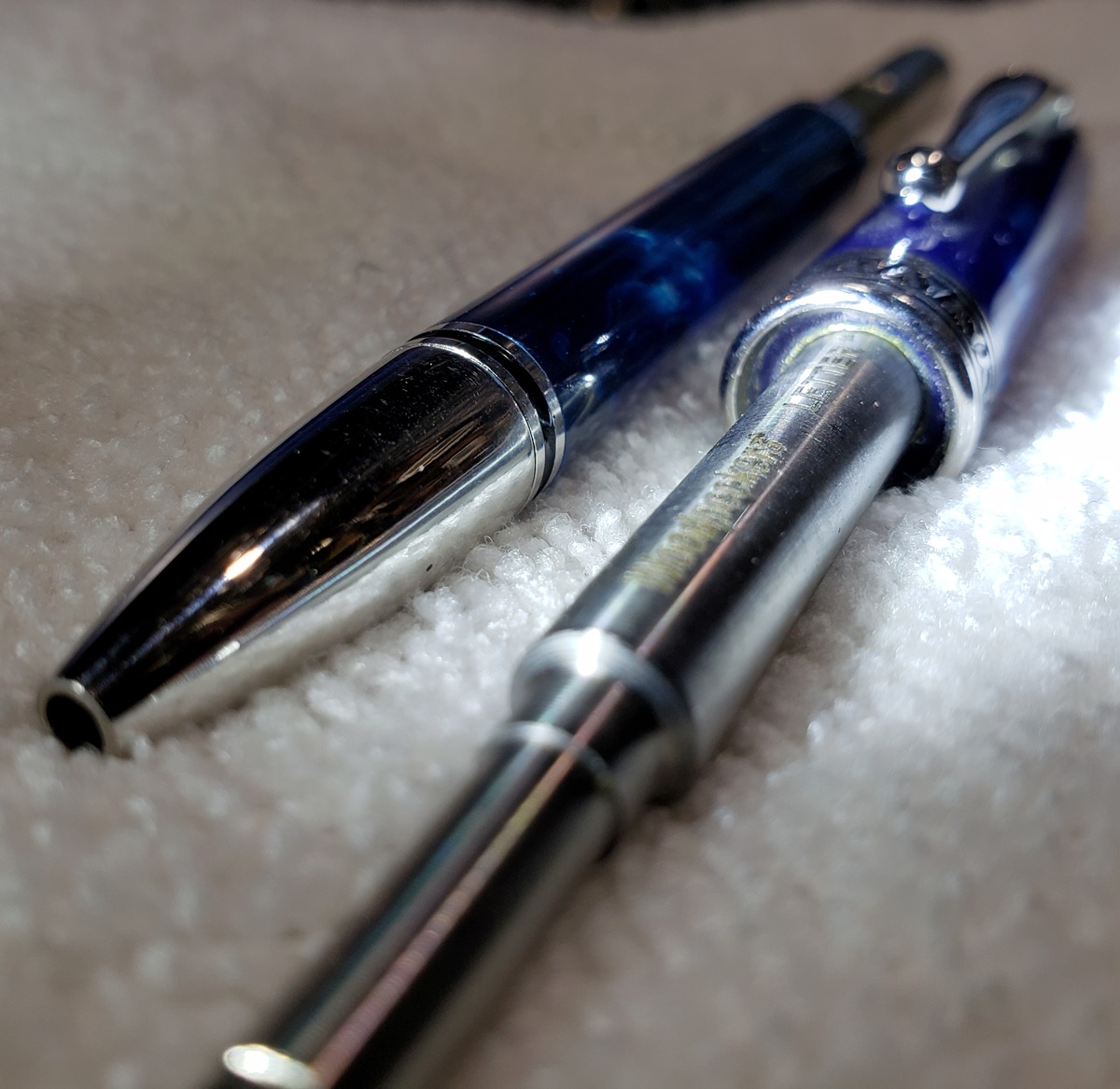

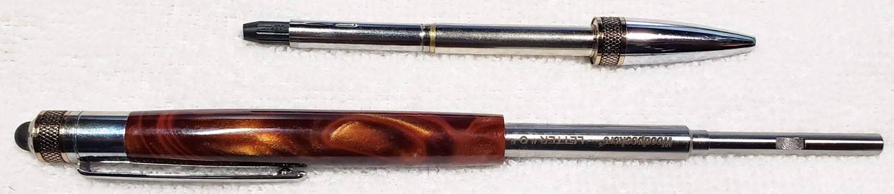

i posted a picture of 2 pens I made using the Ultra-Shear and they used 8mm tubes. Duraclick EDC from Penn State. It fit perfectly. I just chose the next one up from the 7mm and tried it in a spare tube to make sure it was correct.

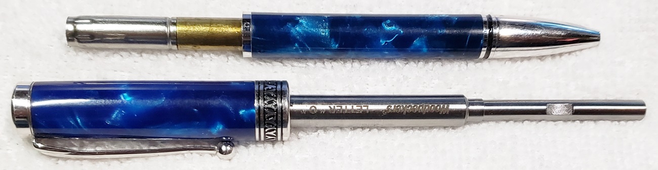

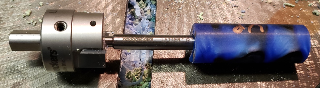

I picked up the pilot from Woodcraft today. I was able to see if it fit in an Americana pen (letter O) and a Cortona (8mm). It fits perfectly in both.

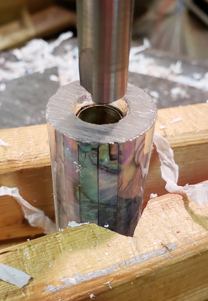

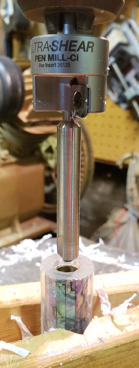

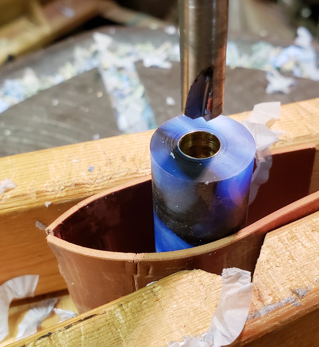

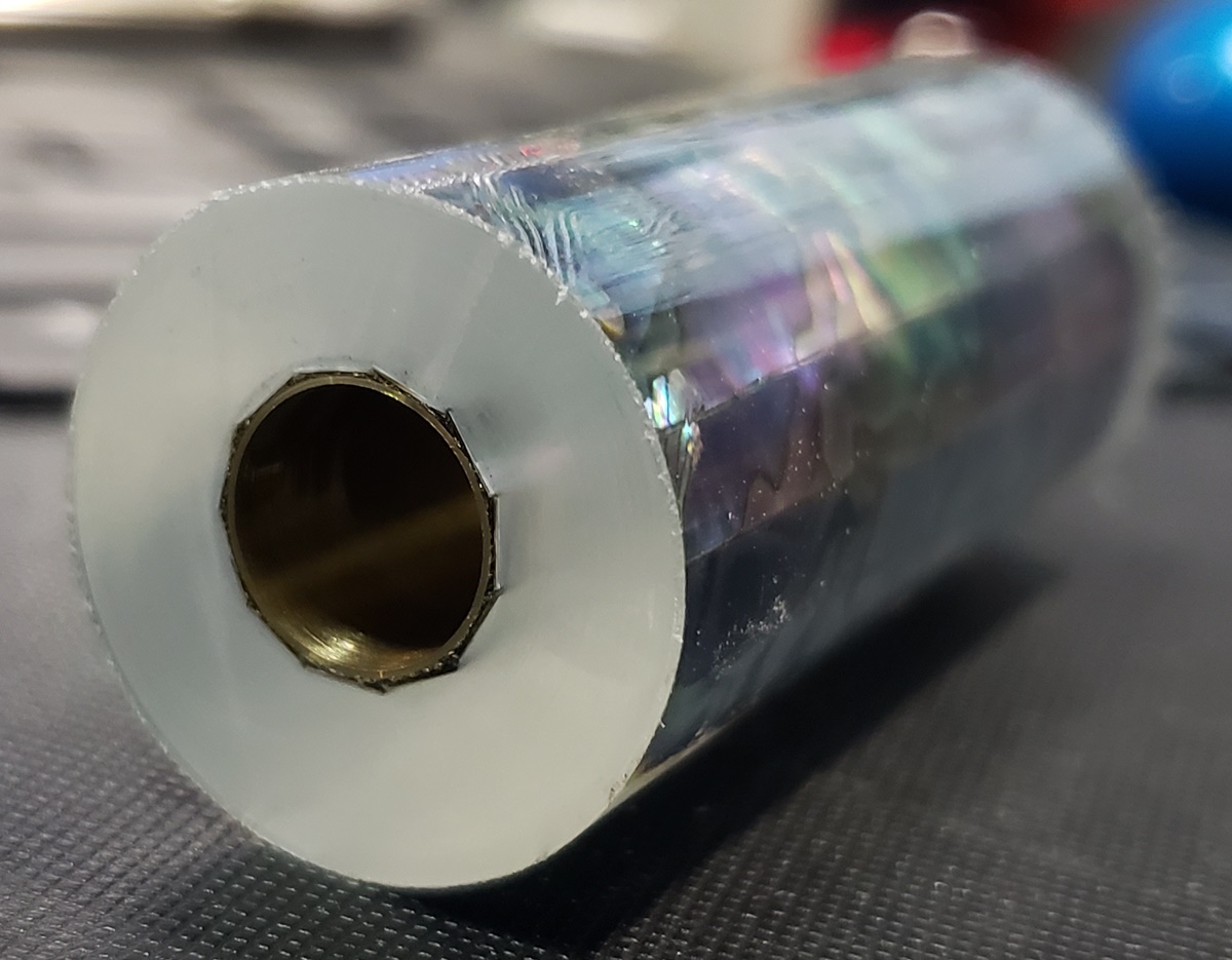

I bought the 13 piece set from Woodcraft last year. I turn quite a few antler pens, I've never seen anything cut through the antler like the Ultra Shear does.

I actually found a company that has an 8mm pilot. I do not know if it will fit into the Woodpecker Ultra-Shear or not. going to pick one up today if my Woodcraft has one in stock. If the 8mm pilot will fit I will post the info on the place that I ordered it from. I have a complete set of pilots for all of the standard pen kits and it would be great if they will fit the Ultra-Shear cutter.
The design of the Ultra-Shear pilots is different, they have a cut down shank. I don't believe pilots for other pen mills will work.
Unlike all others on the market, the Woodpeckers Ultra-Shear Pen Mill Ci is driven by the MILL HEAD and not by the shaft of the reamer. This allows us to reduce the shaft size (to 3/16") and set the carbide inserts closer to centerline of the mill head so that we completely mill the ID of 7mm slimline tubes, without the annoying burr of brass common as a result of others on the market.
Unfortunately, this also means that other brands of Pilot Reamers usually do not fit the Ultra-Shear PEN MILL head.

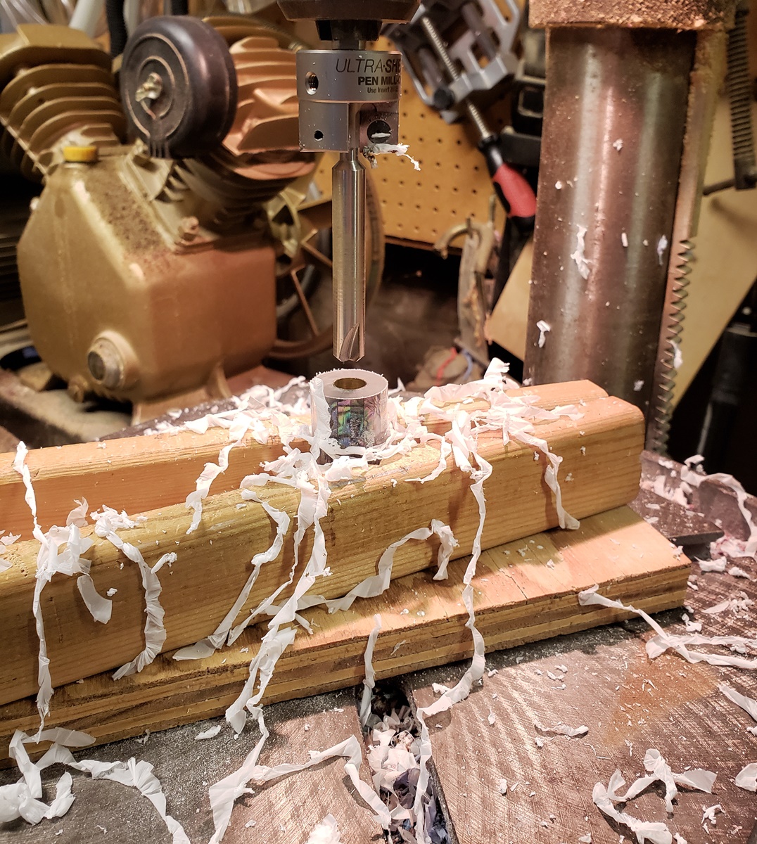

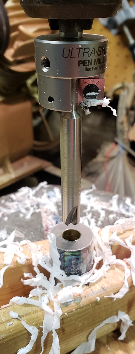

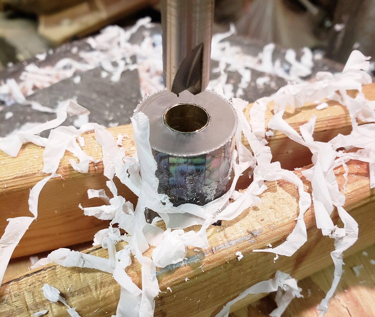

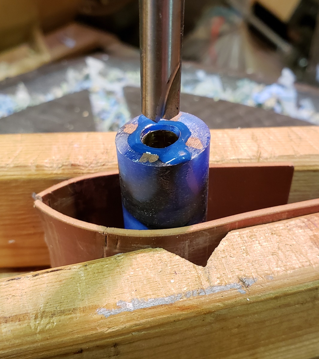

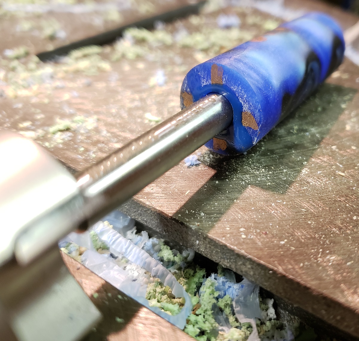

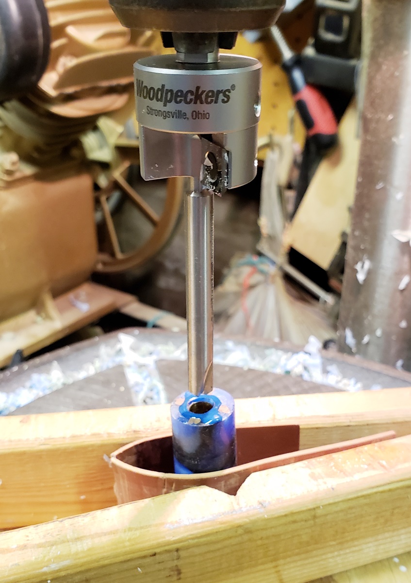

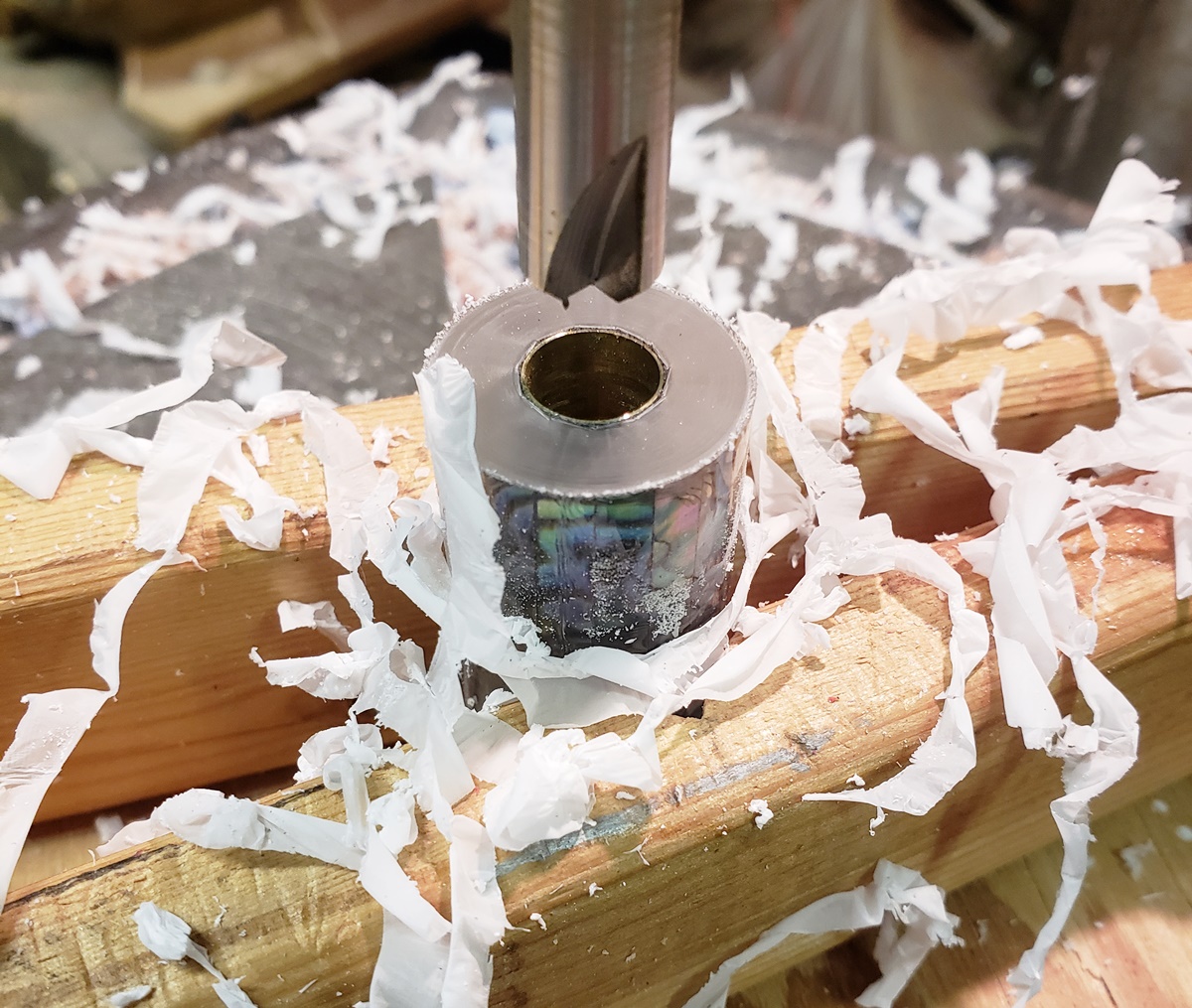

It fits 8mm tubes just fine.
