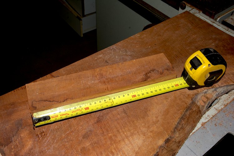

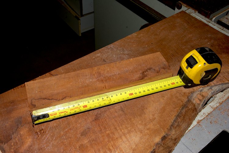

When I decided to make some more spatulas, I found a piece I had cut off the end of a slab, it is 28mm ( 1 1/8") thick, which is good for fairly straight spatulas, if you want to put more of a curve in the blade you will need thicker timber.
For this batch, I cut blanks to 300mm x 75mm x 28mm, (12" x 3" x 1 1/8")
attachment.php
I won't quote handle diameters or lengths, as its a personal thing, make them to the size that feels good to you.

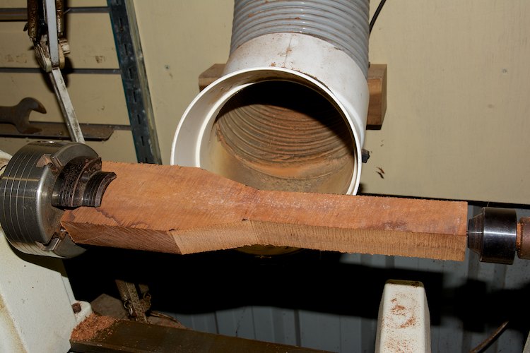

I use my Nova chuck with 2 spigot jaws fitted, clamp tightly once you have the centre of the handle lined up with your live centre. I put a centre punch mark on the end to help with alignment.
attachment.php

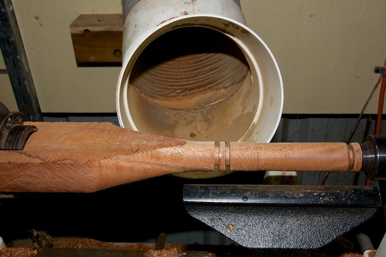

Turn the handle down to the greater diameter that you want, use a parting tool to define the end of the handle, if you want to put a bead on the handle like I do, mark where you want to put it.

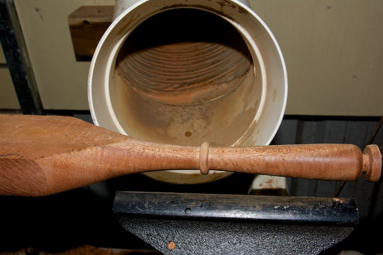

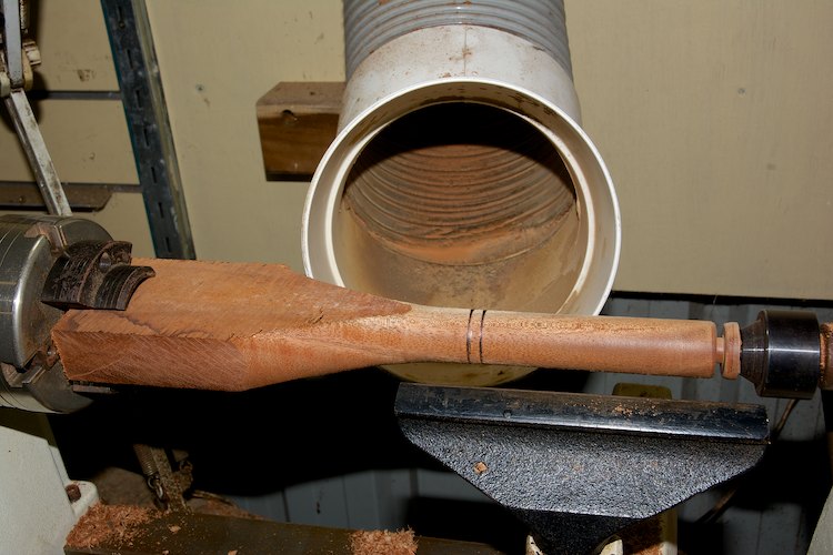

Use your parting tool to plunge some cuts in to define the bead, and to have a guide for your minor diameter, so you can see how far to turn your handle down.
attachment.php

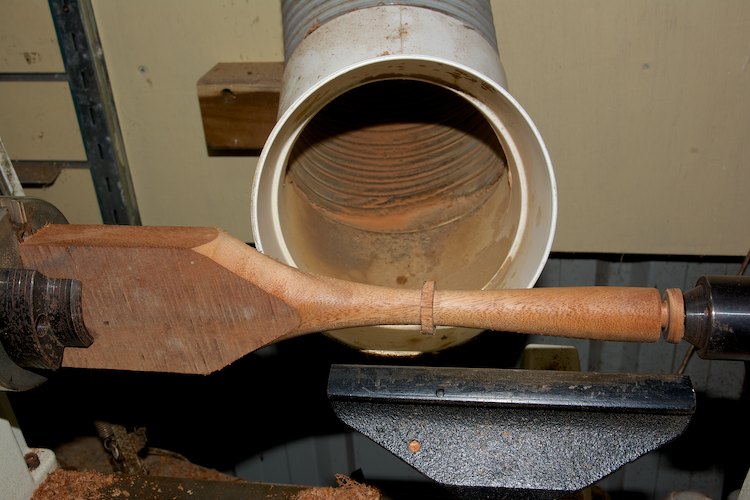

Turn down to your predetermined depth, try to make the handle look like it sweeps through the bead.
attachment.php
Use the skew to round over the bead, and also the end of the handle.

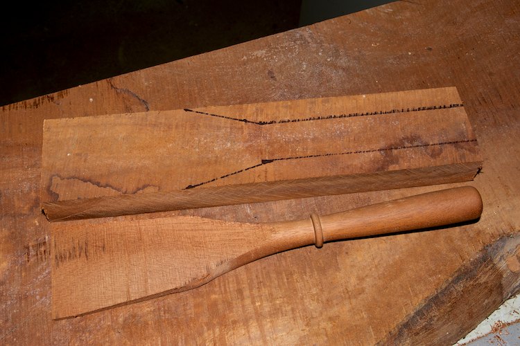

Mark the blade profile that you want to go with on the side of the blade.
attachment.php

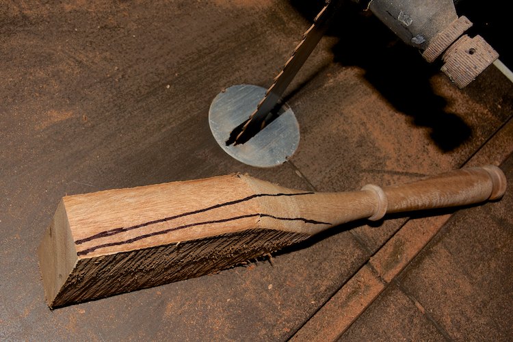

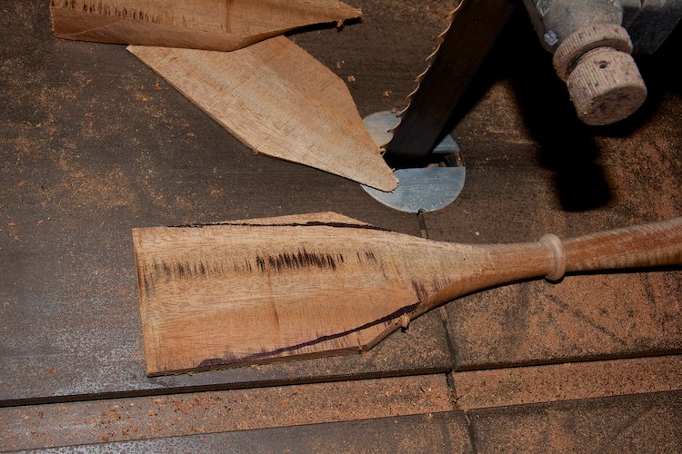

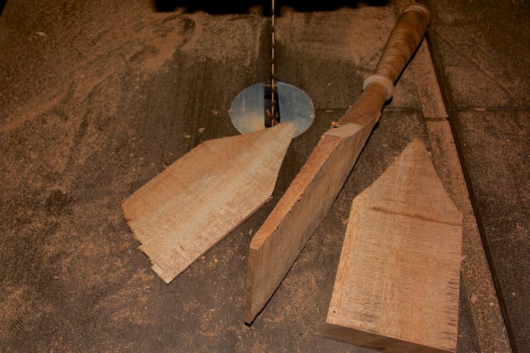

Cut to your lines on the bandsaw.cut the thinner piece off first so you still have the wider piece for stability on your second cut.
attachment.php

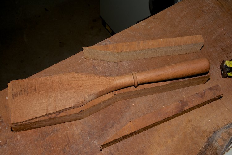

Now mark the shape of the blade.
attachment.php

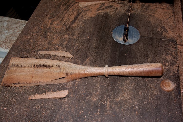

Cut to your marks. Also cut the button off the end of the handle while you are at it. Leave a little bit of the stub on the end of the handle, you will sand it smooth later.
attachment.php

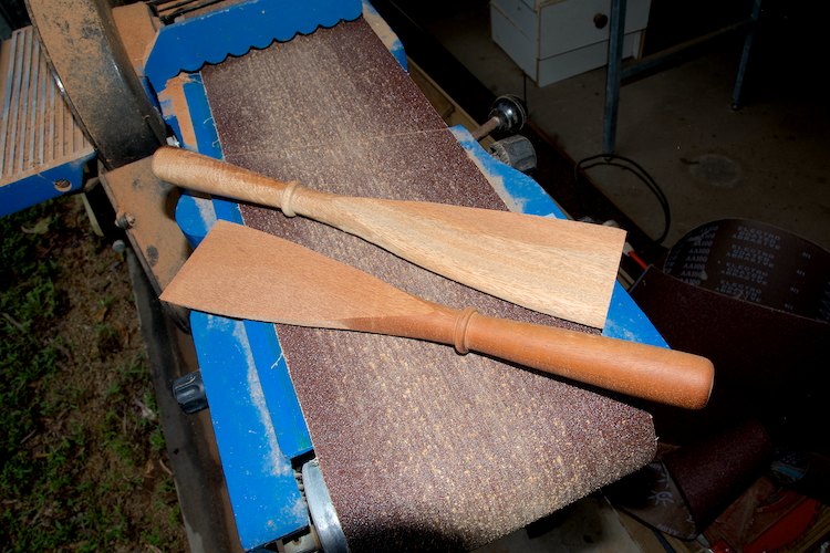

I use my 6" wide belt sander to refine the shape of the blade, on these spatulas I have put a slight curve in the blade . I have used a smaller belt sander held upside down in the vice, but these bigger ones are much better.
I have a 60 grit belt on here, it is a bit rough, but its my last good belt so thats what I am using. Just need to be very careful as it can take a lot of material off in a hurry.
attachment.php

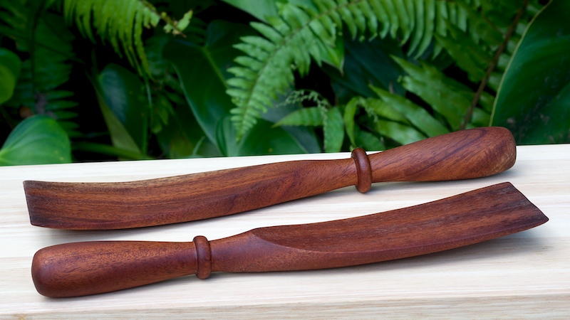

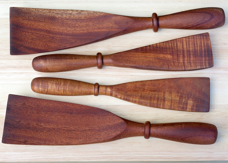

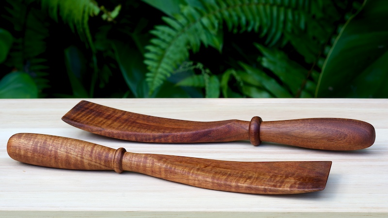

The results look pretty good, and they are a joy to use.
attachment.php
attachment.php
attachment.php
attachment.php

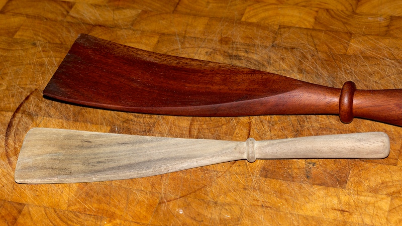

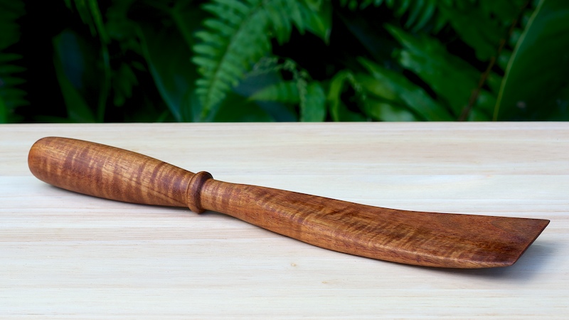

This is the one that has lasted nearly 20 years of use and regular trips through the dishwasher. Old and new are both made from Khaya.
