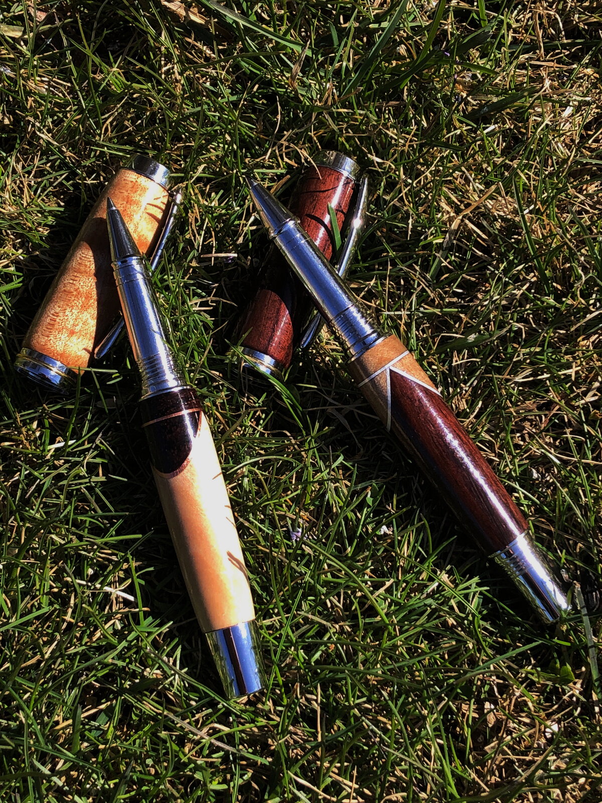

On the above photo, I had severe smearing with the little dots at the top when sanding, and then tried using a just sharpened (razor sharp) scrapper and was amazed at how clean it made the finish.

On the picture of the pens in the photo above, I built up a thick, probably .007 or .008 layer of CA and then sanded the CA down to the size needed but never sanded through to the wood. Bear in mind that I never put a piece of sandpaper to the wood and metal segments or dots. I have since learned that I can turn the CA down to a very smooth finish without needing to sand even the CA. I do buff lightly after turning.

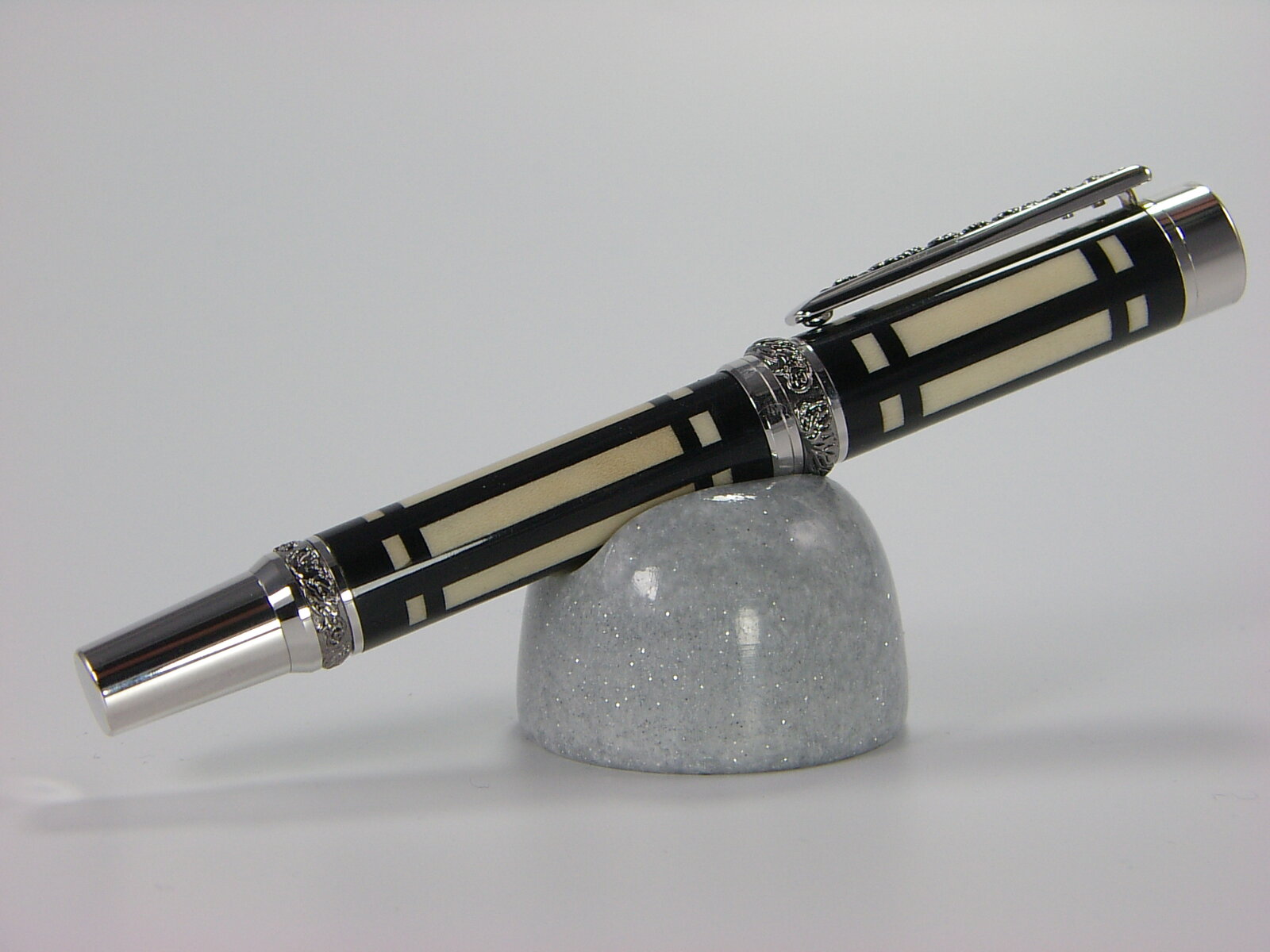

D'Arcy; When I do either inlays of metal or varying wood colors the same situation can arise. The darker dust "contaminates" the lighter wood. As soon as I complete the tool work, I coat the blank as I normally would with CA. This seals the wood and the sand paper dust does not stick and can be wiped off. You should wipe the blank after each grit of sandpaper.
