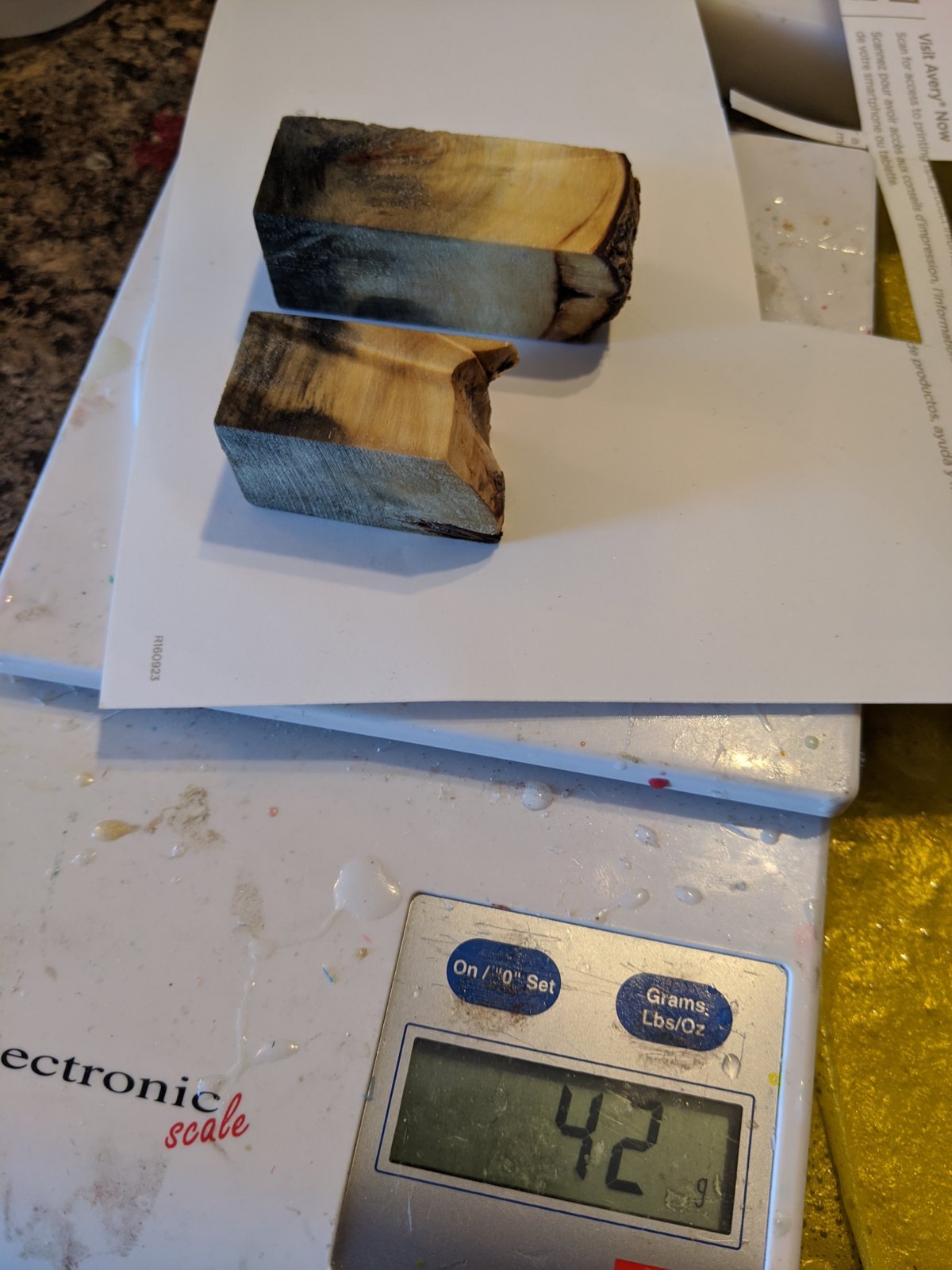

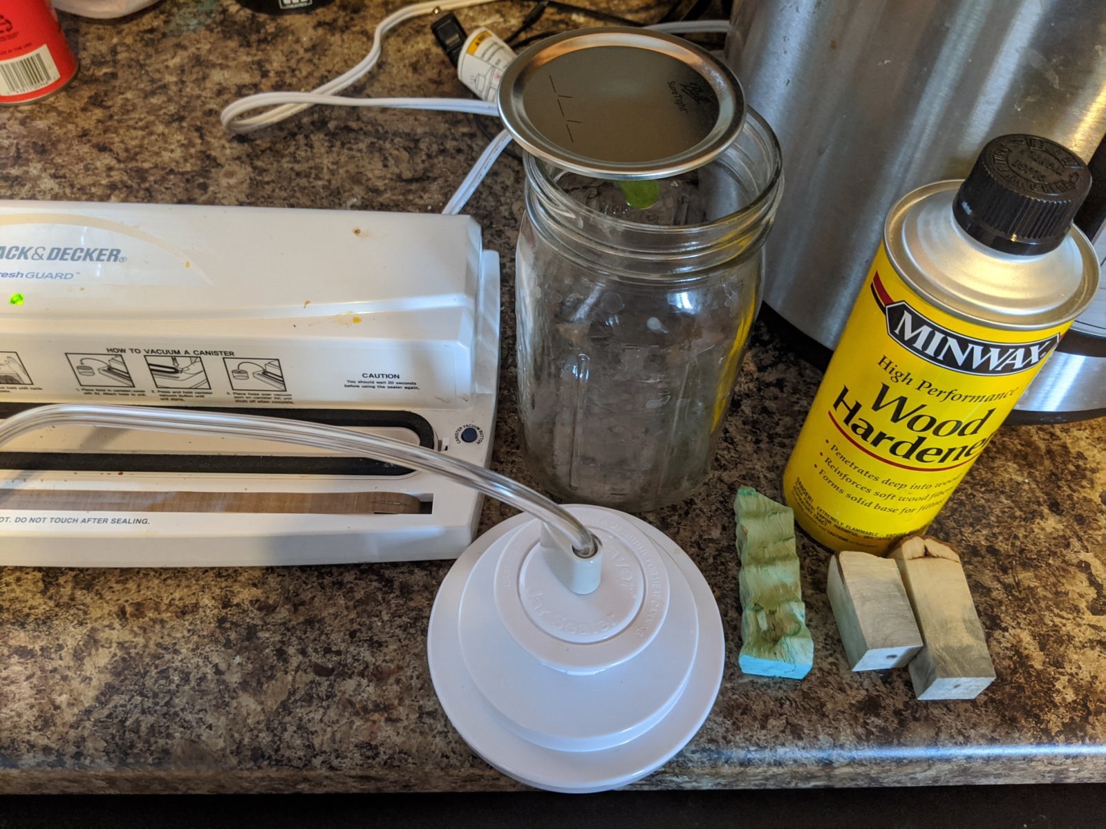

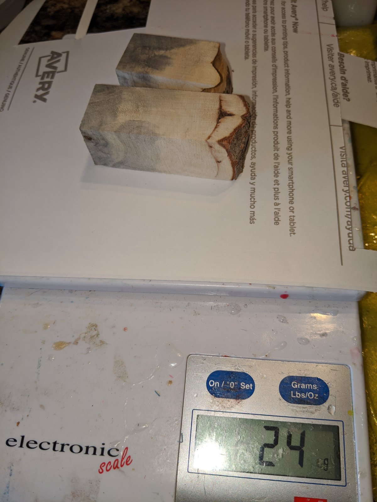

I thought I'd share a thing I recently tried. I used a food vacuum saver device, a jar, and some Minwax Wood Hardener to attempt to stabilize some buckeye burl. I wasn't sure how it would turn out compared to wood that had been stabilized using cactus juice but I was looking for a cheaper way to do what I wanted. I made a blog post with pics and the results that you can read about here if you want: https://mywood.shop/post/714925615348/how-to-stabilize-wood-cheaply

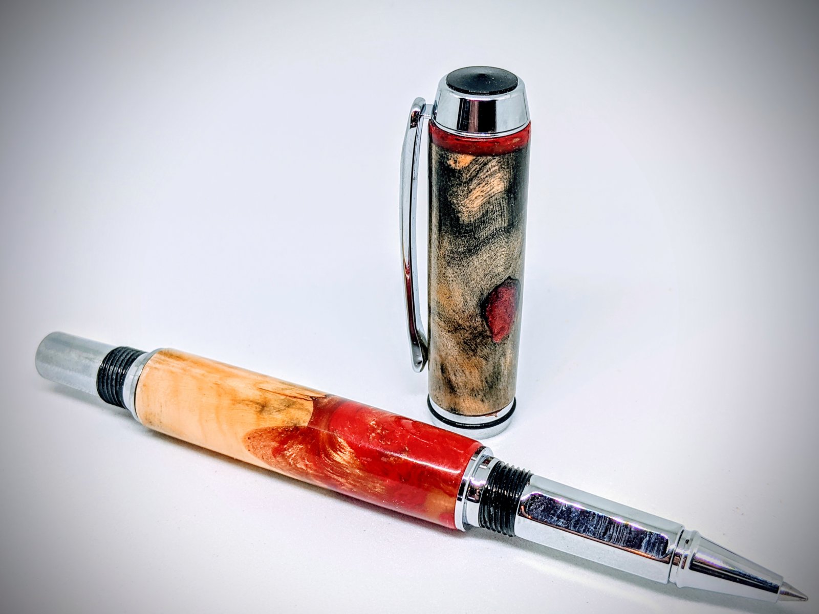

Really I am hoping this just saves others time for trying the same thing. While it works in theory, the wood sucked up the hardener, the dried wood after hardener did not at all feel, look, or turn like resin stabilized wood. So save yourself some trouble and give this a look. It made a beautiful pen, yes (several in fact) but if I had the extra cash laying around, I'd hit up TurnTex.com and get their system + cactus juice. Thanks for looking.

my understanding is that MW wood hardener is basically a solution of dissolved plexiglass in acetone. It is somewhere in the neighborhood of 70% acetone. So, all but 30% of what you get into the wood ends up evaporating. CJ on the other hand is cured, so essentially 100% of what you get in the wood stays there (minus squeeze out), obviously a big difference. CJ is about $17 per pint and MW is $13, but the MW is only 30% active so the actual cost of MW is $43 per pint of active material.
Another issue is that CJ is very low vapor pressure so it doesn't boil when you pull a deep vacuum on it, the acetone in MW will not allow for deep vacuum so penetration is limited because the acetone starts boiling before you get the vacuum very low. Its also a little dangerous to have a bunch of acetone vapors around electrical equipment.
