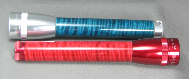

Ryan, I made my own pin chuck to hold it and I held the pin chuck in a Beall collet chuck. Nothing special after that, just be careful because the wood is VERY thin around the aluminum body.
I used a metal lathe and a milling machine to make mine but if you don't have these machines try this http://content.penturners.org/articles/2008/pinchuck.pdf
Also, there's a plastic lampholder in the front that has "DO NOT REMOVE" on it. I chose not to remove it but Hans said he did and it was not a problem. If you remove it then you can turn the body between centers and you won't need a pin chuck.:wink::cool:
THANKS Bob!:biggrin: They're really not that hard but having a metal lathe is a big advantage. I'm sure it can be done without one but it would take a little longer.
So all I would need to do is make a set of bushings with a 60 degree hole so that I can turn between centers.
I will ask my buddy with a metal lathe and see what I can come up with.
What size was the blank you used?
I use a 7/8" blank, 3/4" is just .040" bigger than the finished diameter so you'd need to be DEAD ON to pull it off. I turn the blank round leaving it as large as possible and then drill it. Then you can glue it on the body and turn it down. I also leave it a little long and part it off at the end.
You can make your own centers out of just about anything. Try using a hardwood, they won't last forever but after every couple of lights you make you can trim them down and they're like new again.:wink:
Here's a couple more I just finished.......................
