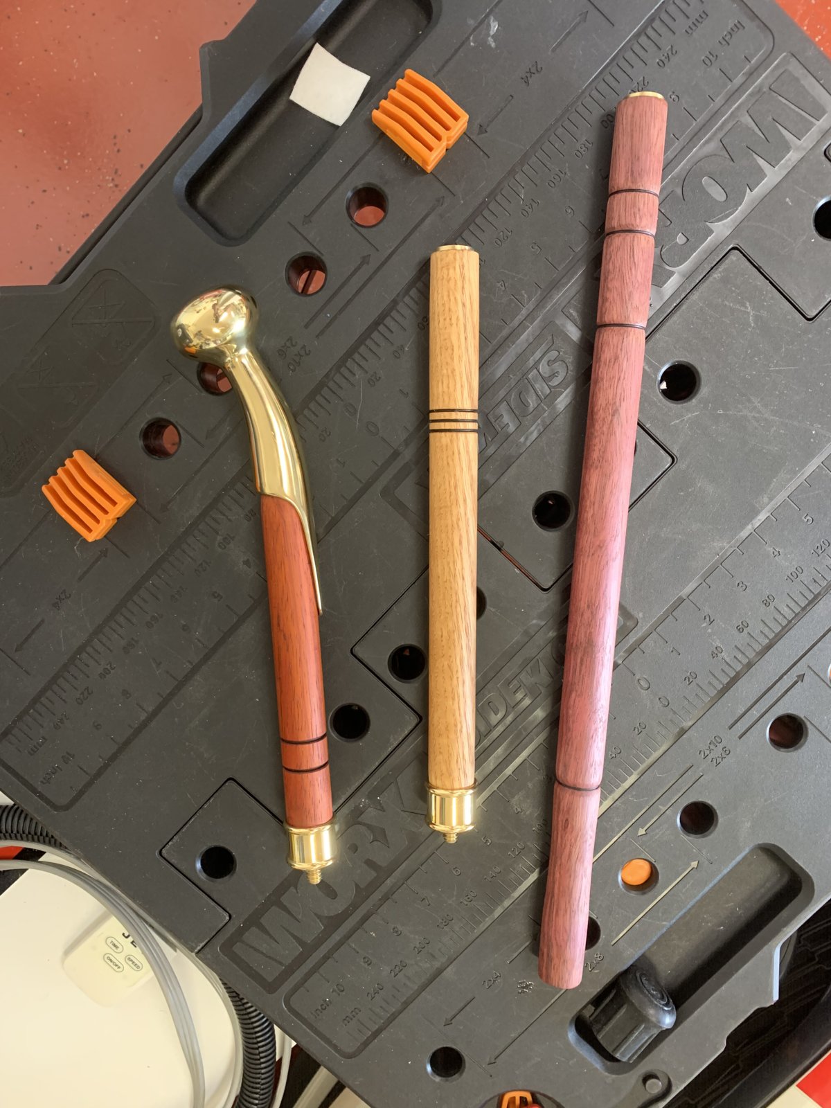

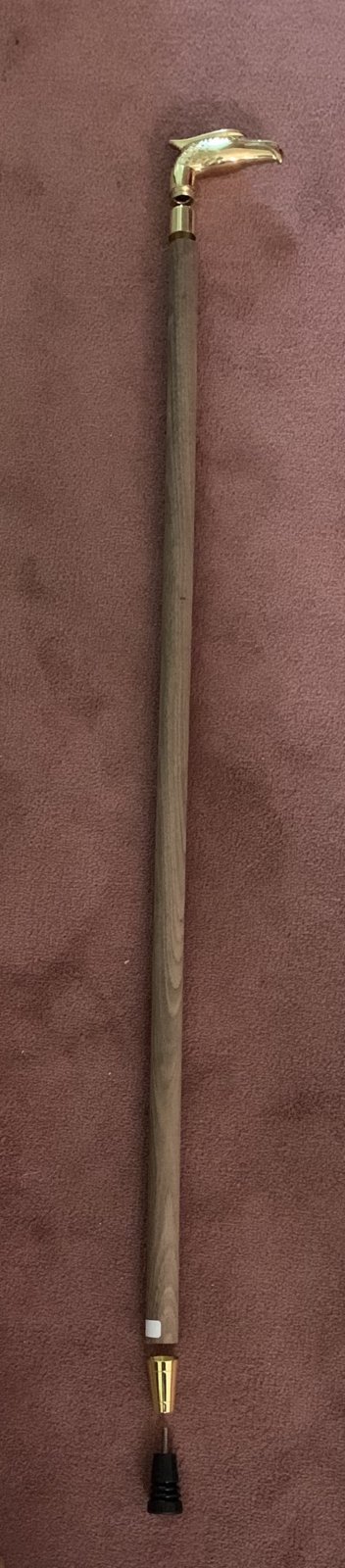

I think I found a 2x2 turning blank, although it's possible I ripped it from a maple board. Handle and foot came from Treeline USA. Used a rubber foot that unscrewed to reveal a point for use on ice in winter.

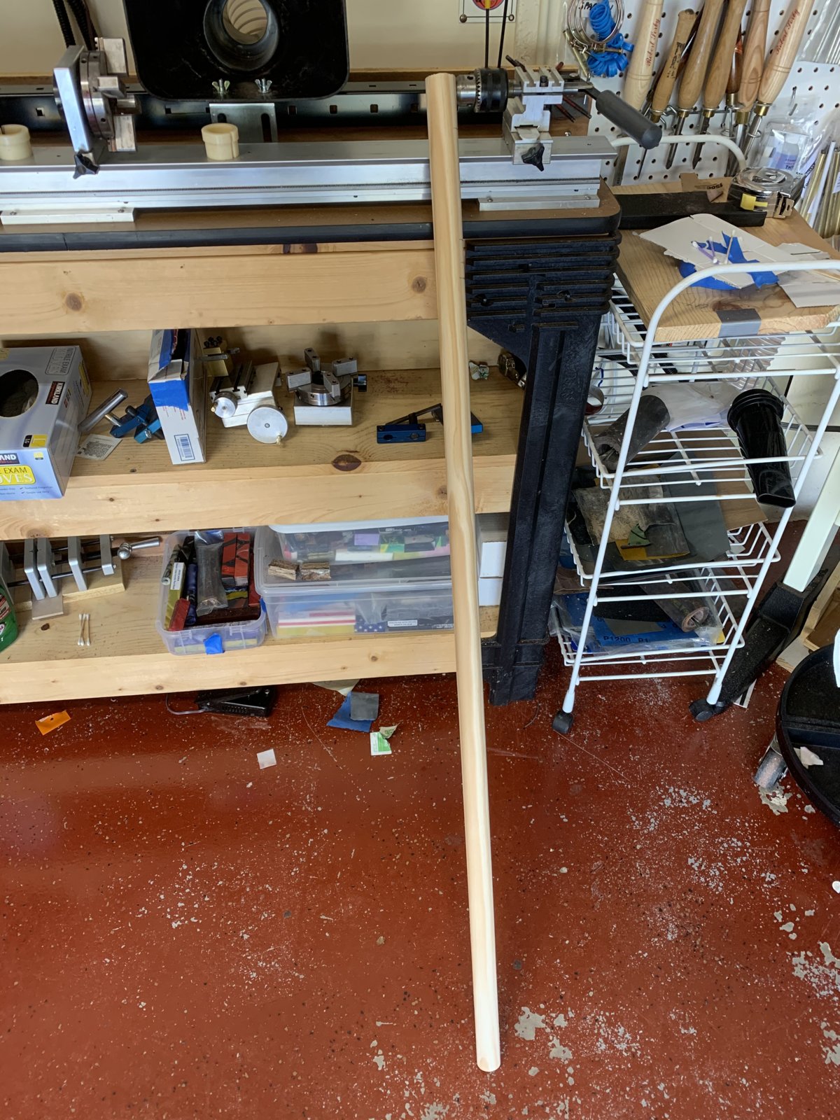

Song of the day "I'm Walking". Fedx just rang the bell. My next phase of wood turning begins. Gotta love this hobby. There's no finish line. First cane coming up. It'll mostly be a learning experience. I will be turning handles from blanks. No preforms. Should be fun.

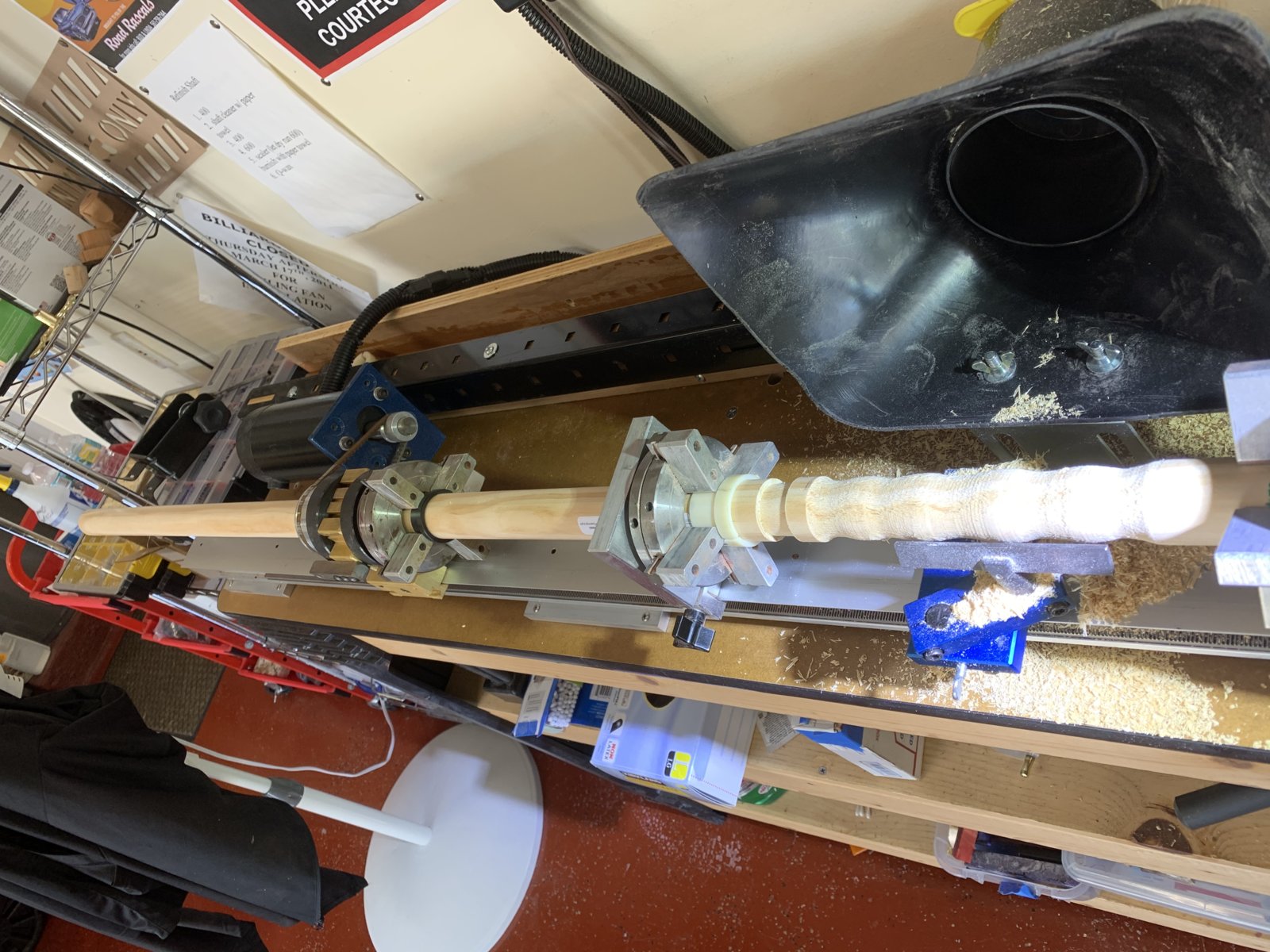

Sanding a long dowel(cane). I must say I hate sanding. It should be banned. No high capacity sand paper packs. Nobody under 100 should be able to possess it. Any sanding secretes/tips other that elbow grease. I'm losing the will to finish anything longer that a pen blank. I have lost it. I am ashamed. I'm embarrassed. My 8th grade wood shop teacher is rolling over. What has happened to me.
Come on now. You made one cane. We do get lazy because always a tool for everything. Use your imagination. They sell sanding sleeves, sanding pads, flapper sanders. You can make a jig and drill a hole in a length of 2 X 4 the size of the dowel and cut it in half. Use sticky back paper to the insides of the holes and set up in a vice and now just slide the dowel in and out. Change paper for next grit. Think outside the box.

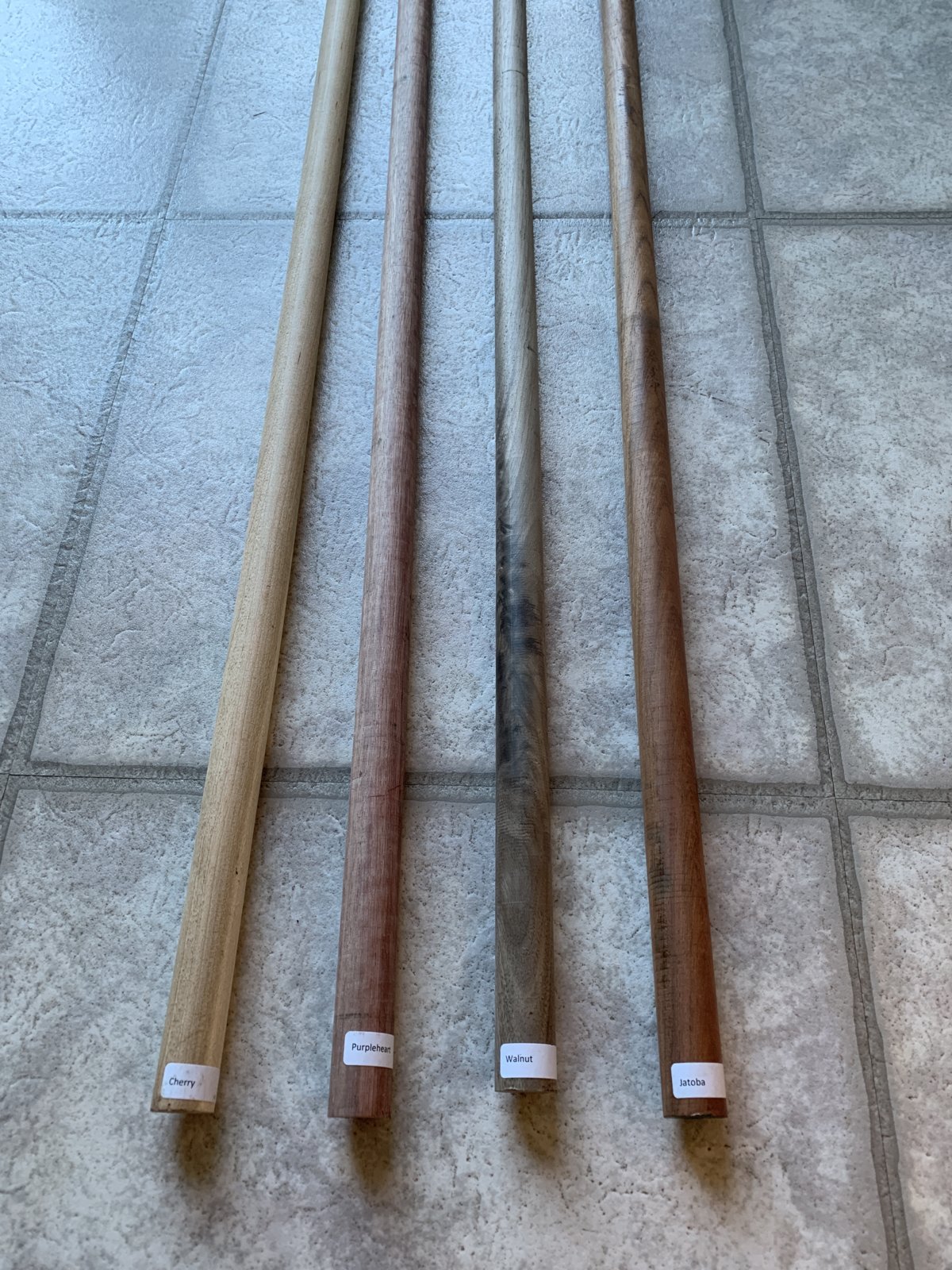

No hugs. How did the Danish oil go and is that the finish now of your choice for these?? Have to do some segmenting in these long dowels to dress them up and add some conversation to the piece. Furniture finish is lacquer and French polished. Now you are talking classy.
Danish oil for the first 2. Tru-oil for the cherry.... not sure for purpleheart. First 2 canes are plain janes. Might add some character lines or minor carving to the next. After these 4 I'll work on a custom handle. Would like make a walking stick or 2.

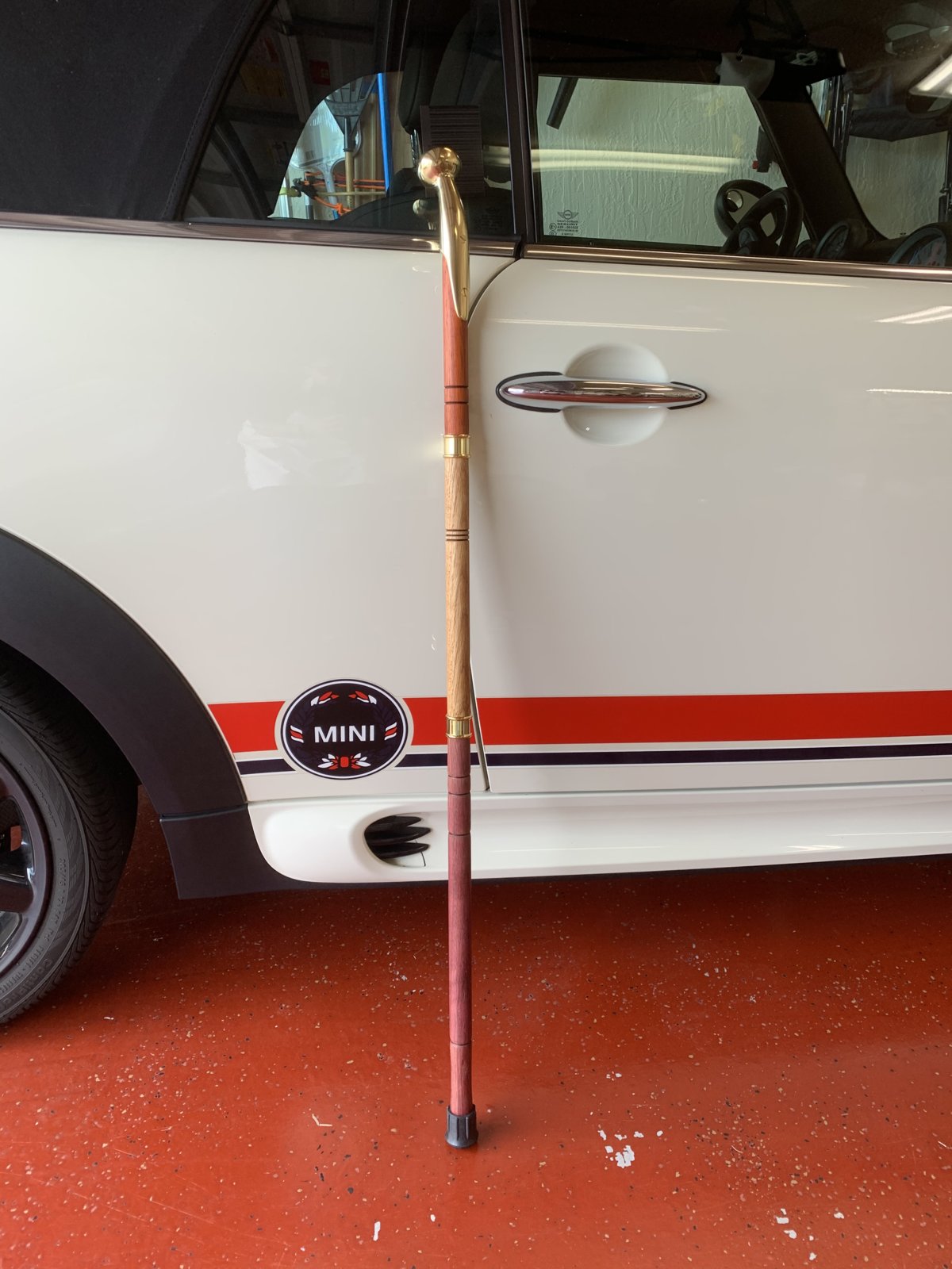

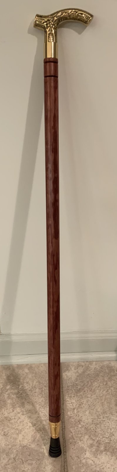

Edit... maiden voyage... not too bad. Made a few mistakes but they serve as learning points. First... Cane is too tall. I realize they are sized for each person.... 36" is high for me... I'm 6'1". The contour a few inches below handle made up for a gouge the came with the blank. Poor picture on my end.

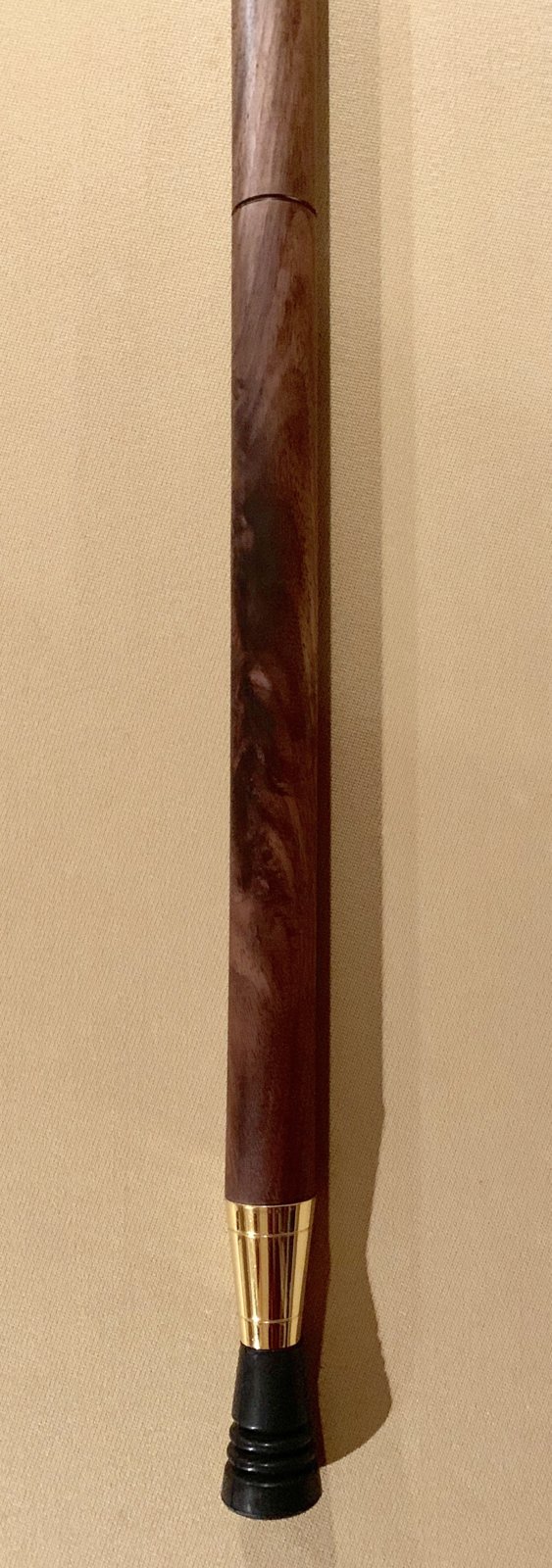

The tip combo is not up to par. The rubber piece unscrews after a few steps. I tightened it pretty snug but not to the max. Don't want to use any thread lockers...that'll kill the conversion. Has anyone use the tip combo?
Jatoba wood .... natural Danish oil... followed up with EEE. Poor picture sorry. I'm learning quickly. What to look for height wise. Realized some blanks are much heavier. Have no idea what I'm going to do with it but what else is new.

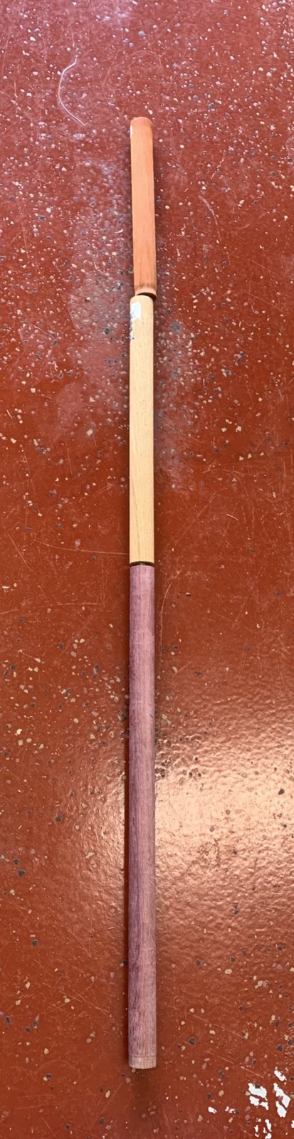

Canes are fun and fast. Purple Heart used here. Will try something a little more creative next cane.

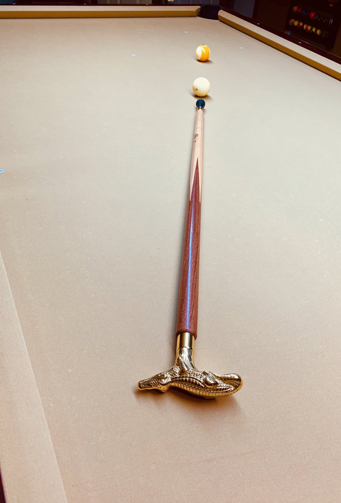

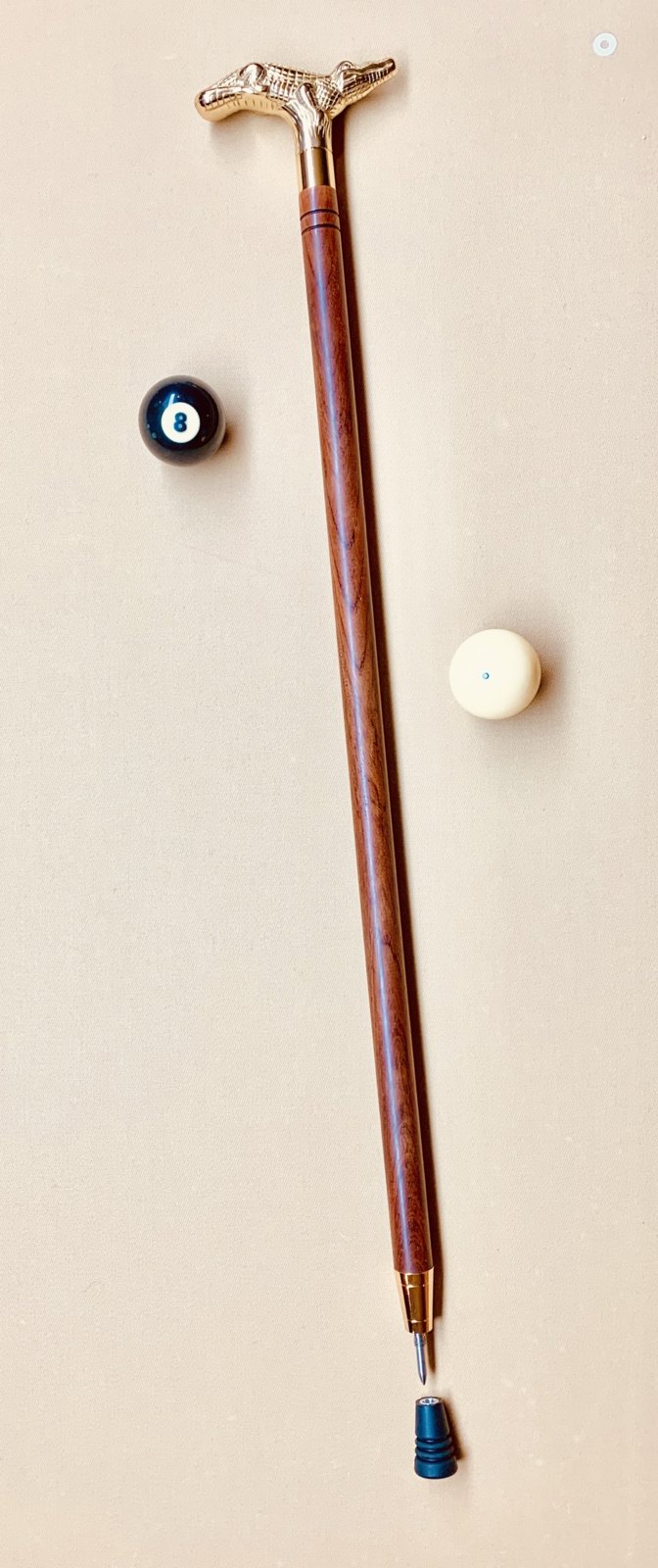

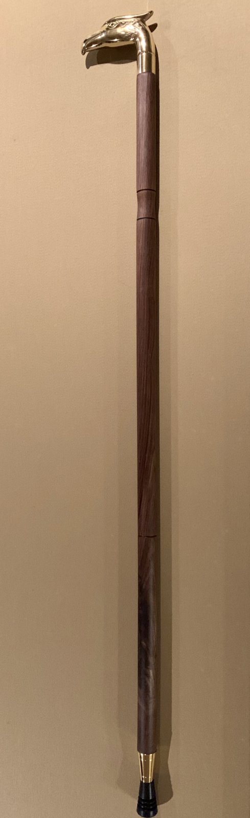

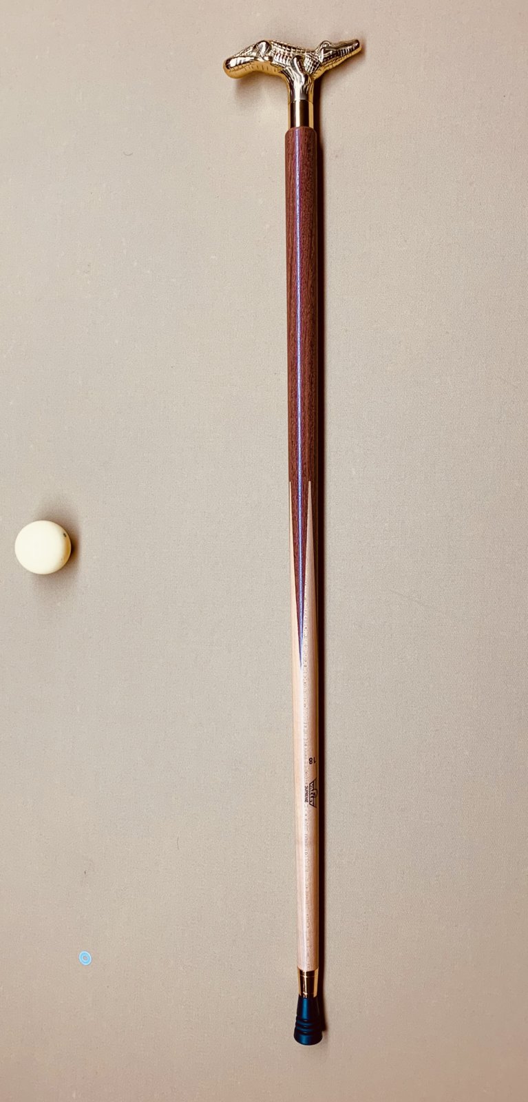

For my pool instructor. There's nothing like a good piece of Maple

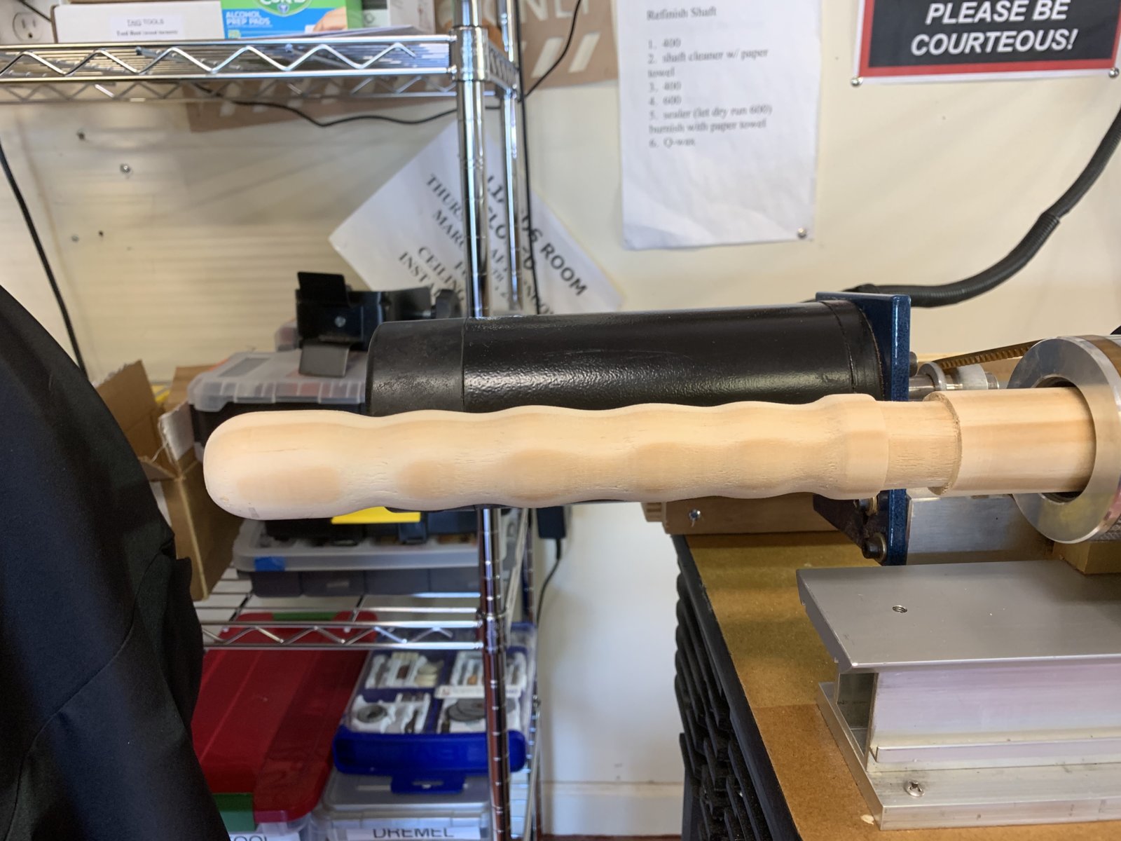

72 also and just getting warmed up. I have more pens, canes, stoppers and rings than brains or hair on my head... still going strong and going on. Just finished a 48" pine dowel from HomeDepot. Less than $13 to complete.
