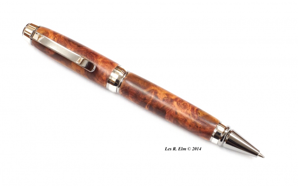

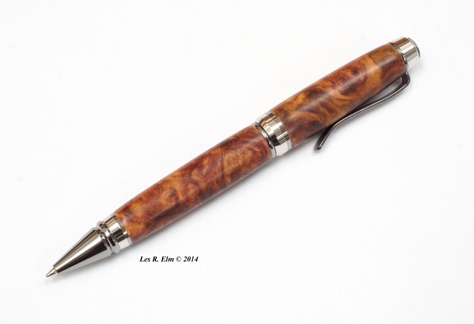

To get the warm natural feel and look of wood I use MINWAX WBOM Clear Satin Polyurethane for an easy to apply durable finish using my dipping method.
Les
There is no one single finish that will please everyone. I offered a polyurethane finish, CA and 2 version of a classic hand rubbed oil finish. The latter was the most labor intensive, but was usually the choice of the older mature buyers, the shiny version of the CA and poly was preferred by most of the younger buyers.

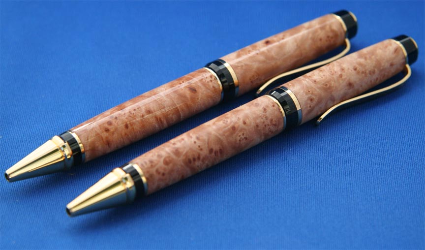

I did a test on a couple of identical wood pens several years ago. I finished both pens with a good build up of CA. On one I made a smooth shine; on the other I made a good shine to make sure it was perfect like the other and then dropped down to about 3000/3600 micro mesh. Looked dull for CA but it actually looked like wood. The CA was clear but without the shine it looked like slightly buffed wood, and it had a "feel" of wood. Russ Fairfield taught me that trick about "tactile" feel. Works too!

Here is the photo of two pens, both CA, one shine and one matt, referenced in my post:
http://www.penturners.org/photos/images/940/1_2Cigs_2Fin_1Burl.jpg
I don't think you van take a matt finish/varnish/poly/satin and make it shine, but you can take a gloss and make it matt with steel wool or high grit sandpaper - which will give it a "tactile" wood feel.
