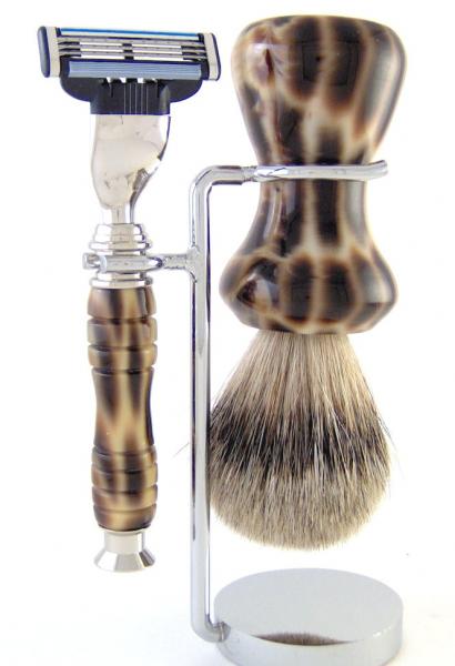

Hi, I find it easier to design the handles to the stands i use. I like to have the razor and brush hang level with each other, like the one i have done in the photo below. Carl

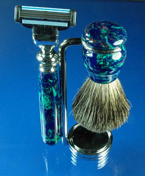

Here is a Berea razor on a PSI stand. The razor will fit if you carefully spread the ears on the holder a slight amount. I have done several with no damage to the chrome.
