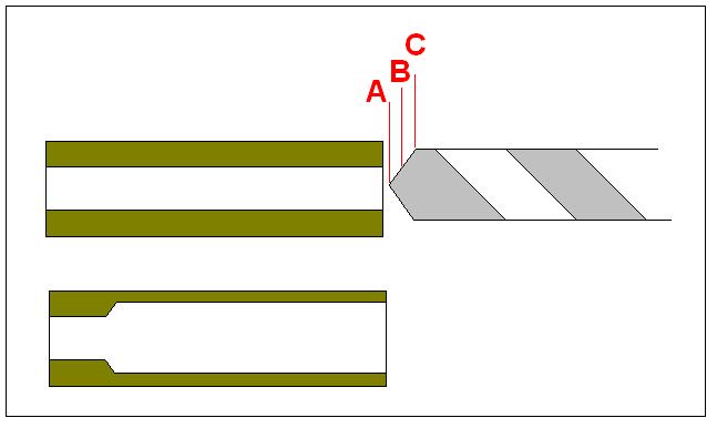

This is a question that has puzzled me since I saw the first tailstock DRO here. Don't get me wrong, I think they 'can' be useful, but I was wondering if most people are actually getting better results than simply doing it the old way by making a mark in the drill bit?
What point are you using as the Zero reference?
Please look at the sketch. You can see that if you wanted to drill a hole to a certain depth, then the zero point is important.
If you choose A or C, then at what point do you zero the DRO?
If you choose B ( edge of existing hole ) then surely the difference between the existing pilot hole and the finished size would alter the depth.

I use "C" as for my depth Zero almost all the time. There are a couple of instances where I use "A" but rarely. The DRO,s wont shut off when they are in motion if they work correctly, they are supposed to only shut off due to inactivity. I use them for drilling front sections when making my wooden pens.

I do like Mike with my reference point. I use Pt "C" most of the time.

I usually index off point "A", but that's because I do a lot of step-drilling. Without any visual reference, I just slide the tailstock in until the bit makes contact and count revolutions of the handwheel for depth. I don't typically mark the bit (so I don't have to worry about redoing it when I sharpen the bit), but there is one blind drilling operation I do where I have to fully retract and clear the bit a couple of times. Since I can't reset to zero, I drill to a mark on the bit.

Ok gents, it seems most use point C on the bit. I do too, but I mostly mark the drill bit with a Fineliner Sharpie. If I need precision, then I drill a little deeper and then face off the material and use a vernier until the depth is spot on. ( If I'm boring a hole with a boring bar, then I use the dial on the hand wheel irrespective of whether the cutter is in the tailstock or the topslide toolpost )
With a mark on the bit there is no need to zero anything, so at what point do you zero the DRO? .
It would seem that you'd have to drill a bit till point C is flush with the blank before you could zero it.

Good question Steven. I use my DRO for drilling the depth of the tenon I've glued my cap bands on. I line up the bit with the openingof the blank (letter C in your illustration) then zero the DRO there. Has always worked for me, so far.

As far as "A,B &C" is concerned I usually drill until "C" is flush with the front of the job, then press zero.
