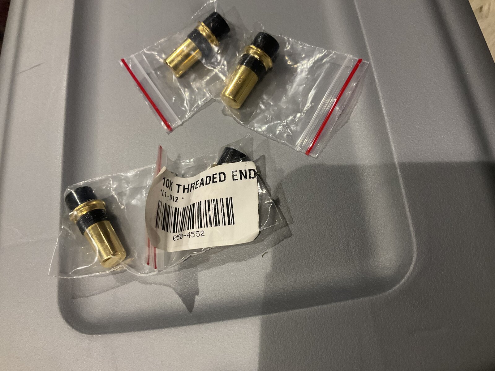

Which kit does this end cap belong to?
fnfalguy
Jun 3, 2023
152
NY
I'm still sorting through some loose parts and I'm trying to find where these fit. I searched craft supplies and woodcraft for the numbers listed and found nothing. It doesn't seem to fit the jr gentlemen tube. The OD is 0.377". Any suggestions are greatly appreciated.

The product numbers are Craft Supply part numbers. They are threaded ends for the original jr gent which did not come with posting barrel end finials. The tube sizes were the same as the Baron. When the jr gent 2 came out the tube sizes were changed. The Baron came with posting barrel ends.
I have a few if you need more. ;-)
Do a good turn daily!
Don
Joel, the stock number in your photo is from CSUSA. My guess is that this is a postable end cap for the Apprentice Jr. Gents II. Once upon a time CSUSA used to allow you to select postable or smooth end caps when you bought the pen. To make sure, I'd call them Monday. Their customer service has always been good.
