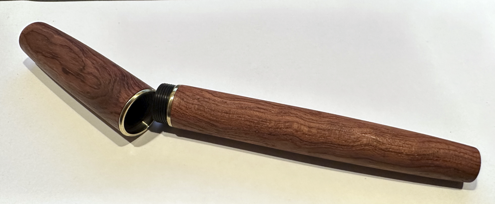

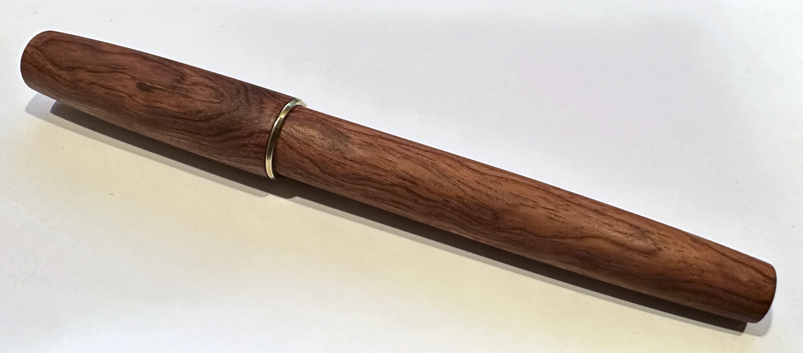

Richard Greenwald's retirement really seemed to leave a hole in a certain segment of the penmaking market. I know you said you're not in the market for a metal lathe, but I will say it's one of the best investments I've made. If I had enough spare time, I'd even consider a side hustle making trim rings.
Without knowing a decent source for premade trim rings, I guess all I can add is that I agree with you 100% as far as the impact even just a little bit of metal trim has. It really classes up what would otherwise be a rather unremarkable pen...
This is gorgeous!
I definitely want to get a metal lathe at some point, but I'm just not ready for that yet. If you ever start that side hustle, I'll be your first customer, haha :)
