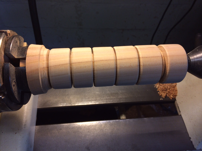

Dan Masshardt Member Joined Jan 30, 2013 Messages 4,822 Location Mechanicsburg, PA Jul 4, 2014 #1 Any guesses? Attachments image-3291421808.jpg 421.4 KB · Views: 387
mark james IAP Collection, Curator Joined Sep 6, 2012 Messages 13,698 Location Strongsville, Ohio Jul 4, 2014 #2 Napkin holder rings
ed4copies Local Chapter Manager Joined Mar 25, 2005 Messages 24,809 Location Racine, WI, USA. Jul 4, 2014 #3 6 very short peppermills:biggrin::biggrin::biggrin:
E Edward Cypher Member Joined Feb 8, 2011 Messages 1,901 Location Denver, Colorado Jul 4, 2014 #4 Massage roller!
mark james IAP Collection, Curator Joined Sep 6, 2012 Messages 13,698 Location Strongsville, Ohio Jul 4, 2014 #6 Candle stick holder

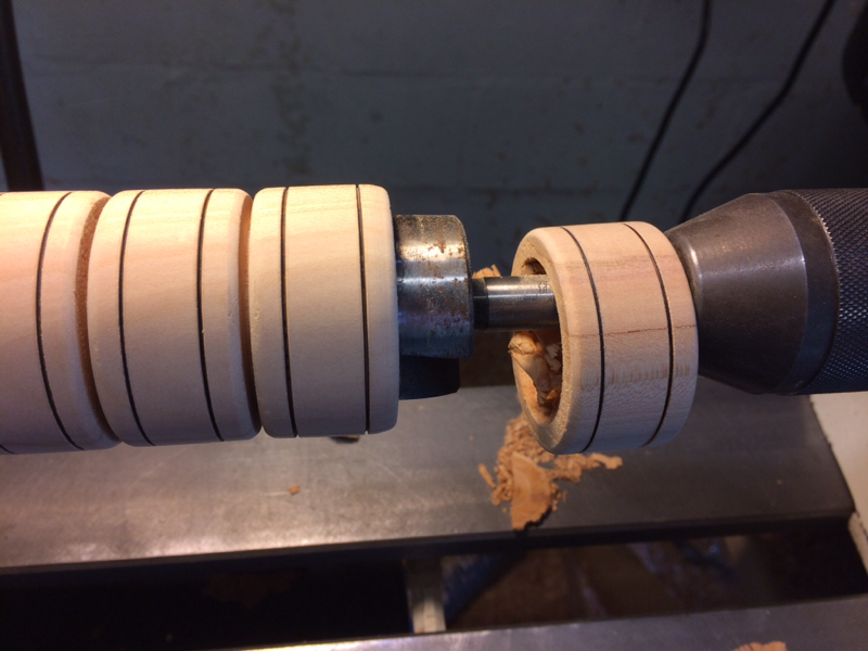

Dan Masshardt Member Joined Jan 30, 2013 Messages 4,822 Location Mechanicsburg, PA Jul 4, 2014 #7 mark james said: Candle stick holder Click to expand... You shouldn't have doubted yourself Mark. You were right the first time. They'll get some Danish oil tomorrow. Attachments image-3044508459.jpg 398.5 KB · Views: 328

mark james IAP Collection, Curator Joined Sep 6, 2012 Messages 13,698 Location Strongsville, Ohio Jul 4, 2014 #8 Cool project and the burn lines really set it off.
terry q Member Joined Jun 2, 2004 Messages 736 Location 301 E. Court St. Roanoke, Illinois, USA. Jul 5, 2014 #9 Neat idea Dan. What size hole? How will you sand the inside?
Dan Masshardt Member Joined Jan 30, 2013 Messages 4,822 Location Mechanicsburg, PA Jul 5, 2014 #10 terry q said: Neat idea Dan. What size hole? How will you sand the inside? Click to expand... Inch and a half hole. 2" ish od. The insides off the Forstner aren't actually too bad. I'm looking for a good used spindle sander. Right now I put one of the sanding drums (these kits are very reasonably priced) in my drill press. Same idea and the benefits I miss from the oscillation aren't really vital on the inside of these.
