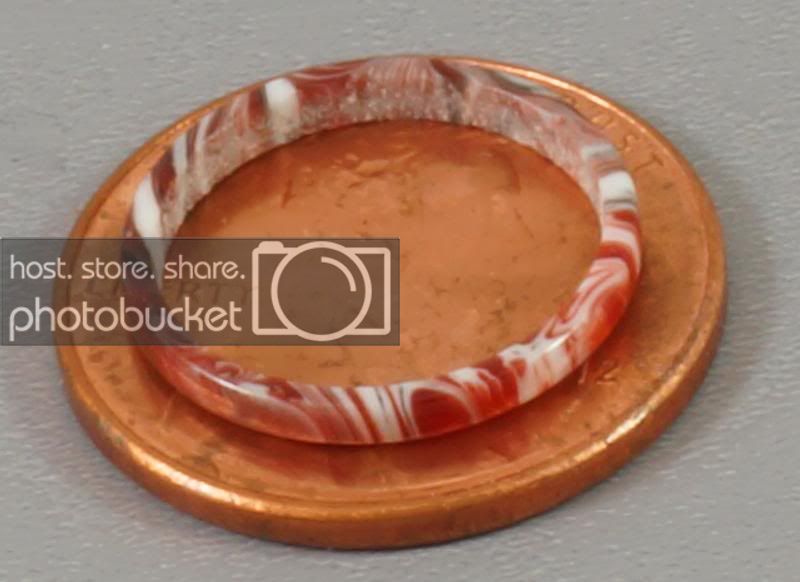

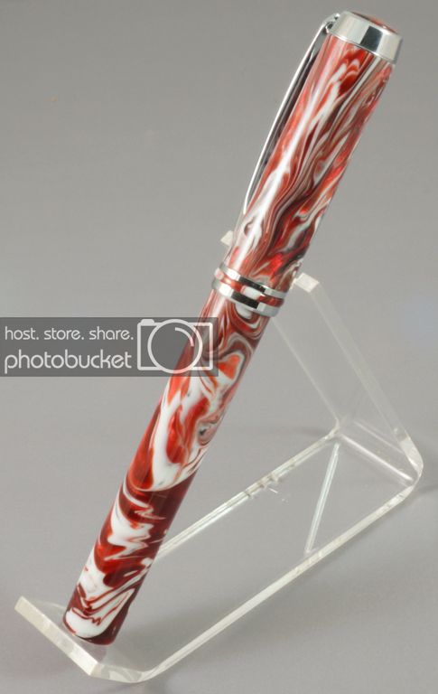

At our recent local IAP meeting, I did a demo on doing a custom finial & centerband for a Jr Gent I with a closed end barrel all from one 5 1/4" blank.
Here's the ring.
These are a bit smaller than they look. Here's the same ring on a penny.
And this ring was an oops ring because it's actually too big. That's the problem with doing demos on someone else's lathe. I didn't have the tailstock set right when I drilled, and the hole was too large.:redface: So I didn't get the entire pen from 1 blank. I had to use a scape for the centerband when I got home.:frown:
Here's the pen.
Looks good Bob. Looks like that would take a very steady hand. Sure hope I can make the next meeting. Happy New Year to you and yours. Ted:smile:
Hey Bob, that is really cool! The perfect treatment for your beautiful blanks. Why don't you make a guest appearance in N Texas to demonstrate! Or just list out the order of the steps you take. The idea doesn't sound too mysterious, but it is nice to have a recipe.

Thanks for the compliments!! I really like doing these little touches. From a sales standpoint, it's may not be cost effective, but I do it for the fun of it.

Very nice Bob! Saw this first on my phone this morning. First saw the ring and thought, wow that's really nice...then scrolled down and saw the pen :eek: Wowza! You're gonna end up getting phone calls from me now!

Awesome pen!! One question: I get how the ring is made (thanks for the step-by-step), but is the ring put onto the stock hardware in place of the black ring? How does that happen? If I remember correctly, the stock centerband is one piece. Thanks in advance.

Didn't you take good notes at the meeting?:wink: To be honest, the ring in the 1str 2 pics was really close, but there was just a little bit too much play, so I made another. I'd be glad to do another demo of this sometime. It's been awhile since we had an unscheduled informal meeting. It just needs to warm up a bit 1st.

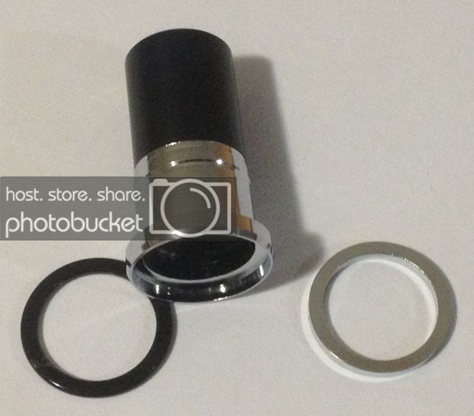

It depends on the manufacturer of the kit. I get my Jr Gent I kits from Timberbits. The centerband is 3 pieces on this kit. Perfect for doing this mod. You can also do this when the centerband is in 1 piece. There is a tutorial in the library that explains it. I've never done one that's 1 piece. But I plan on trying it soon with a Jr Retro.
EDIT: Here's a picture of the centerband pieces from the Timberbits model of the Chrome Jr Gent I.
Bob, That is terrific, both your centreband and the finial, as well as your Tutorial Step Notes.
Thanks for your thoughtfulness in sharing your ideas, technique and skill,
Brian.

Bob, I havent tried the tiny rings yet but I did the finials. You made it look easier. But I got it. Woo
