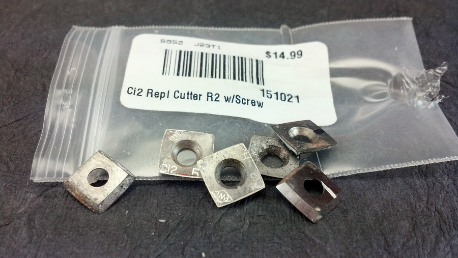

Just throw them away? At $15 a piece it would be nice to know if there is a way to get a good edge back on these carbide cutters. Has anyone tried it? Is it easy to do or is it just easier to get another cutter at $15 a piece. Thanks for any advice.
I can sharpen those for you. $5 each plus a couple bucks for return shipping. Sound reasonable? I use a diamond wheel on a tool and cutter grinder at the shop I work at.

But, the ones you have can be sharpened with a diamond hone and a little water.

When my cutters get too dull to turn wood or acrylic, I mount them in a separate handle just for turning stone inlay. Get's a lot more life out of them. I do a lot of turquoise infill and they work fine for that when they are too dull for wood or acrylic. By dressing them from time to time with a diamond hone, I can use them for a long time on stone.
I also buy the BT radius inserts from global tooling. $26 for a box of ten
I use the card size diamond sharpeners and get a renewed edge fairly fast that will last almost as long as the new ones. I have resharpened the same cutters three times so far.
