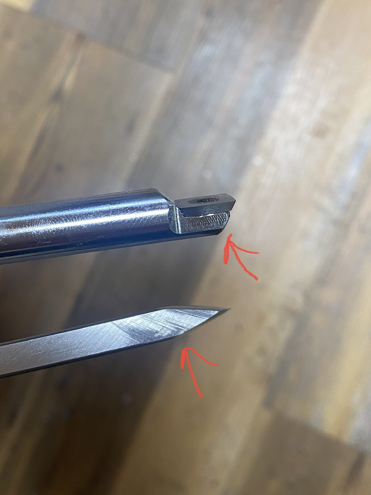

Not so with carbide. You need to be further away than with standard HSS tool The tool prevents this because of the construction.
All my toolrests are the Robust tool rests. Like them alot.
I use carbide and you still want to be as close as possible with the toolrest. Your distance from the workpiece certainly shouldn't be defined by other parts of your lathe blocking your toolrest because you're using one that is too big. Not only is it bad practice it for turning technique it is also less safe.
That may be your personal experience but here's my carbide next to my preferred hss tool (30 degree skew). The construction of the carbide tool allows me to get closer with my toolrest than the hss tool because the flat part of the hss tool, which sits on the toolrest, starts further back from the cutting tip on the hss than the flat part of the carbide tool does. It's the same for my other gouges.
I just find that the distance is greater with a carbide than a HSS tool I use the Easy Wood Tools.
In the majority case it definitely is. I can't speak as much to skews, as I am not very good with them, but carbide vs. pretty much any other tool I have, except maybe my parting tools, is usually that the carbide overhangs more than the other tools. With a proper gouge, I can get the tool rest within a millimeter or so of the blank, whereas with carbide that is definitely not the case.
There are undoubtedly exceptions, but most of the time, you need a bit of overhang with the carbide tools for them to work right.
