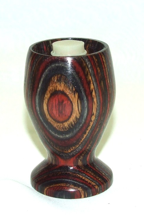

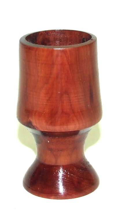

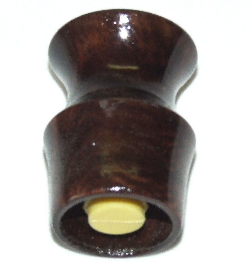

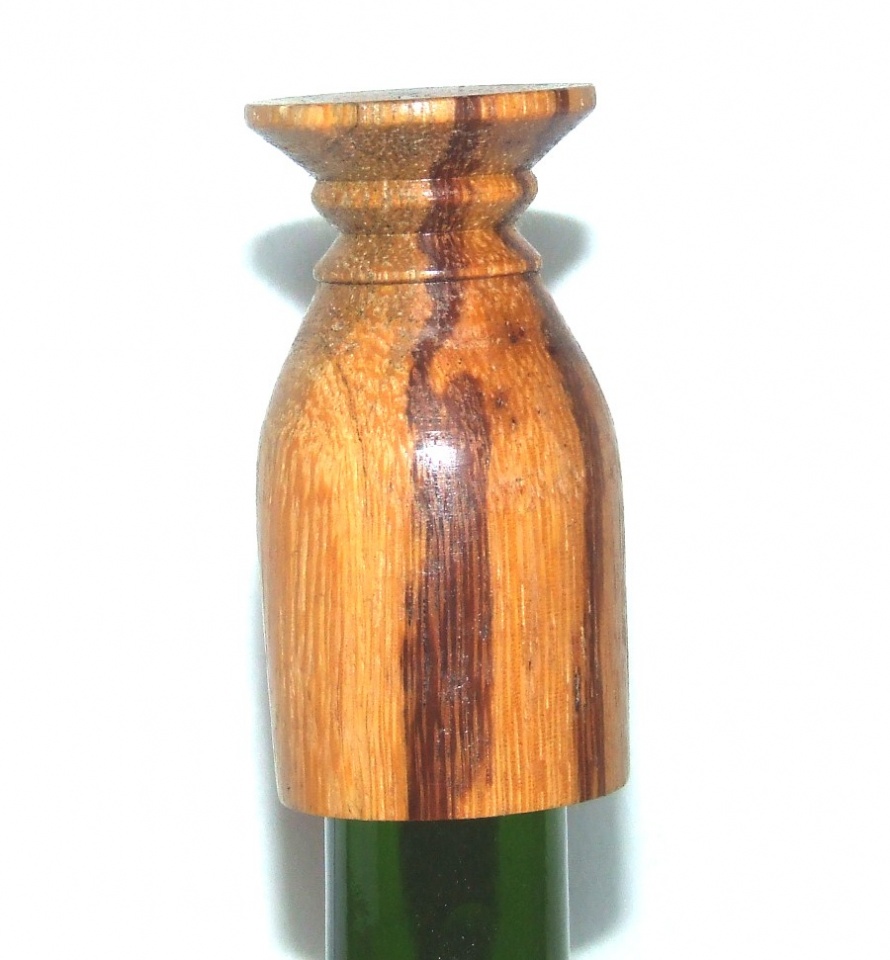

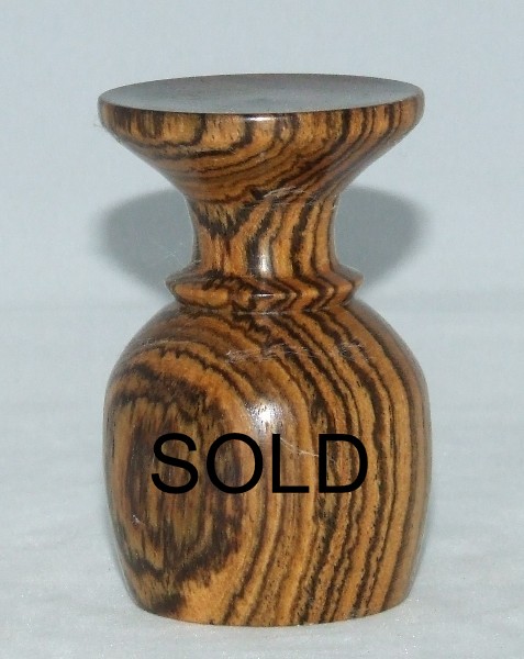

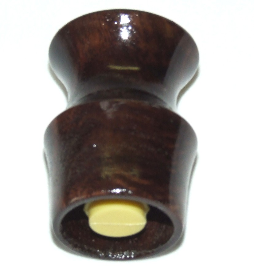

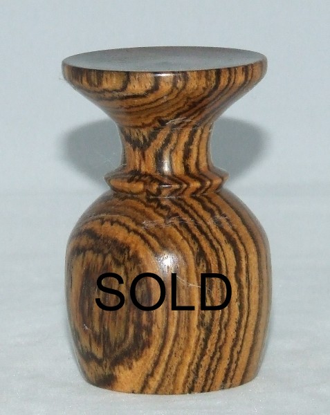

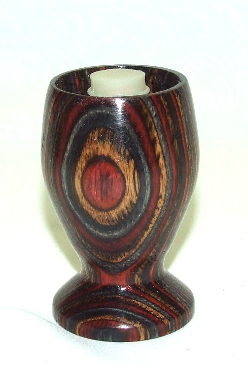

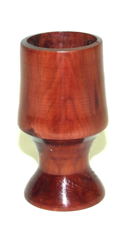

Randy, I used to make a stopper I called a "hidden cork" stopper... I think I drilled the blanks at 1 1/8 or 1 1/4 for the blank to fit down over the bottle...I can check tomorrow when I'm back in the shop... getting ready to go over the mountain to GA to have dinner with my son or would check now.
These are all sold and gone, so I can check the size of the hole over the bottle.
Mine are like Chuck's, but I only use 1.25. I drill my hole first, then use a homemade reverse expanding arbor that fits my collet chuck. This keeps the hole centered on the finished turning.
