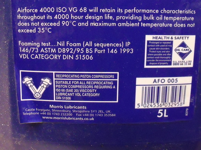

This is the stuff I use. It is good for just about any type of pump including reciprocating piston or screw.
There is a web site shown on the back and you can get a list of their stockists on their site.
I'm sure you can get similar stuff in France, but UK isn't too far otherwise.
Good luck
