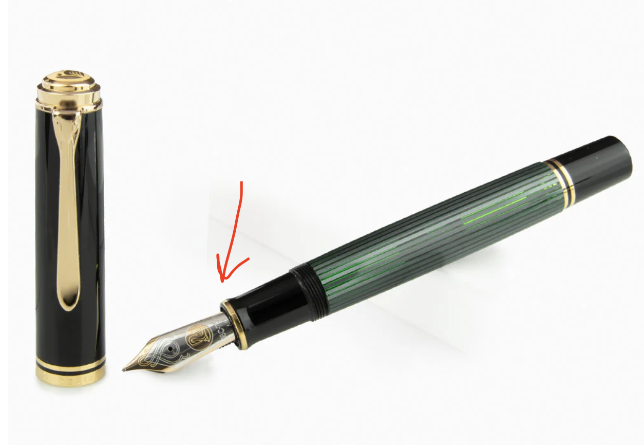

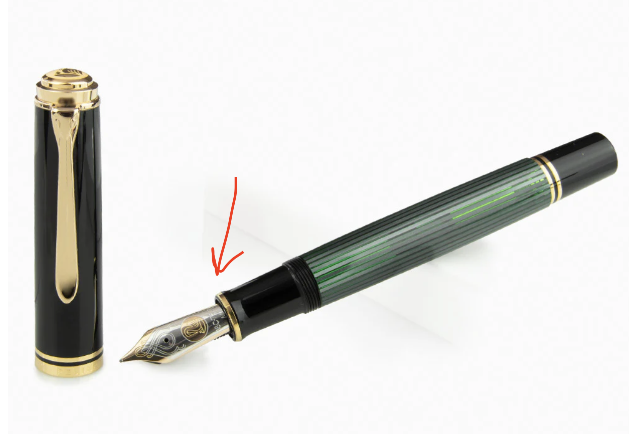

Hi everyone, I am wanting to make an ebonite section with a metal ring near the nib, similar to this Pelikan pen. However, the Pelikan pen does not have an ebonite section. I was reading that it's hard to bond ebonite to itself or anything else. Since my fingers will probably be frequently knocking up against the ring, I am concerned that it will pop off over prolonged use. I was wondering if there is any truth to this, and if there is, what adhesives would be good to secure the ring well there. (I found a video that shows how Pelikan does it, and they injection mold plastic around the metal parts so the metal parts stay securely in place. But obviously I can't do that.)

Pelikan plates that ring with 24kt gold at the end of the nib to increase corrosion resistance. Depending on the metal used for that placement, you can experience fairly quick corrosion. Many inks are corrosive. They can corrode the epoxy as well as the metal, leading to failure. Make sure your epoxy is fully cured before inking it up.

Wow, thank you so much, I had no idea epoxy would fail with prolonged exposure to ink. And I knew that you should never eyedropper a pen with a metal barrel, but holy moly I had no idea the metal corrodes that quickly. Is it possible for any unplated metal to be on the end of the section near the nib then? And I notice on your pens there is a metal band at the end of the section where it meets the body, does condensation from the nib fill the cap and make those prone to corrosion too?

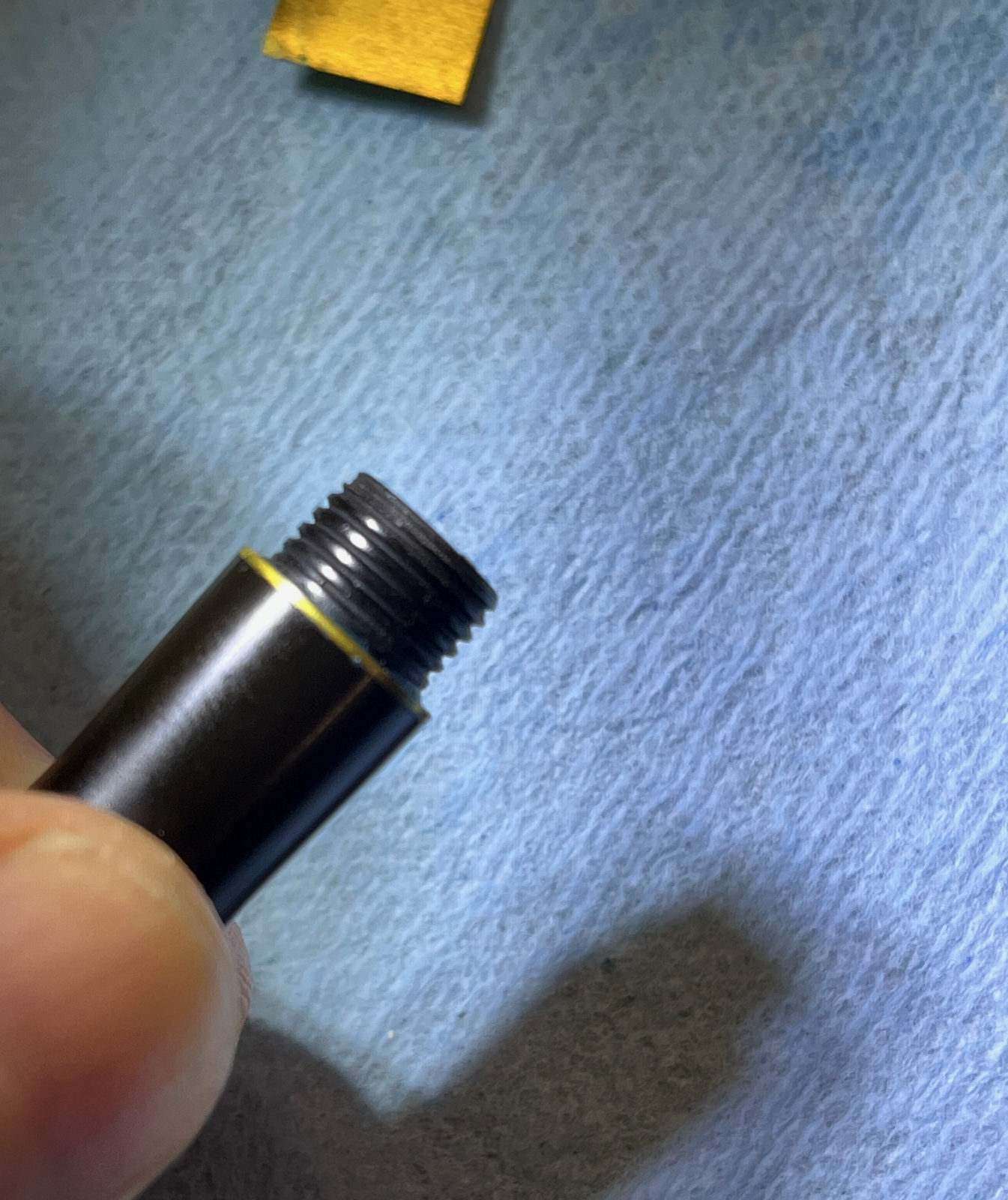

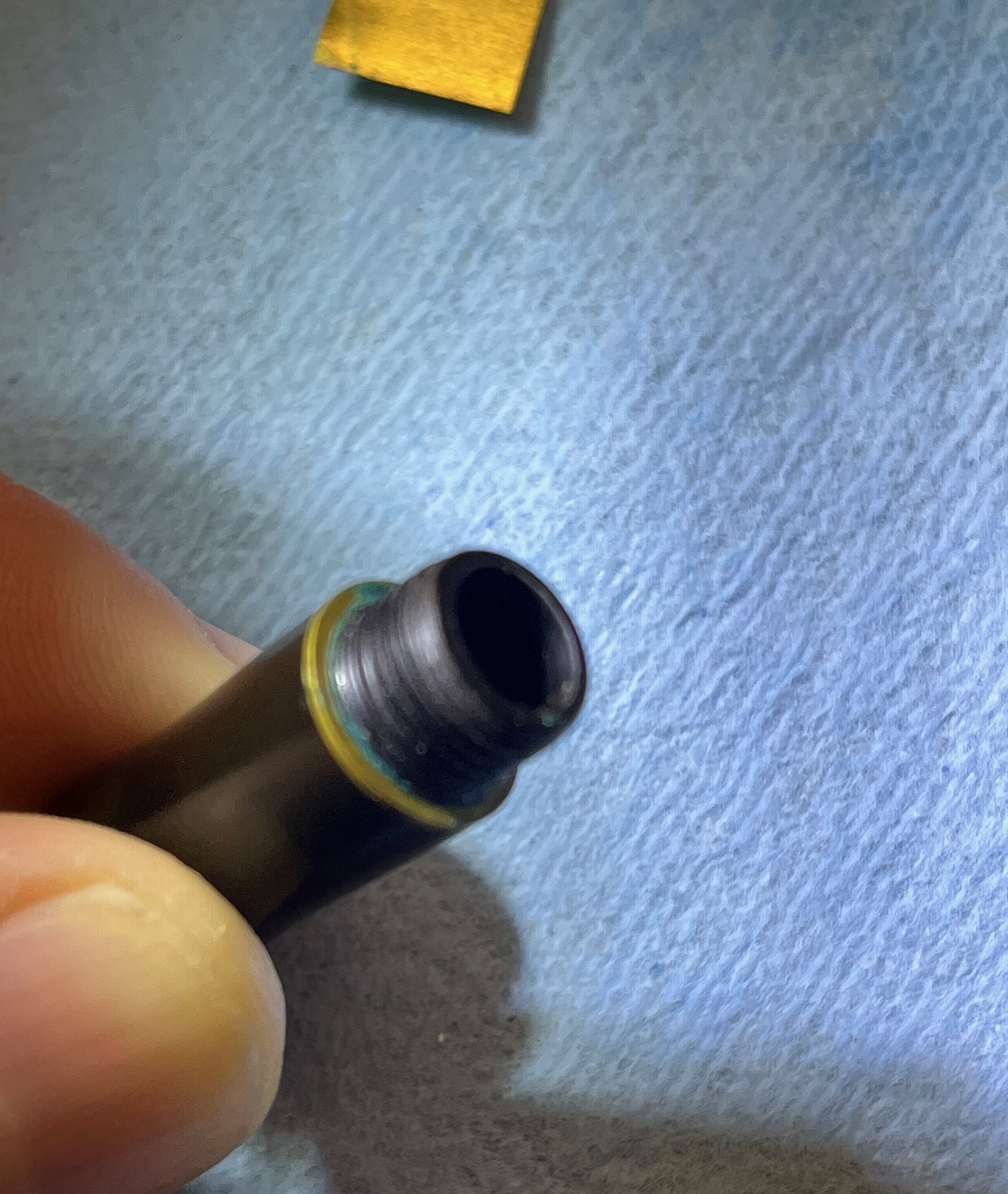

I happen to have one of my untreated brass ring pens in for a cleaning/polish/nib upgrade that I sold just over a year ago. This will give you an indication of what is happening to the brass after about a year of normal use. Blurry, but you can see the discoloration of the brass where it meets the threads. It bothers me to open one of my pens and see this. I hate posting it here, but you learn from your mistakes. I am making the guy a new section with a gold plated ring to go with his new 14k nib.
