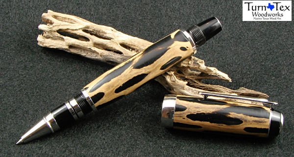

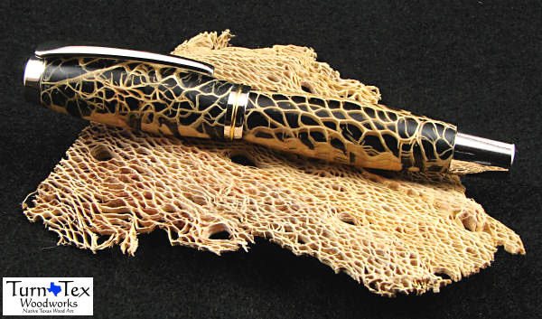

Prickly Pear Cactus skeleton*
Image Insert:
Cholla Cactus Skeleton
Image Insert:

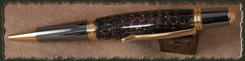

Gar Fish skin*

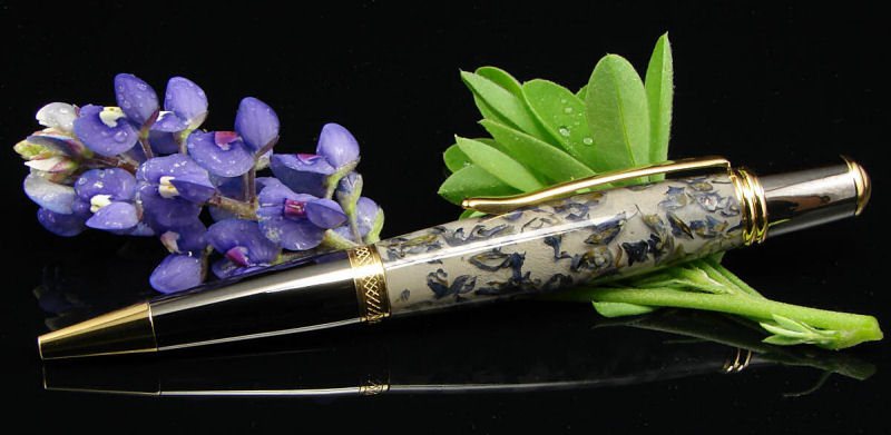

Texas Bluebonnets (flowers)*

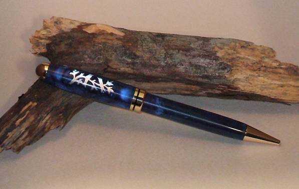

Worthless Wood*

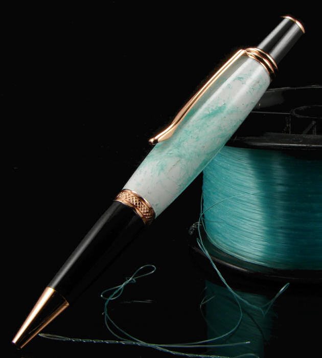

Fishing line*

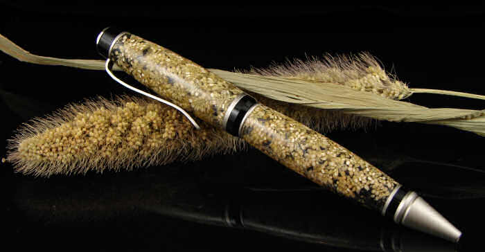

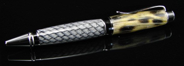

Millet Seed*
Image Insert:

*The ones with * are original creations as far as I know.

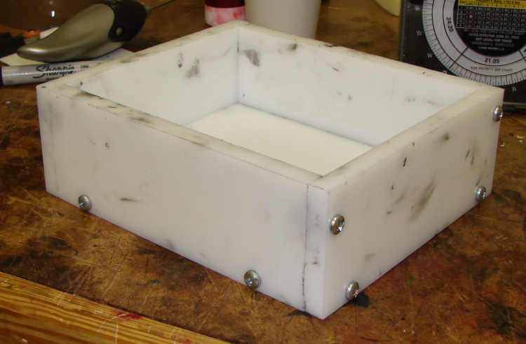

As for systems...I use Alumilite urethane resins exclusively. Alumilite is more user friendly than PR with no drops to count and virtually no smell. It is not considered hazardous material when it comes to shipping either. It is more expensive, however. I use molds that I make from white plastic cutting boards such as this one:
Image Insert:
And I use a pressure pot from HF. I only use pressure, no vacuum.

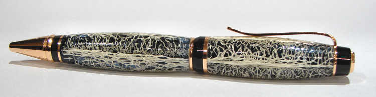

A few label pens. Most unique is this one:
Copper scrubber.
I use a HF pressure/vacuum setup and PR. Will switch to Alumilite as soon as I'm out of PR.

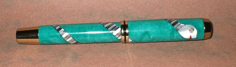

Mother of pearl around tube and cast around. Not a real snake like Don's but just as scary..
Image Insert:
One of my first casts around MOP..

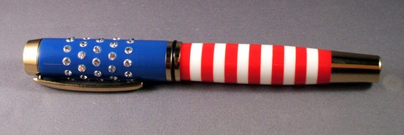

My latest double cast..
Image Insert:
Use mostly Castin Craft PR, occasionally epoxy, ultrasonics and pressure when clear, ultrasonics or nothing when pigmented.
