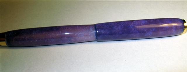

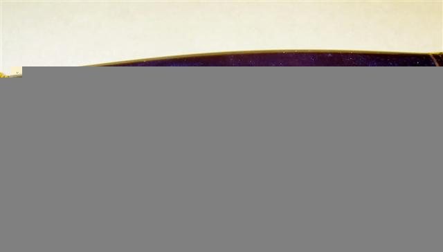

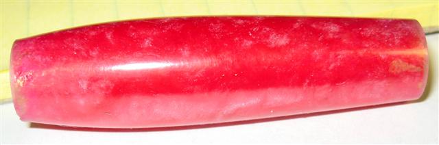

There are very dull looking places inside the castings..places where it looks as if the color is faded.There are place that look as though there is no color at all, as if the pigments wern't mixed well, but this only seem to happen on the ends of the
blanks so Im inclined to think it may have something to do with my barrel trimmer.
I am using silmar41 resin with 3 drops catalyst per ouces. coloring with pearl-x powdered pigments..I colored the tubes with a sharpie but that appearantly didnt work or I didnt let it cure long enough as I can see the brass tubes through the clear spots.
The blanks are solid and have no visible air bubbles.
I degass the resin first for 10 min under vaccum, then mix in the pigments then the catalyst and put under pressue (30lbs) for about 2 hrs..then let sit over night and band saw into blanks
Help!!

I am by no means an expert. But it appears as though the tube has lost adhesion to the blank. Because the blanks are fairly transparent, it shows more.
I could be (probably am) wrong. But thats my opinion.
Someone else will chime in soon.
gketell
Local Chapter Leader
Dec 15, 2006
2,772
Pleasanton, CA, USA.
That would be my guess too. Gaps in the glue. Especially if you only colored the tube and not the inside of the blank before gluing the tube in.

Harold,I'm not an expert either,but I use pearl-ex
powdered pigments in 95% of my casting
(check my IAP photo album,"my pr" folder).
I think the others are right about what you are
seeing;gaps in good firm glue contact.But,are you gluing
these any different than any other blank you have before?
If not,the "gaps" have probably always been there from
time to time.The blanks naturally are thinnest at the end
of the blank,so I would say this is why it appears worse there.
Ok,here is where I'm going;My first few casts had
this same look.Boy,was I sick after all that work.
My solution was to add more colorant,since I do not
care for painting the inside of the blank.
I have 2 "cook-books" of my cast details,it's been a while
but I can give you a measured amount of pearl-ex to help
get you to opaque,if interested.
Nice colors,on a positive note![:D]
splinter99
Dec 31, 2005
924
Bunola, PA, USA.
John
I would appreceiate any recipes you could share..I really like the purple so Im going to try to paint the tube to use the remaining ones I have left..also, I used medium ca instead of thick and that may have left gaps in the glue bond..I have some epoxyI can use until I get some thick ca

Ok..Tried it again but this time painted the inside of the blank and the tube..didnt have any pirple paint but had some satin nickle paint and some of the purple gel food coloring that I dyed alot of blanks with.Mixed up my own purple paint and it came out the same color as the blank. My clear epoxy was all dried up (3 brand new packages) so I still used med. ca. but I dyed that with the pigment I used in the blank.Turned this one and it came out fine..Thanks for all the help
