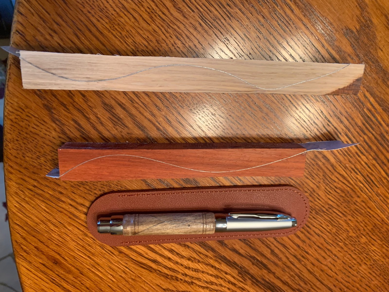

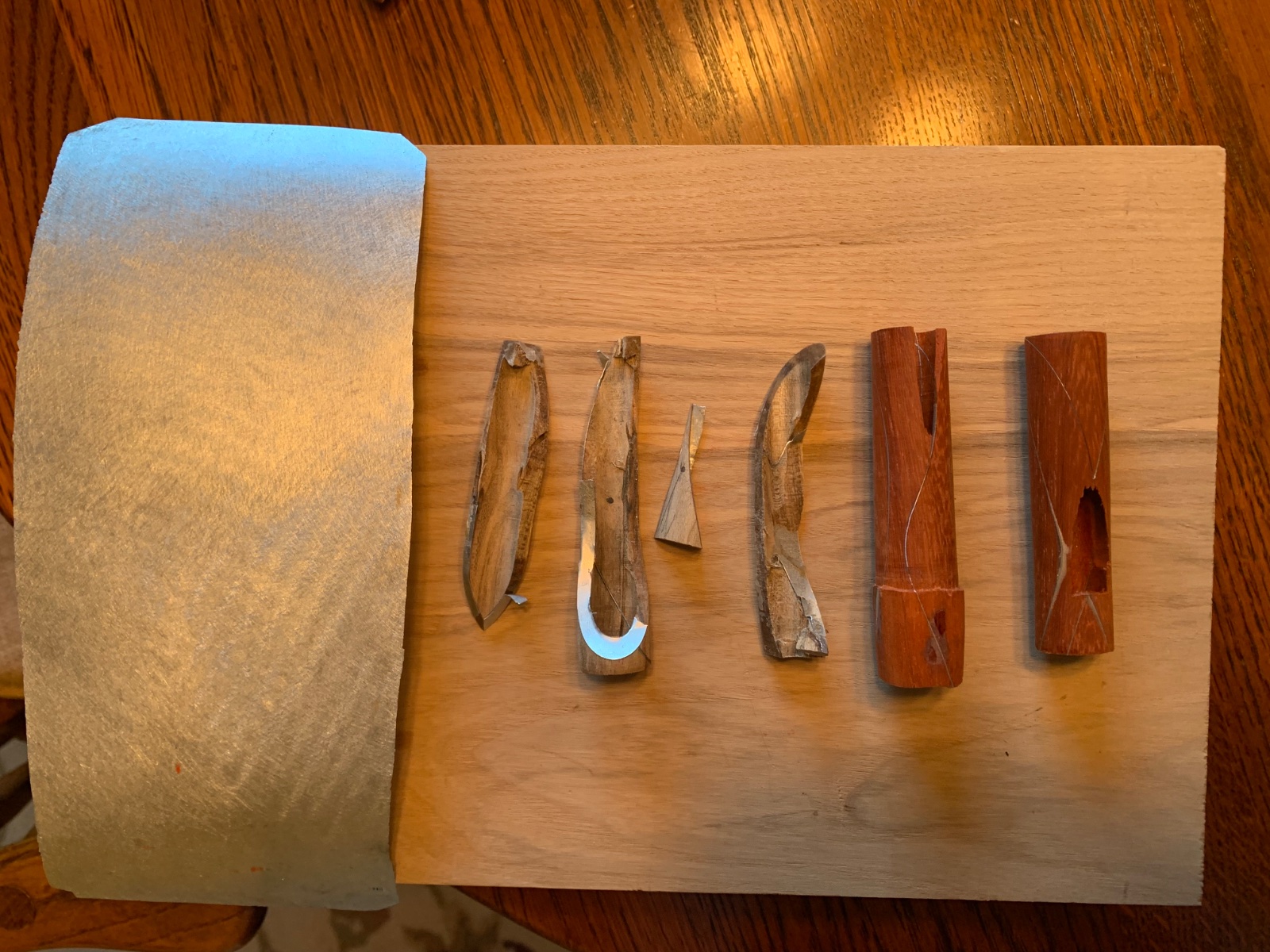

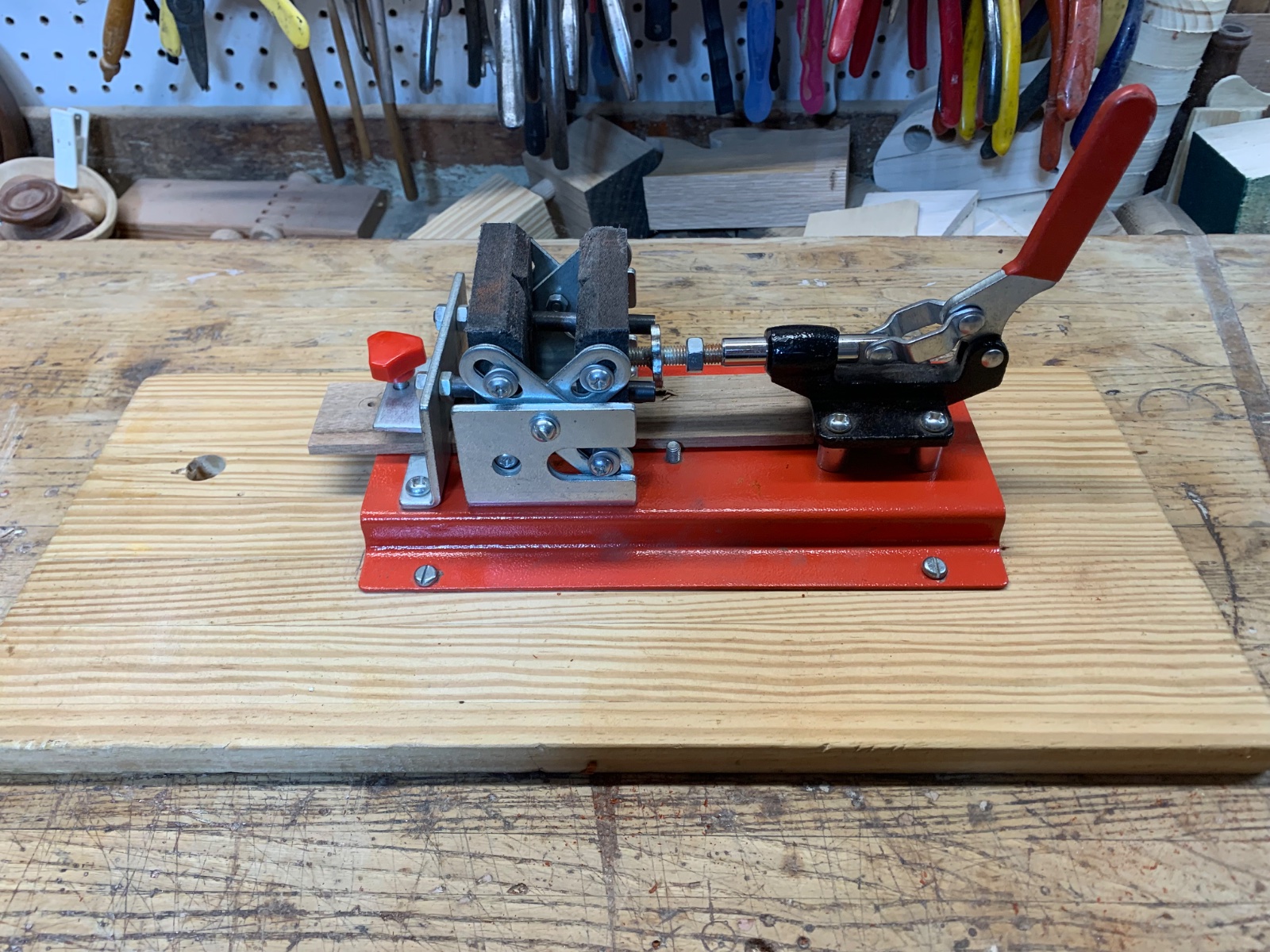

I'm just a hobbyist and have had fun "lacing" my blanks with veneers or aluminum (beer can) over the year. I just laced a couple pieces of Padauk and spalted maple with aluminum and they have blown apart. I'm using Epoxy instead of CA glue but am having trouble with blowouts. I'm using Brad-point and standard bits. Again I've had some success in the past. One thing I'm wondering about is the PennState drilling jig I'm using because most recently the holes I'm drilling don't seem to be going straight through the blank. Any suggestions?

Your experiencing two different issues in my mind - drilling and blowouts.
Drilling - my only suggestion is to abandon the PSI drill jig and drill on the lathe, preferably with a collet chuck. Also be sure to check the alignment on your lathe before drilling on it - your tailstock and headstock need to be perfectly aligned. You should get better straight through drills. I know lots of folks have preferences for types of drill bits, but I personally don't see much difference as long as they are sharp. Also always use a starter bit to get things centered and on track, then drill for size.
As for the blowouts, I don't do aluminum lacing, but most blowouts I get are due to catches of some sort, usually caused by me pressing to hard or a not quite sharp tool. Increase your lathe speed and reduce the pressure on the cuts.

If you're using the drilling vise, make sure to clamp it in place and lock down the table so there's no movement during drilling. If you use the lathe, make sure to let the bit find center on the blank before locking the tail stock so it drills straight. As stated above, drill slower and make sure you're using sharp bits. Be sure to clear the hole as you go, removing the cuttings. Don't force the bit or let the drilling build up too much heat. Heat will soften the epoxy. Also, make sure you have plenty of epoxy on those glue joints. I always liked to have extra squeeze out so I know I have enough. Lastly, try wrapping the blank with some tape or is square, glue extra scrap wood around the outer sides to support the blank while drilling.

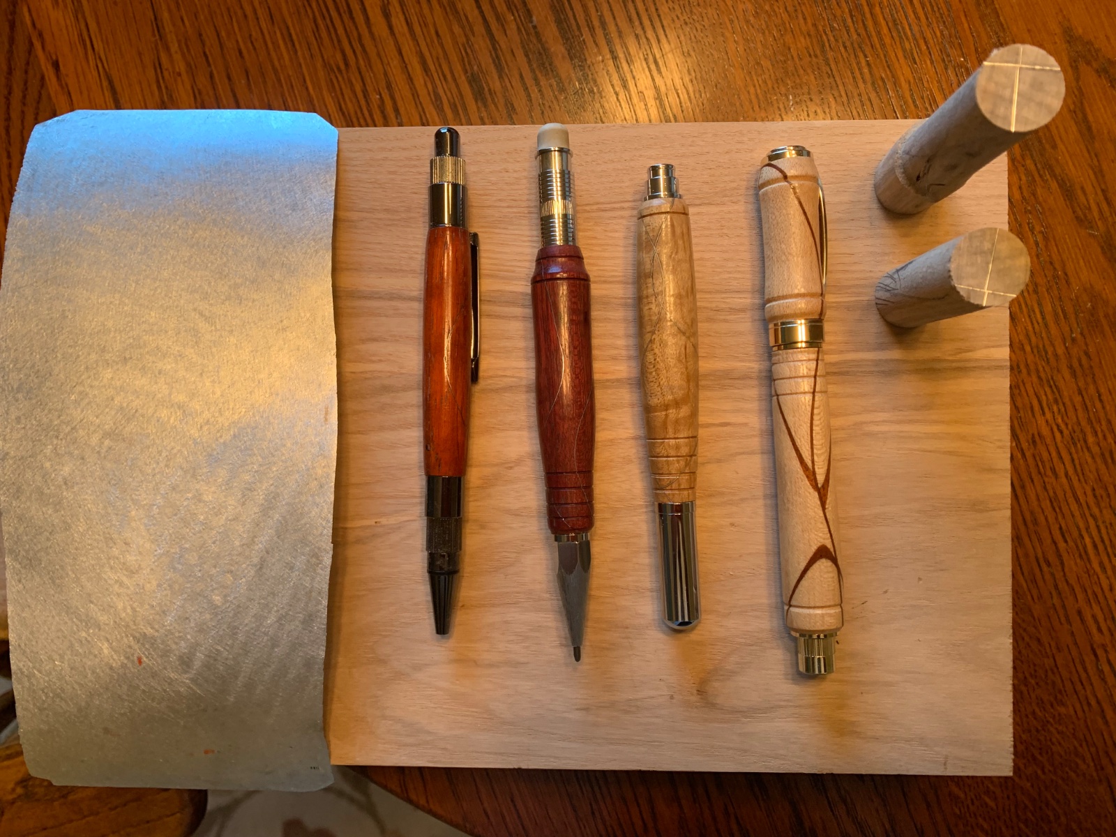

Thanks for the suggestions, l salvaged enough of my original blanks to turn a Presimo pen with the spalted maple and aluminum. It took a 10MM bit but this time I drilled a starter before the 10MM as suggested by NJturner. I also used a homemade jig to get the hole straight. (I'm not familiar with a collet chuck). To see if I learned anything I've glued up a couple more blanks. One with Padauk and one with Bourbon Barrel Oak and Beer can aluminum (I call it my Shot and a Beer Pen). I'm going to try to turn the Magnetic Graduate or Vertex Supreme, I like the magnetic "click". We'll see if I've learned anything.

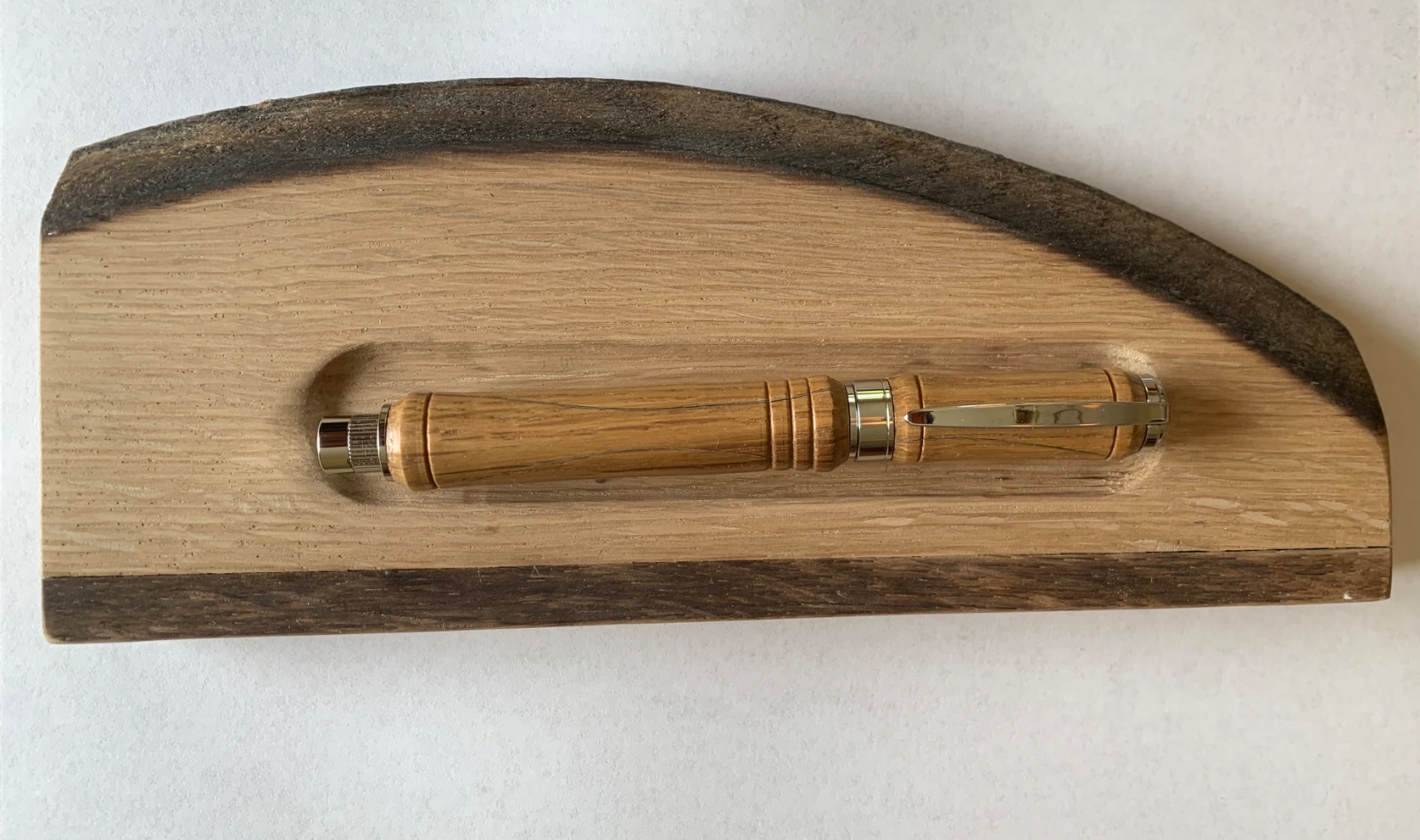

Following the advice of the many contributors, (Thanks!) I was finally able to drill a 10.5mm and 12.5mm in the blanks I made from Bourbon Barrel Oak and Beer Can Aluminum. The Magnetic Graduate pen turned out nice and I made a desk set out of the same Bourbon Barrel. It's for a friend that prides himself on being a Kentucky Bourbon Connoisseur. Maybe he will share…
