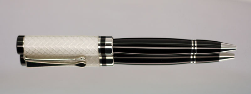

A while back I saw a pen that the artist said was made from a tube he bought from Home Depot. Sort of a poor-man's carbon fiber pen blank. Something like this.
I thought I had seen that article on this site, but I could be mistaken.
If anyone has any experience with this I would be grateful for some guidance.
What diameter tube works best? What is the best way to cut a tube like this without fraying the ends? When casting the tube in resin, how do you ensure the tube stays straight (even the ones in the store that are straight still have a slight curve)? Do you allow the tube to fill with resin and drill it out afterward, or plug the ends to keep the resin out?

Chris, this is where that was brought up but I have forgotten just who did it. I would wrap a few layers of electrical tape around the area of the cut and then cut in the center of the tape. That is how we do ground wire to keep it from fuzzing out badly. My guess would be to insert the tube for the pen, pull the web taught against the tube and glue it there with CA. that stuff will shrink a bunch when it is pulled. think Chinese hand cuffs. I would plug the tube before casting and prevent any PR from entering the tube. That stuff would be a real bear to clean out of the tube. These re my best guess. The originator should be on before long to set me straight.

Others have done these but here is my version. I do get the flexible water hoses from Lowes. The great thing about using that material is it has a protective coating on it that gives it a really shiny effect when cast. I use Silmar41. I cut both ends of the hose off. I then pull the innner hose out and maybe you can make a pen from this. I have not tried it yet. But the braiding will not unwind as long as you do not over work it. One size fits all because it expands. I cut my lengths to size using a pair of tin snips. I again use the tin snips to trim the ends after the material is glued to the tube and left to dry. I leave about a 1/16" on each end when I cast and the hardest part of using this material is trimming the ends after it is cast. If you do a good job gluing the material to the tubes near the ends you then can trim them flush before casting. I do it later using a carbide trimmer. I have also used a grinder to trim the ends which works well too. Hope this helps and here is a brass Sierra and a Jr Gent stainless. One other thing that is important is to use a kit that has some meat to it because you can not turn the ends too thin.
